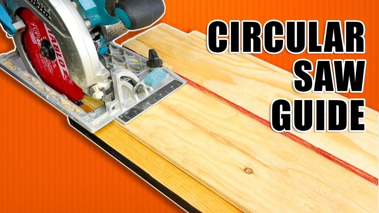

make a circular saw guide like the following… I added a patches of 220 grit sandpaper on the bottom of mine to keep it from sliding without having to use clamps.
