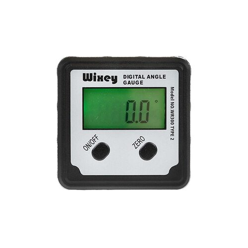

Likely the easiest thing to do is to use a quality level and get your spoilboard physically level. Then put your level on the Y rail and if necessary adjust it to be level. If the two surfaces are not parallel you will never get anything flat. If you spoilboard is NOT level after getting it level and/or the rail you will likely need to tram the spoilboard again. One other possibility is your spoilboard is not level but is parallel with the Y rail. In that case leave things alone. Wixey makes some little angle blocks that will give you both absolute level and relative level. A long level would certainly tell you if things are level but not tell you the exact angle like the Wixey.

I used a 4’ and a 2’ bubble level. Also used a Huepar digital angle gauge very similar to the one you showed.
The biggest error found with angle gauge was 0.07 degrees.
