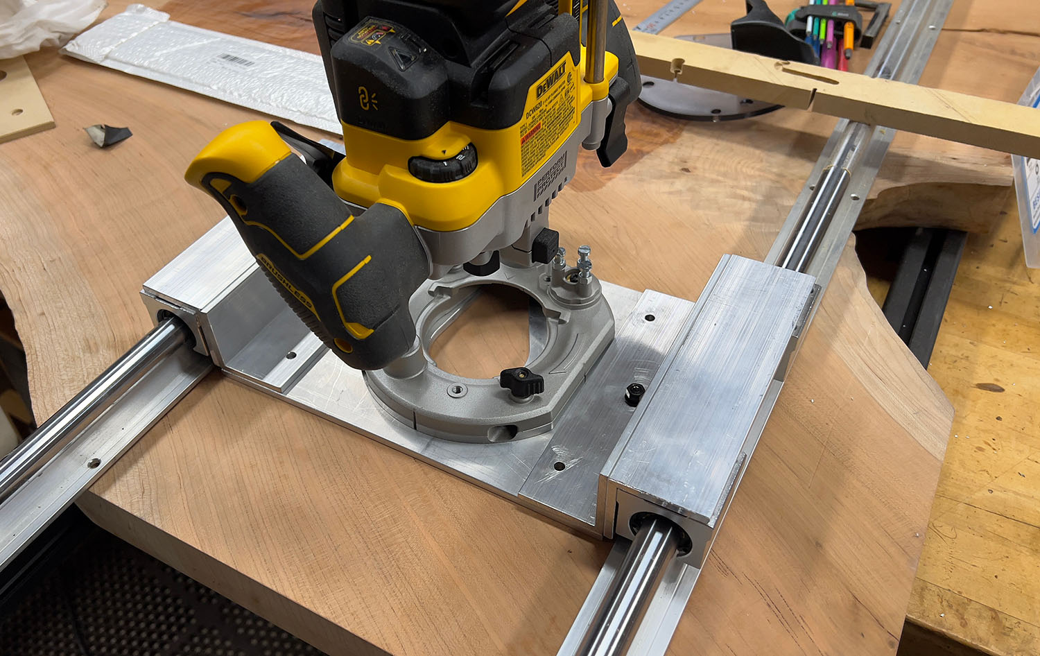

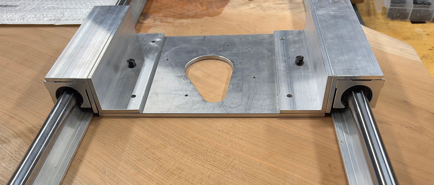

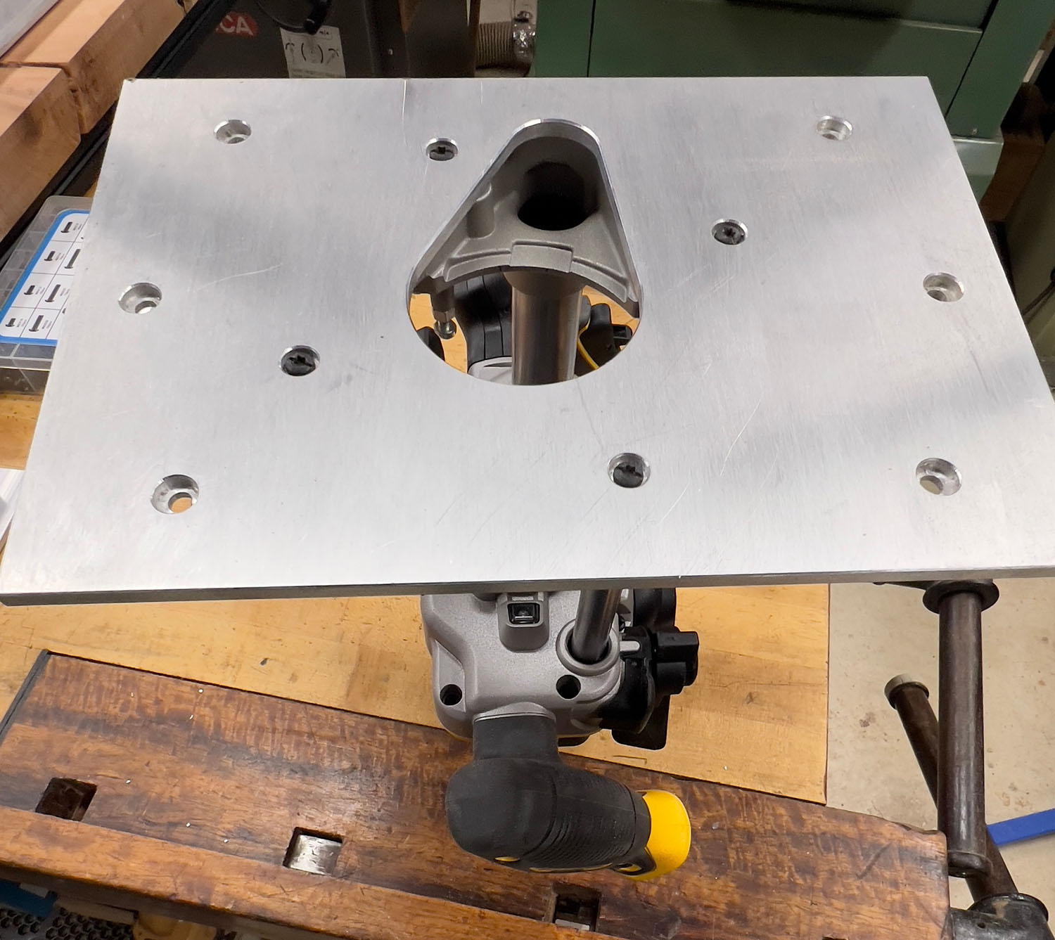

So, I successfully milled the router base plate today:
It’s for a wood slab flattening jig I’m building. Here’s the carriage in progress now:
And with the router installed:
This router has built-in dust collection up through one of the plunge posts, which is why it has that tear-drop opening.
Anyway, it took a little over an hour. To keep myself busy I applied Lubri-Cut Cutting Paste after the router swung by. So, not a misting lubricant that gets everywhere, but easy enough to keep applying as the cutting is pretty slow (36in/min). I did re-run the boring toolpath a second time with a lower Z-zero to have the holes milled all the way through - the rest had what is similar to an aluminum foil left that was easy to trim off. I did use Sweepy and my Makita vac and hardly had any chips on the spoilboard - very clean operation, although cleaning Sweepy afterwards wasn’t fun.
The router never sounded like it was in trouble. Some of the lead-ins were a bit louder, but at this small DOC there wasn’t anything to worry about. Now my questions still are how much harder I could have pushed things, and whether the lubricant was needed, etc…
As a side note, I couldn’t find any aftermarket or Etsy baseplates for this DeWalt DCW620 cordless router that had the teardrop opening for dust collection. Now that I’ve got the design (and I nailed the dimensions, the M4 screws line up perfectly), I could maybe create some baseplates for things like a third handle (helps balance when milling edges), or connecting to a saw track, etc., but at an hour of milling for aluminum, I’d have to charge more than anyone would pay. Maybe phenolic…
Anyway, thanks for all the help, folks!

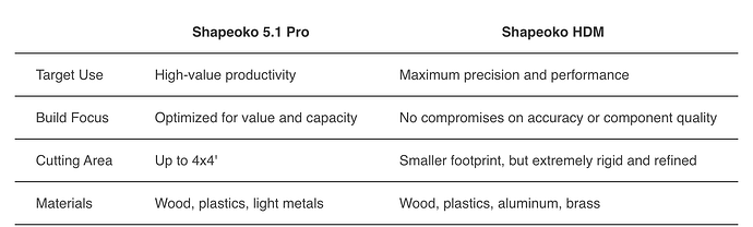

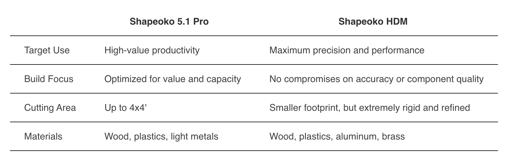

And while the 5.1 is listed as being able to cut aluminum (actually, so is the Pro4), the chart on the HDM doesn’t list aluminum on the comparison for the 5.1:
So, there’s a lot of wiggle words in the C3D room. Am while I’m a satisfied customer, I remain confused as to what my upgrade path should be:
