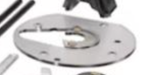

I’ve got a ¼" thick sheet of 6061 Aluminum that I’m using to support a DeWalt 620 router on a shop-made slab flattening sled. This router has a unique built-in dust collection (up through the plunge rod), which requires a egg-shape opening in the base. This is the best picture I could find on the web:

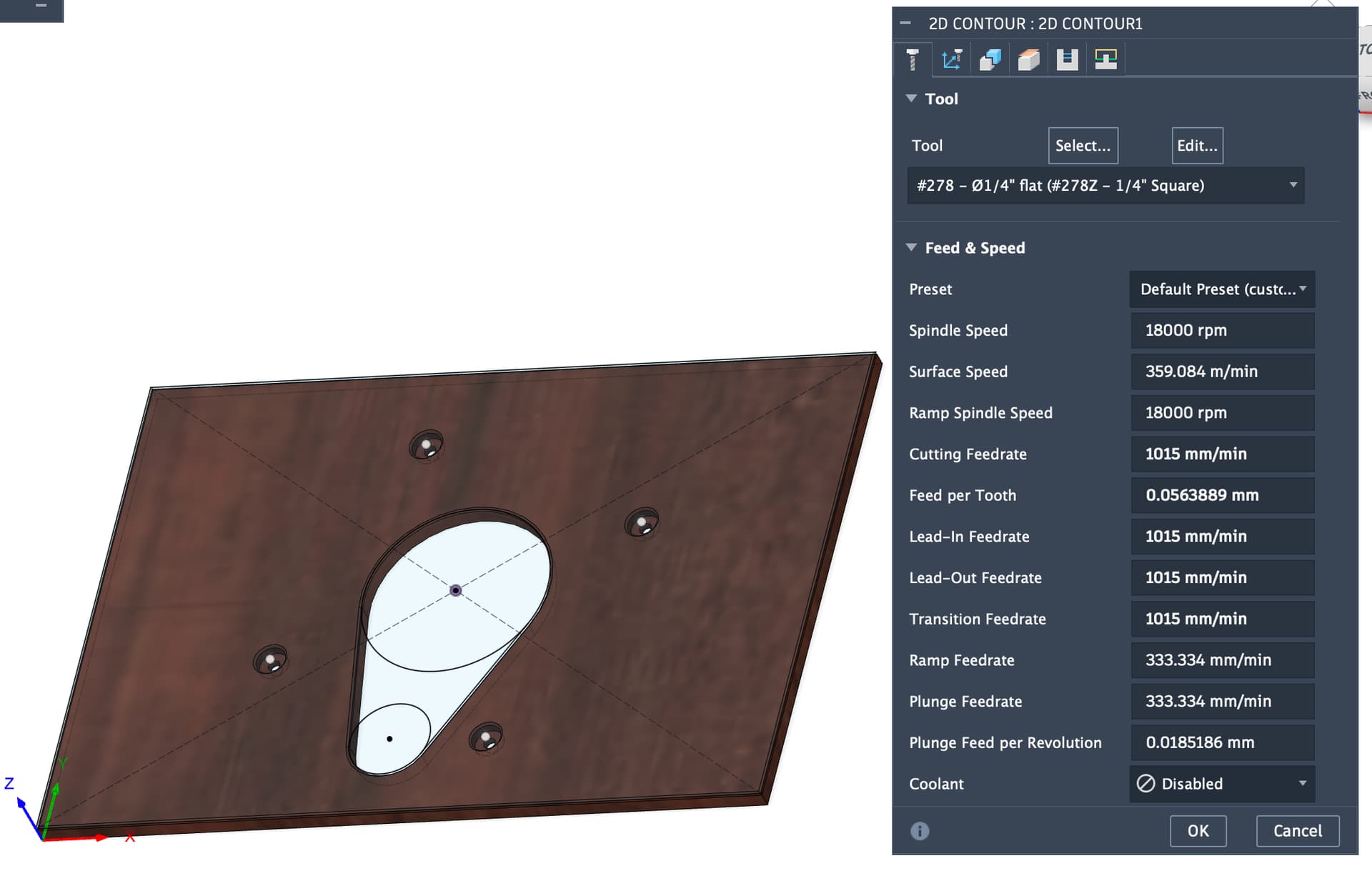

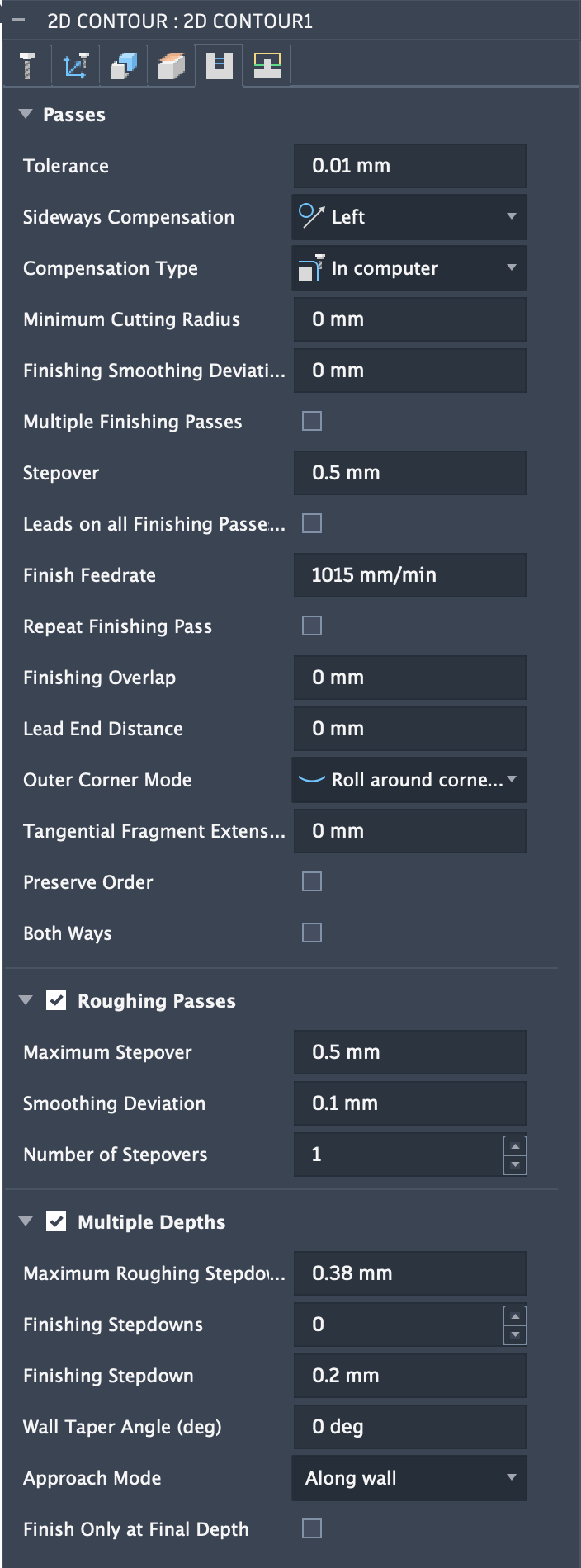

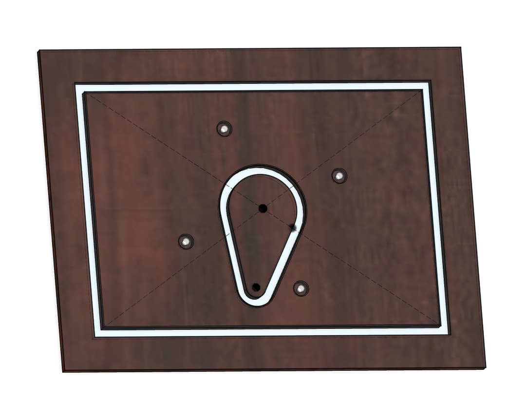

OK, here’s the base plate design, which I will eventually cut out of a ¼" thick aluminum sheet:
The plate is 18cm by 26cm.
You can see my setup there and here:

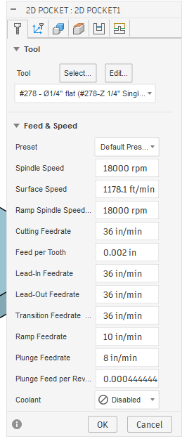

Does that look about right? I took the speeds and feeds from @wmoy’s old video on cutting aluminum on the Pro (which is what I have), using the 278-Z cutter. I’ll bore the holes with the 274-Z.
It’s s 40 minute machining time, including cutting the outside as well as the center hole. Seems like a lot, but DOC / Stepdown is only 0.38mm, right?
Here’s the Fusion file:
RouterSledBasePlate.f3d.zip (254.0 KB)
Thanks for any advice.

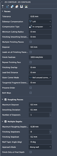

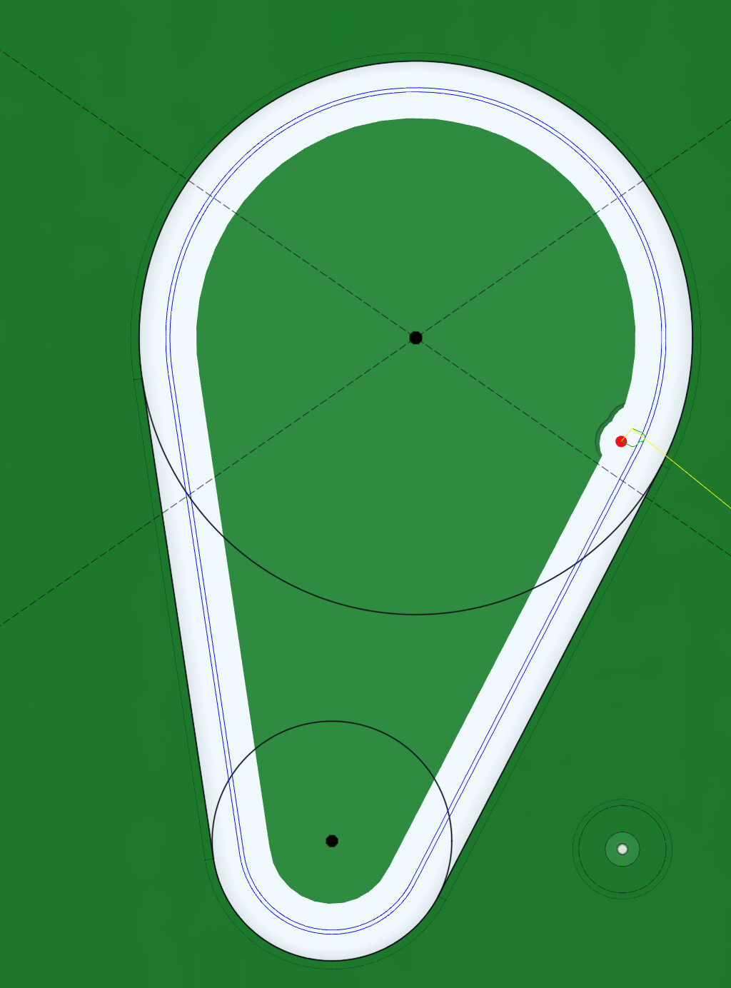

not in position to load fusion file right this minute but check that the contour op is at least two passes so you’re not pure slotting. i.e. the inner contour slot ends up wider than the cutter to help with chip clearing.
OK, zooming in, it does look like there are two paths (in blue):
I would use a Pocket instead of the Contour, then you are not slotting the whole perimeter constantly. I add at least .020 offset to the profile.
Two questions on the Pocket option:
  1. Doesn’t that mean I’m doing a lot more cutting by clearing out the whole center instead of just the outline?
  2. If Pocket, then shouldn’t I use a 2D or 3D Adaptive instead?

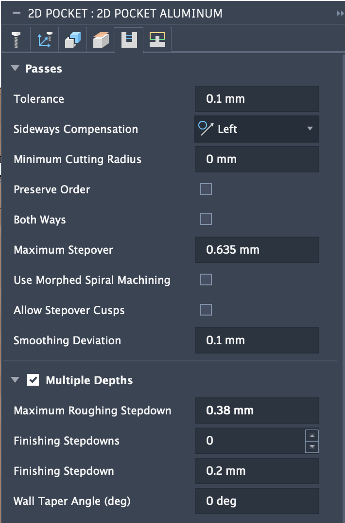

My recipe notes from Winston’s aluminum cutting video (link there) for the 278-Z cutter are as follows:
2D Pocket:
RPM: 18k
Feed: 1015 mm/min
DOC: 0.38mm
StepOver: 1.59mm
2D Contour:
Same as above, but can do 1015mm/min on roughing passes (if enabled)
Adaptive: (not sure if this is 2D or 3D)
RPM: 18k
Feed: 914mm/min
DOC: 1.5mm
StepOver: 0.5mm
First pass: Stock to leave: 0.26mm
Second pass: (which I assume is another toolpath in F360) Stock to leave: 0.0mm
I’m thinking the trade-off is:
  1. Cutting out the middle means less cutting distance/time, but full engagement for one pass
  2. Clearing out the middle is cutting a lot more material, but can be done with less cutting tool engagement.
I don’t know how to evaluate these.
@Smorgasbord
I believe jtclose means to use a pocket tool path to cut the existing contour tool paths that actually removes the center section. Not to pocket cut the entire opening out of your base plate.
I go by listening to the cutting sound. You know when you are slotting ( cutting on both sides of the bit ). I was trying to save some wear and tear on the bit. The finish is good.
A .020 inch offset in a Pocket will cut in using one stepover move ( two passed per DOC ). So you are not cutting the “middle” at least with these numbers.
I did not use Stock to Leave.
2D Pocket - Keep it simple

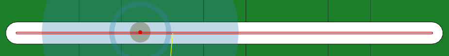

My example is cutting a 0.270 slot in with the 1/4 #278 bit.

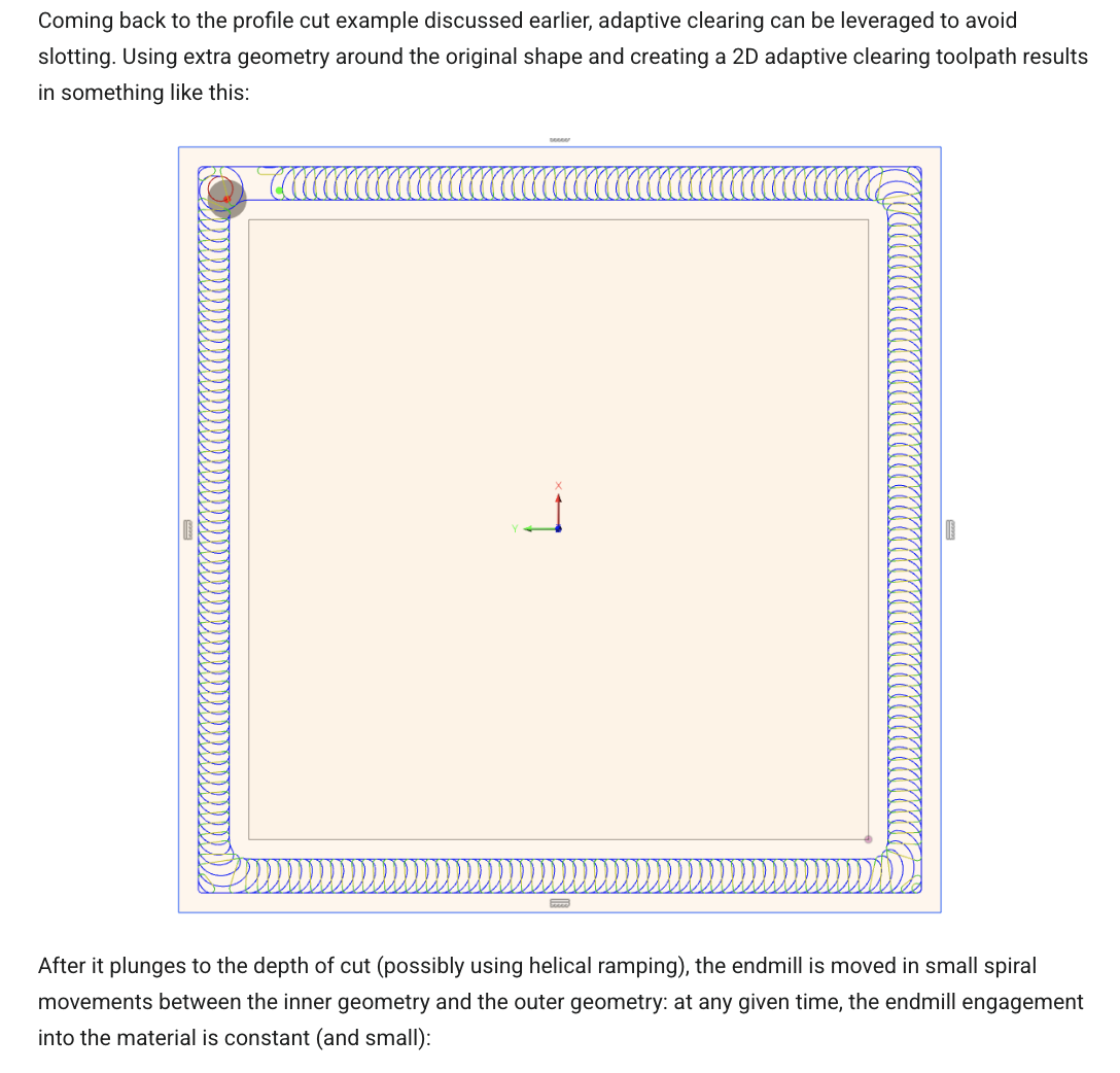

My understanding in F360 (which is minimal) is that to get a Pocket toolpath to cut a slot, I need to modify my design to create a “middle piece” that the pocket won’t cut. In other words, the “pocket” is actually a slot that cuts out the middle piece. Which is what I was doing with the Contour toolpath.
How are these different? What’s the magic with the Pocket toolpath on a modified design versus the Contour? Or, could I even use the 2D Adaptive on that “slot?”
This is discussed at:
Here’s the section:
Although in that one they’re creating material outside of the piece they want to force adaptive to cut a slot. I could do that around the outside rectangle of my job as well as inside. In F360, that’s pretty easily done with an Offset.
Am I on the right track?
Here’s the modified design:
There are now 3 pieces - the outside one won’t really exist and the inside one will be saved for another project. I made these slots 0.27" wide to get the 0.02" offset with the ¼" 278-Z bit.
Now to cut these with adaptive or pocket? Or, am I off-base?

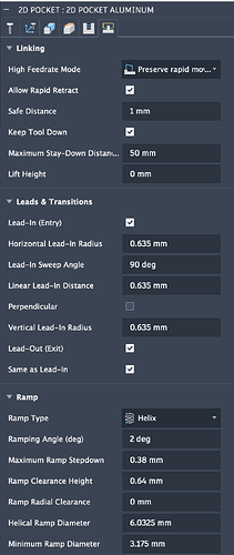

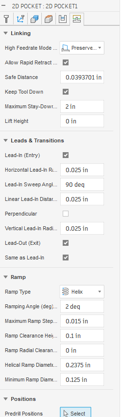

And I forgot a very important Linking page. Sorry.
I use Ramping to enter the material. This is so the bit doesn’t plunge into the material.
The Ramp angle is the default ( I don’t know any better ).
This seems to make the path run forever but it is successful. Someone else would need to chime in on what you could do…
I did modify a few of the other parameters based on a SWAG, mainly the Max stepdown.
I used Adaptive 3D when I first started because it seemed to do everything.
I understand that Adaptive optimizes for tool engagement ( wear ). Since I felt I was within the CC recommended parameters, I go simple.
I found the surface finish to be not to good. It makes a lot of moves that seem weird.
So I migrated to other paths that I could control direction and a better finish based on the topology.
EDIT: The Ramp Clearance height of 0.1 is too much. I watched it run wondering what the h.ll is it doing. I will change it 0.025 ( another SWAG ) to take some time out of it, the material is faced, no bumps to worry about.
Thanks for the memory jog !!!
OK, I made a version for cutting out of some ¼" plywood scraps - changed bit type, feeds and speeds of course.
If that looks good, then I’ll try the aluminum.
Does 49 minutes seem too long for cutting out a 18cm x 26cm rectange and also that center oblong hole? In 6mm thick stock with the 278-Z bit.
Painfully no. I would expect that. This is the downside of cutting dry.

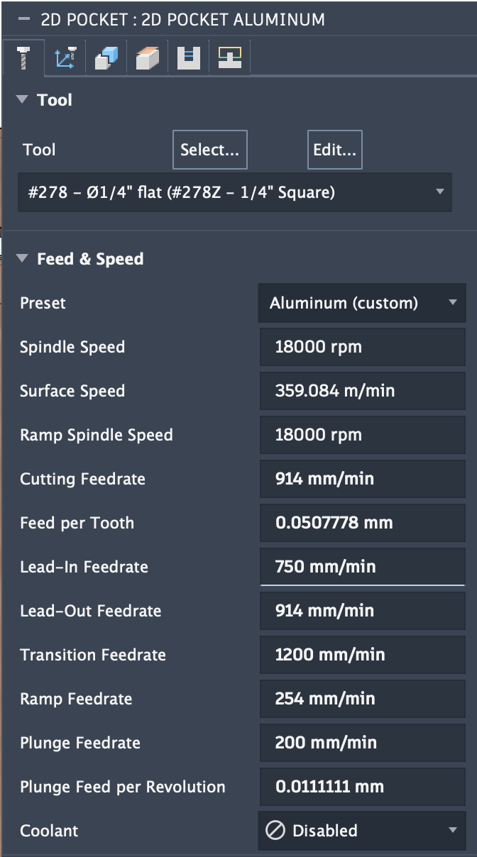

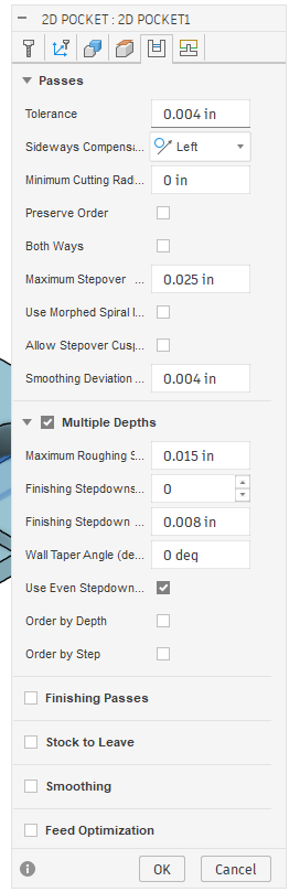

Here are my cutting parameters for the Pocket path being used to cut out the parts - please let me know if anything looks amiss:
I’m going to assume that for drilling holes and chamfering edges my paths are fine since those are less heavy loads.
TIA
