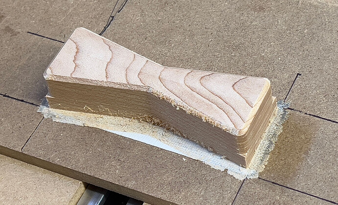

Here’s one with the previous gummy tape:
