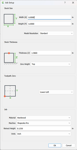

The piece was attached to the surface with tape/superglue and blocked on 2 sides, so it didn’t move. Initialized at the beginning of this job, and zero’ed. Stock is 1.98" thick.

How did you set zero?
Did you try verifying where zero was set using the Z+6mm Rapid Position?
Your file specifies Top:
Were there any tool changes? How were they handled?
Zero’ed to the top of the lower left corner, using the 1/8" bit that was used for the first tool path (so no tool change between zeroing and the first plunge). Always set the tool above the lower left corner, then Z down until a piece of paper between the bit and the stock just starts to snag. Then click “zero all.” Then run the job.
