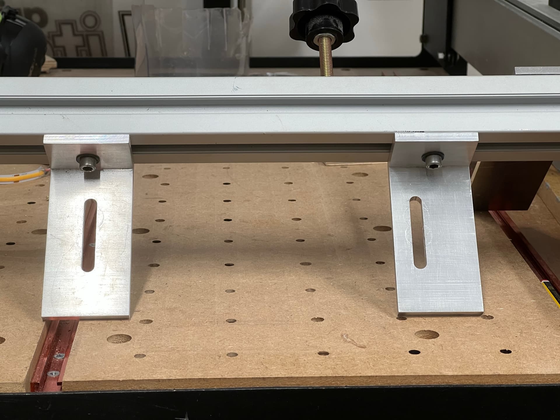

Not sure if you meant my attempt, anyway, in case you did, here’s some stuff that’s good and bad about it and what I’ve learned so far…
I decided to assume my spoilboard was flat and well aligned with the X,Y so I could just use that as the ‘reference’ surface. I got some ‘heavy duty’ 4040 with much thicker wall thickness for solidity. I milled up a few aluminium brackets to attach it to the spoilboard at the front of the machine using the T tracks and some of the embedded T nuts. I think I prefer the approach shown in the posts above with the lengths of extrusion running along the bed.
The X-Zero is a 5mm piece of 6061 plate, a couple of Tee nuts in the 4040 to attach it and squared up againt the Z axis using a dial indicator in the collet and jogging up and down in Z. You only have to do this once. I don’t attempt to match this to any known X position on the Shapeoko, I just zero off the extrusion for Y and the X-Zero for X each time I install it.
I align the whole extrusion in Y by running across the front with a dial indicator in the collet. I guess I could use fixturing pins in the spoilboard but it’s so fast to set dial zero at one end then move to the other end and pull the extrusion to zero I haven’t bothered.
I stopped using the second piece of 4040 as a clamp (as in the previous pics above), it turned out that was a bad idea, all it did was bend both pieces of 4040 when clamped down. So instead I now use the M8 Tee bolts to hold individual clamps as below.
The lack of any front face support for the workpiece can be a pain and allow some vibration. I previously tried to align the front of the machine with the front of the torsion box but my torsion box wasn’t square enough for that. I do set the extrusion flush with the front steel plate of the Shapeoko so there’s about 70mm height of flat for the workpiece to align on.
On the upside, I can machine the full front overhang of the SO3 which is nice. The other designs above could do this too by removing the downward facing extrusions so probably still a good design element.
I place the workpiece up against the vertical edge and this gives me a repeatable X, Y = 0, 0 or repeatable enough for wood anyway.
When I have a set of parts to run with the same toolpath I use a fixed height block to set the workpiece to the same Z height so I can just repeat toolpaths.
Things I have learned from a few iterations and mistakes building front vertical clamps
  1. Your vertical cutting fixture needs to be fast and simple to set up and get level and aligned with the X axis, if it’s a PITA to do this you will likely not use it
  2. Keep the workpiece and toolpath up above the top of the metal parts of your clamp
  3. It’s very useful to sandwich your workpiece between some sacrificial scraps for cutting to avoid tear out on the edges, even sandwiched, keep toolpaths above the metal parts to avoid playing toolpath roulette, especially with paths such as adaptive clearing in Fusion
  4. If you’re a Fusion user, it’s worth modelling your vertical clamp the way you would a vice or other workholding
  5. Using two full length pieces of extrusion to ‘clamp’ a wooden workpiece only produces two points of clamping pressure and bends the extrusion if you try to tighten it up to get more clamping, a vertical face with multiple clamping points is likely a better design if you want more clamping force
  6. MDF and Plywood make for weak reference faces compared to Aluminium
  7. If you cheat with a CNC you can make really teeny through tenons with really accurate chamfers :wink:
HTH
