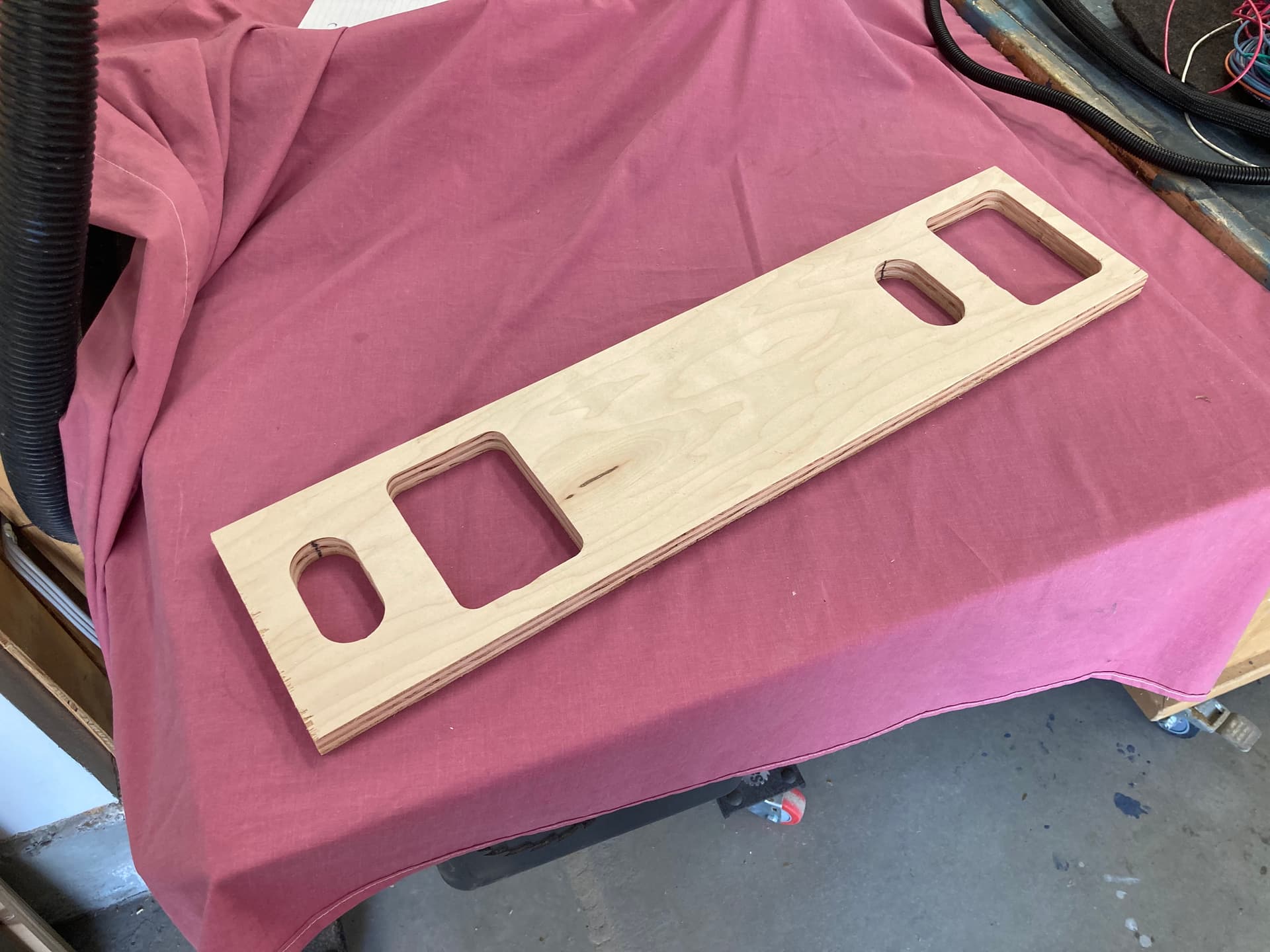

Yoga Wall template

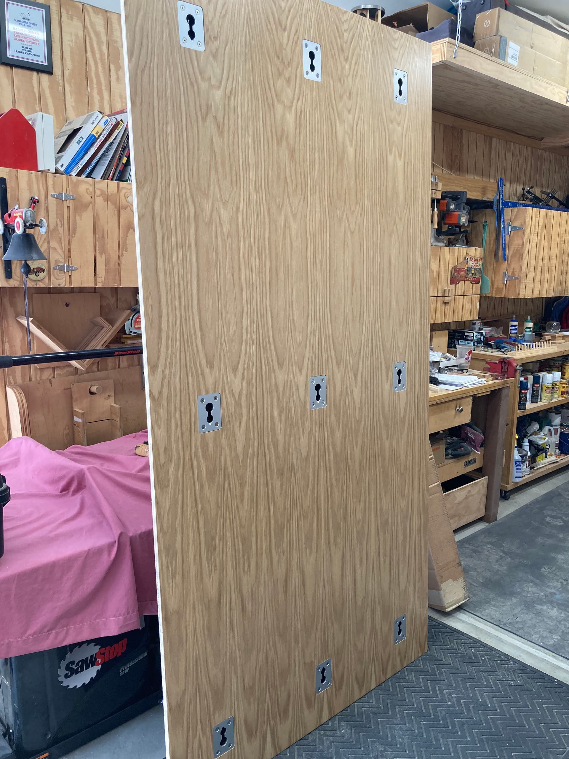

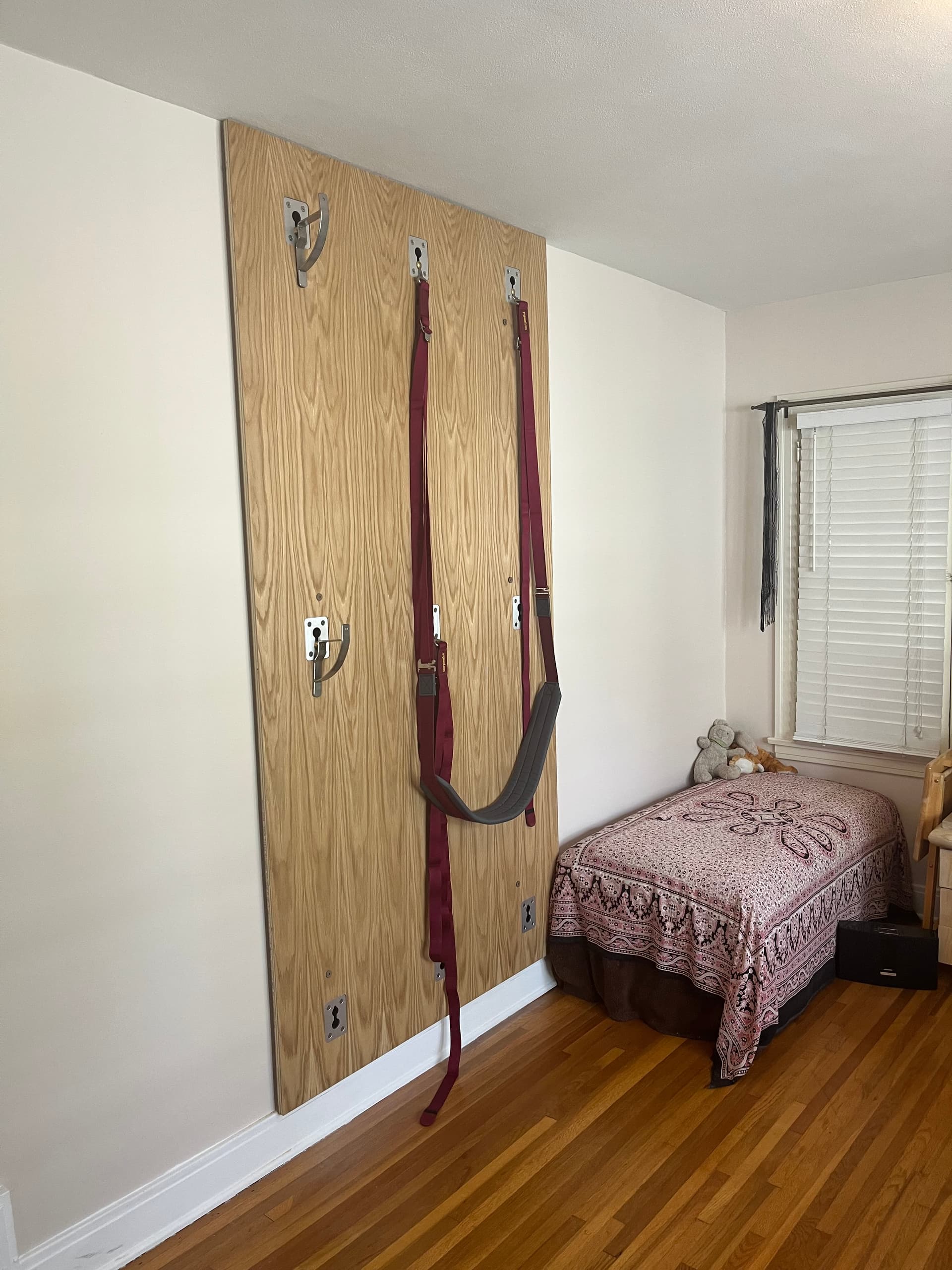

My friend Petra asked if could assemble and install her Yoga Wall. I said yes, provided she could tell me what the heck a yoga wall is.

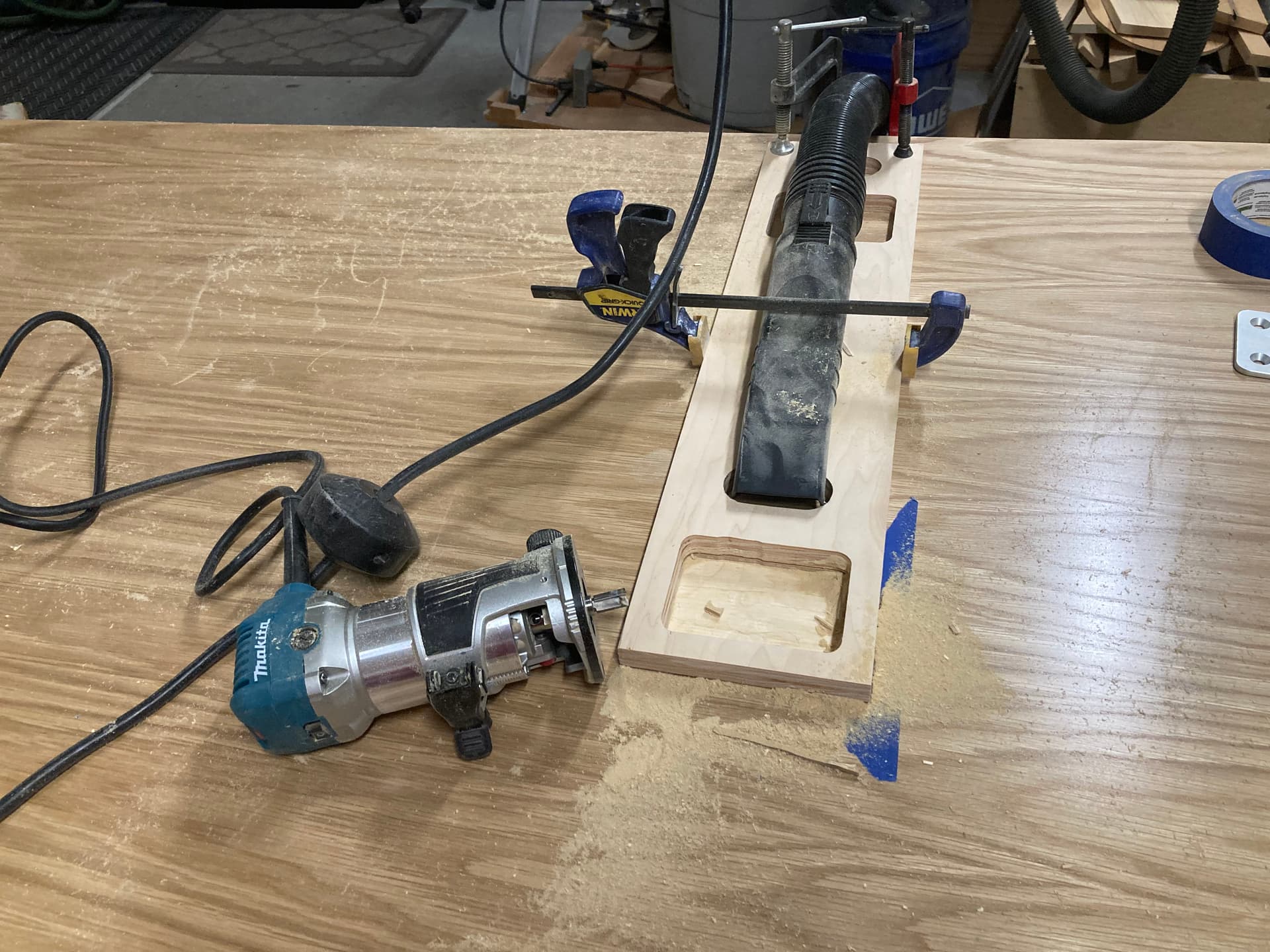

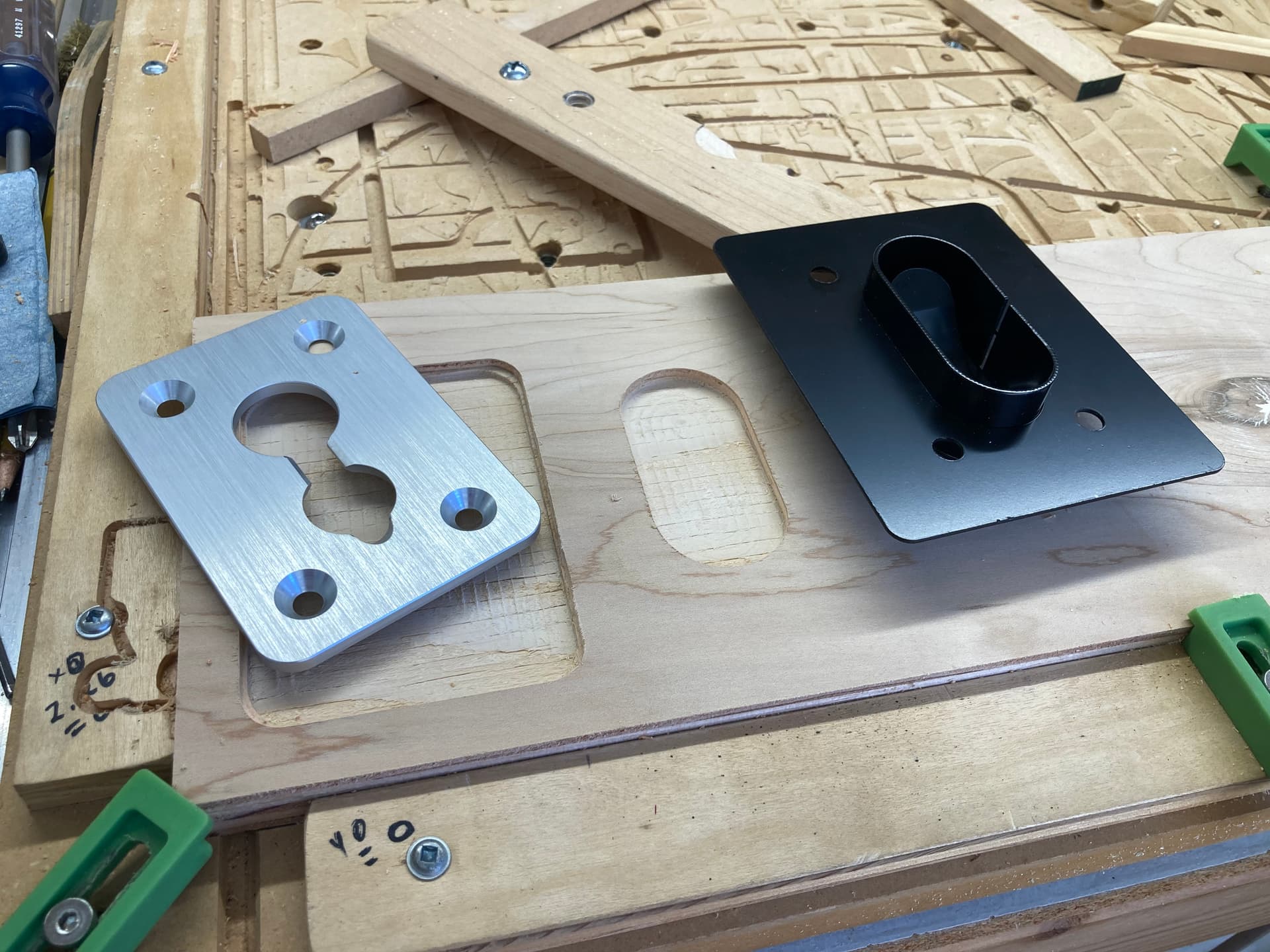

A template is available for about $300 so I made one on the Shapeoko. My machine is not large enough to make three guides, so I made two and referenced off the center position.
Here are a couple of images for the template and a shot of the finished yoga wall. I also made a short video: https://youtu.be/H_90XdM6tgM?si=8qLLE_-FR4118ceT
