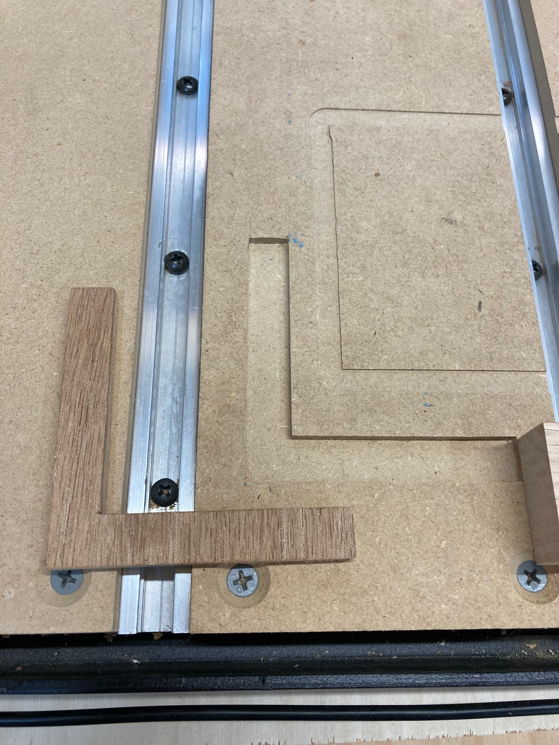

I put a second wasteboard on the machine and then the work piece above that. I was having the same issue and this worked beautifully. The nice thing about this is it keeps your original washboard pristine. However, I do not have t tracks or anything nifty. I usually screw/glue my piece to the spoil board.
I did purposely cut into my waste board 90 degree positioning square so I can load my project in the same place each time I use my CNC.
