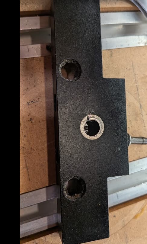

My SP5 will start making noises. The source is the pocket where the Z axis ball screw sits in the X transom. The noise is a lower frequency rubbing sound.
I put some oil on the lower end of the ball screw and the noise goes away.
Simple enough.
There seems to be burnt wood dust on the shelf of the X transom.
Any way to clean that pocket out that the Z axis ball screw fits into ?
See:
https://carbide3d.com/hub/docs/maintenance/
If you are still stuck, send a photo in to support@carbide3d.com
Not really stuck, I just have had to put oil in that location.
I was looking for a way to clean the seat out.
I will send support a picture. Thanks.
As per usual the Support folks ( Brandon Lee ) where right on the issue.
In short the Z motor coupling showed a gap, which made for no gap at the bottom plate.
The culprit was the top nut of the ball screw was loose.
The bottom plate showed a little anodizing wear, no grooves.
Thanks to the Support team !
