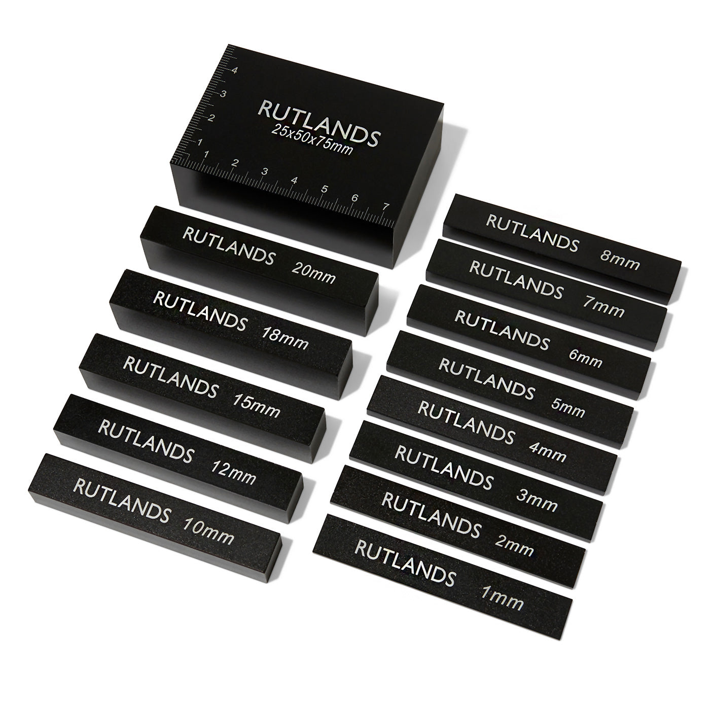

When both aids are used on a project, the unplanned descent of the Z axis through what is usually the whole depth of the workpiece is an event I have experienced on several unhappy occasions. I now do not use either aid but reliably manage with a piece of paper and endmill touch off for a single cutter. I use setup blocks (like those illustrated at the link) to find the top of the stock when I want to use multiple cutters.
