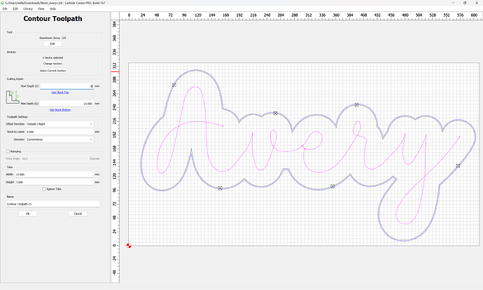

Z axis dropping at beginning of job
I noticed something in the pics that @WillAdams posted. My material thickness was 19.050 but the actual thickness is 19.27. I wonder if the Z was dropping to what CC had the thickness set to because that was the stock top in the settings.

Not a bug, as requested:
The Start Depth is set to 3mm, so you are asking the program to begin the cut 3mm below the stock surface — normally this would only be done if putting a feature at the bottom of a previous operation which had removed 3mm of material.
If you change to 0:
and then output the G-code:
The move is to 0.25mm above the stock surface:

I changed the start depth on a part I’m running now to stock top and it did not scar the surface.
It seems like the problem might have been myself and inexperience :laughing:
