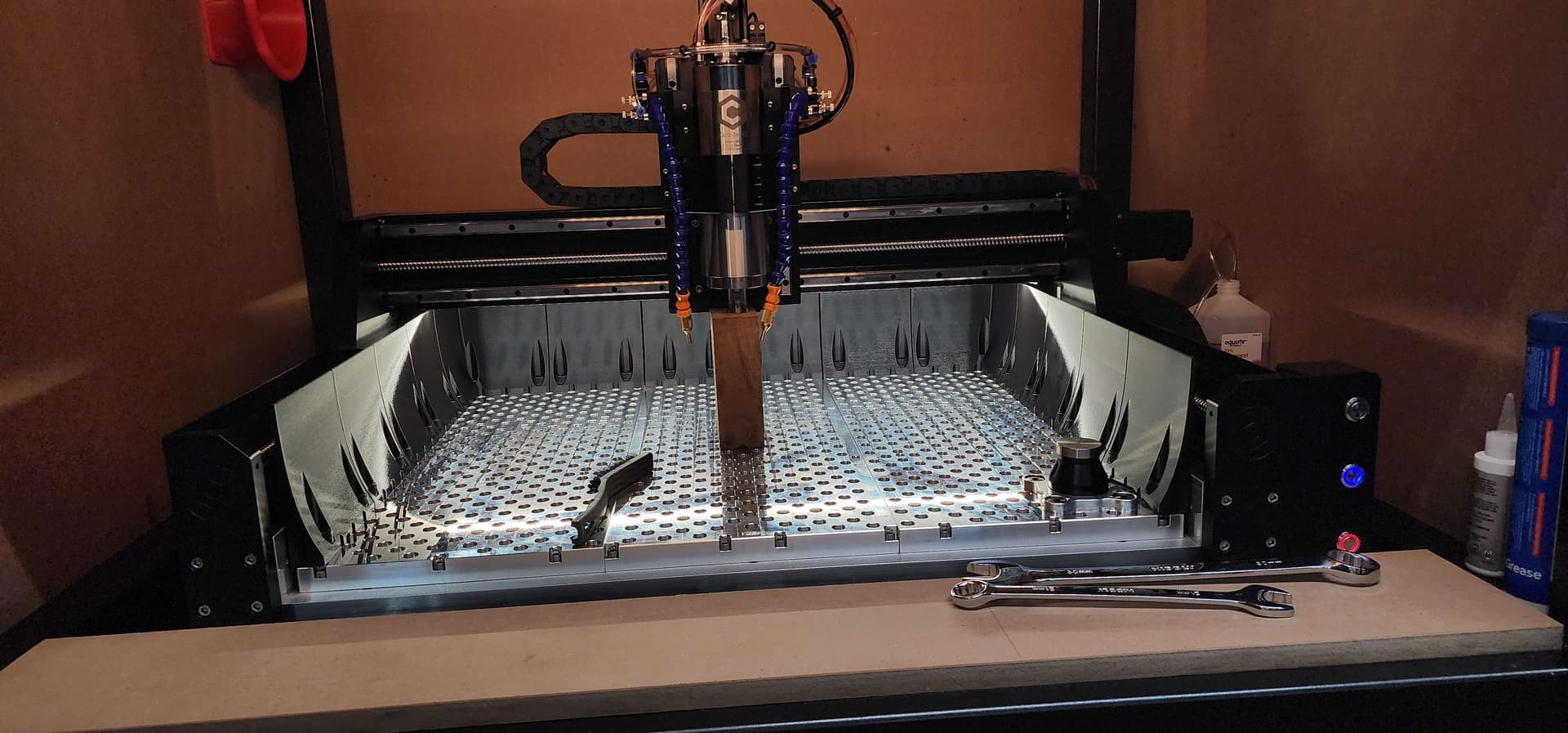

I jog my hdm to the center then lower it onto a block of wood.
Welp it sounds like a piece of support foam or wood it is! Seems strange that the z stepper motor has not been replaced by C3D with another type.
@Robthatguy i love that shield around the perimeter of your HDM. Did you make that?
Yeah, I modeled it off of the files saunders machine works gives you for cam.
