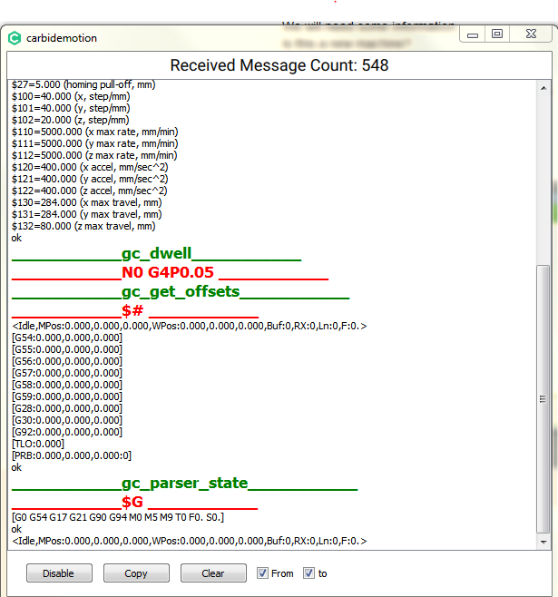

I have a shapeoko 3 XXL and the Z axis is off almost 50%.
Is there a method of moving a mm or so and then telling the program how far I am off? I have seen the Winston Moy Youtube where he recommends milling a “level” surface, but my depths never actually ever reach the programmed depth. This may not be the right approach but any suggestions are welcome. Cheers!

Type $$ on the MDI line with a log window open.
specifically you need to look at:
$100
$101
$102
Looks like $102 is set to 20. Mine is set to 40, so that would account for half…
Your settings for max travel look way to small too.
$130 and $131 should both be max 850 mm for an XXL.
Mine are set to
$130=800.100 (x max travel, mm)
$131=838.000 (y max travel, mm)
$102 is the culprit. It should be 40 not 20.

But that Z has to be 40-ish not 20. That’s why you are getting half the distance you expect in Z.
Thanks for all of your help. I made the change to 40 and all is right with the world now. This is weird that it is off like that. This is the stock program that came with my machine when I got it.

$102 needs to be same as the others.
Type $$102=40 and move the Z to confirm you are indeed moving 1mm when using the 1mm jog in Carbide Motion
