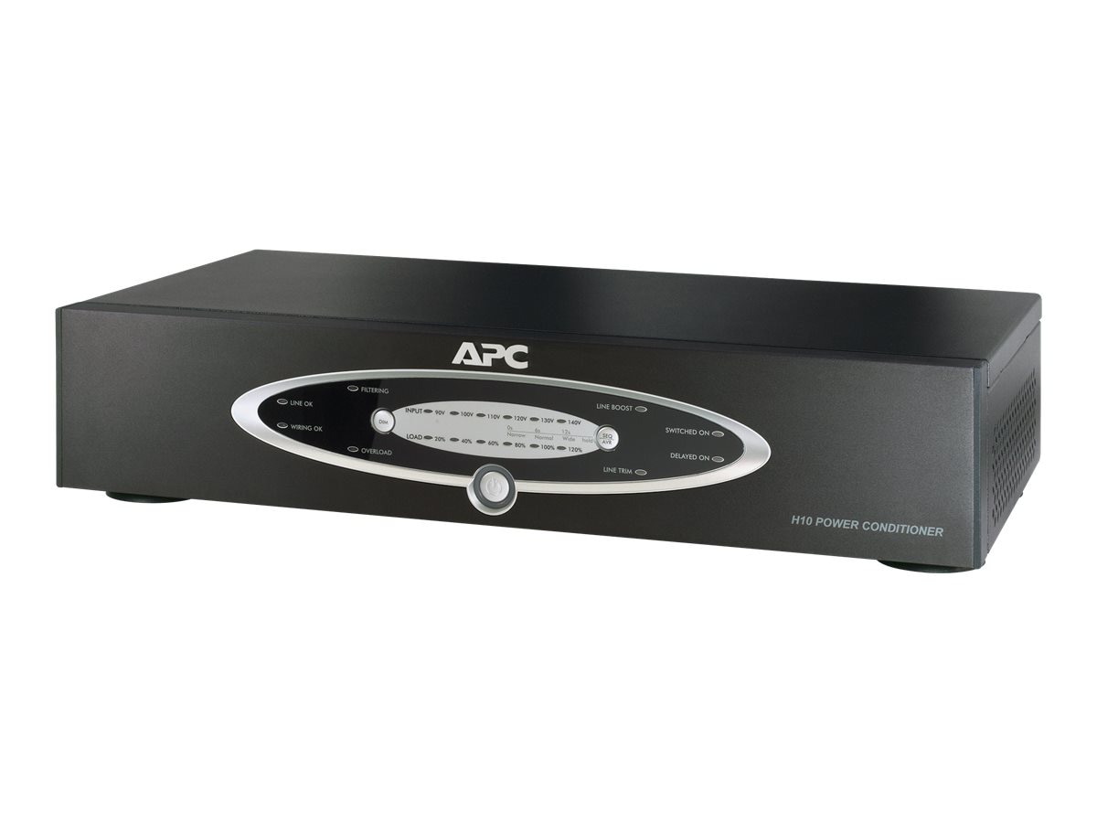

It has been a while since I published this article. So, I finally found out what the issue was. It was not the Shapeoko. I noticed on another of my machines issues. I am not going to go into detail, but what solved my issues for everything was to install a power conditioner in my garage and use that source to power all my CNCs. No issues since then. I waited 3 months to make sure I did not see any issues. I also had on a rotating basis each CNC plugged into house power until they had an issue. In over 3 months no issues for all CNCc plugged into the conditioned power.
With that fixed, I re-coded the Shapeoko post processor in Aspire and now with BitSetter and BitRunner I can create one cutting file using all the bits. I can now use the system as designed by the great folks at Carbide3D.
This was a messy issue. I don’t think I would have ever figured it out if I had only the Shapeoko. I hope this lets folks know that good clean power is necessary when running a micro controller.
What power conditioner did you use? Link?

I am very bad at getting online. Sorry for a late answer. I found the one I got on CDW. Here is the link
Most will say this is over kill but it cost less than getting an electrician and having the garage power reworked.
