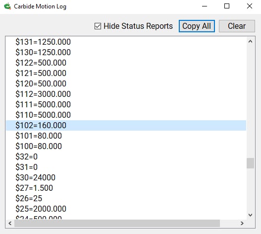

I’ve read on some forums that this issue might be related to the $102 value. I’ll attach a screenshot of the log showing my current values.

The settings should be correct for an SO5 Pro (Carbide Motion detects the controller for that machine and identifies it).

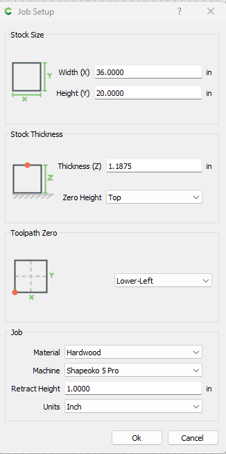

Where is the origin set in the file?
How are you setting zero relative to the stock?
Thank you for your response!
The origin is set above the piece, at the lower left corner of the stock.
Additionally, I’ve set the zero relative to the stock just like in the video. I positioned the tool at the zero point of my project and then pressed Zero All.
Let me know if you need any further details.

It is not possible to select a Z-axis for the SO5 Pro since it only comes with the HDZ.
Your $102 setting of 160 is correct.
Thank you for the clarification! Now it’s clear regarding the Z-axis and the $102 setting. I appreciate your help! I will now look for the problem elsewhere.

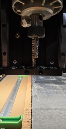

Is you bit pulling out of the collet?
Upcut bits have a tendency to pull themselves deeper into the cut if they are not held tight enough in the collet. Be sure the collet and cavity in the router shaft are clean and the bit is inserted the full depth of the collet. Grab a sharpie and mark the bit at the point just below the collet. If it pulls out you’ll see the mark lower than where it was.
Are you sure your stock is 1.875in as measured with a caliper and is the stock thickness consistent? That’s my only two thoughts maybe.
Thank you for your reply! I believe the bit is securely tightened in place, but I will double-check it this evening to be sure.
Thank you for your suggestion! My piece measures 1.1875in, and the thickness is consistent throughout.

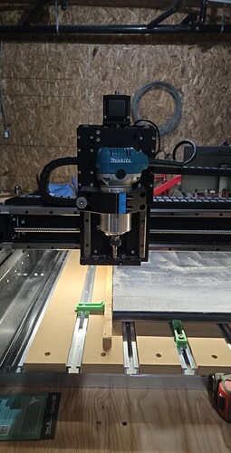

Have you found a solution to this problem? I’m having the same issue with the Shapeoko 5 Pro with 80mm VFD. In testing to find out why it was plunging too deep, I set Z zero on wasteboard, Jogged Z up to top then when I did a rapid to Z zero it plunged pretty deeply into the wasteboard (was using a vee bit in the collet)
Please let us know about this at support@carbide3d.com and we will do our best to assist.
I also see this. In my case typically after I do my initial (after machine turn-on and initialization) zeroing, including bit setter cycle, and then double check the Z height using the plunge 1 inch above current XY it is significantly too low (I keep a 1-2-3 block handy just for this purpose). I have not measured how much too low it is, but maybe 1/4 or 3/8 of an inch. I then rezero Z, and it’s perfect every time. Annoying, but now that I know that zeroing Z needs to be done twice (and only Z, never XY), it’s not a big deal.
Listen to Will and create a ticket through their support. Might simply be a loose bit walking out, or you may be losing steps on your rapid retracts from a binding issue in the Z. I suggest you check z- motion by hand with the machine off. If it feels like you’re lifting more than 10lbs, there may be an issue (that can assuredly be remedied). I see you’re running a makita router. Your router diameter may be a tad smaller than 65mm, and clamping the 65mm mount too small will bow your z-plate. To check, simply loosen the 2 bolts that clamp your router and lift the Z again. If it’s much easier, you may might benefit from adding a shim between your router and mount to reduce how far it has to clamp. Hope this helps. C3D will be of more assistance.
