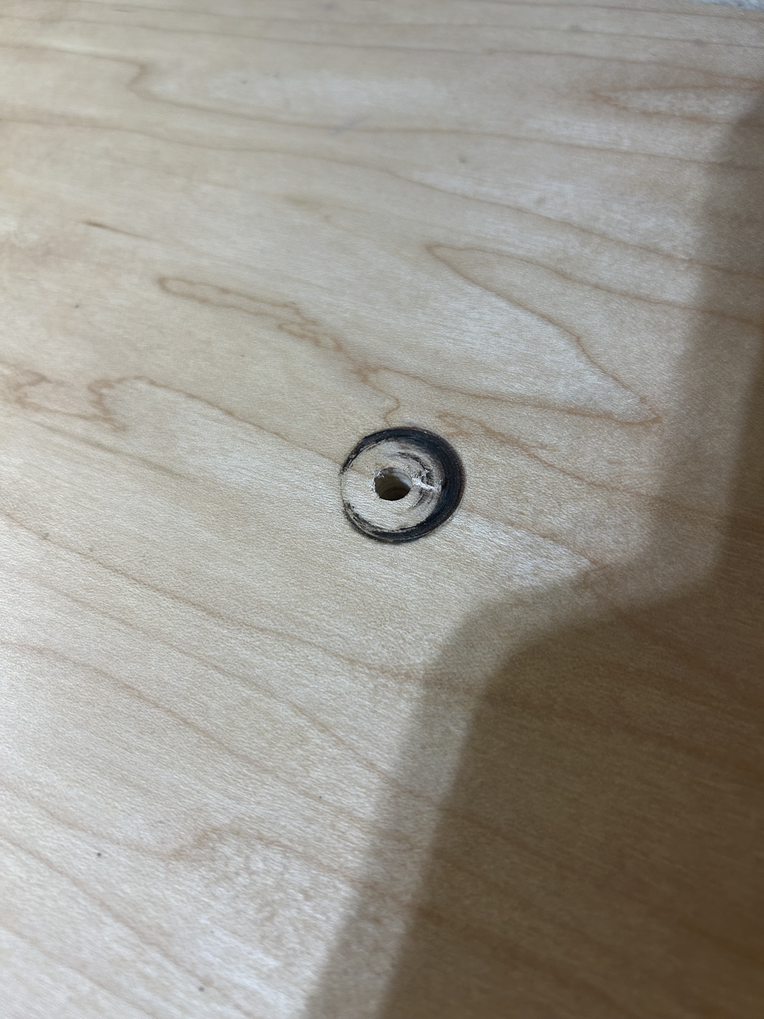

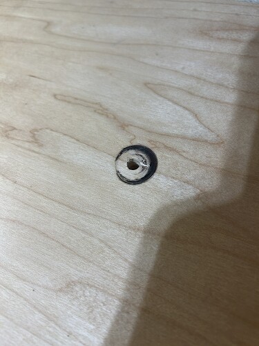

Z is correct. Still going to deep
I cannot figure this out. My job setup is set to “TOP”. The first cut is a small hole and as you can see, it is going way to deep. Glad I was watching closely.
I have reset Z many times.
I have looked at the C2d file and don’t see anything wrong. The pocket is set to start at 0.
Any ideas?

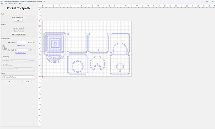

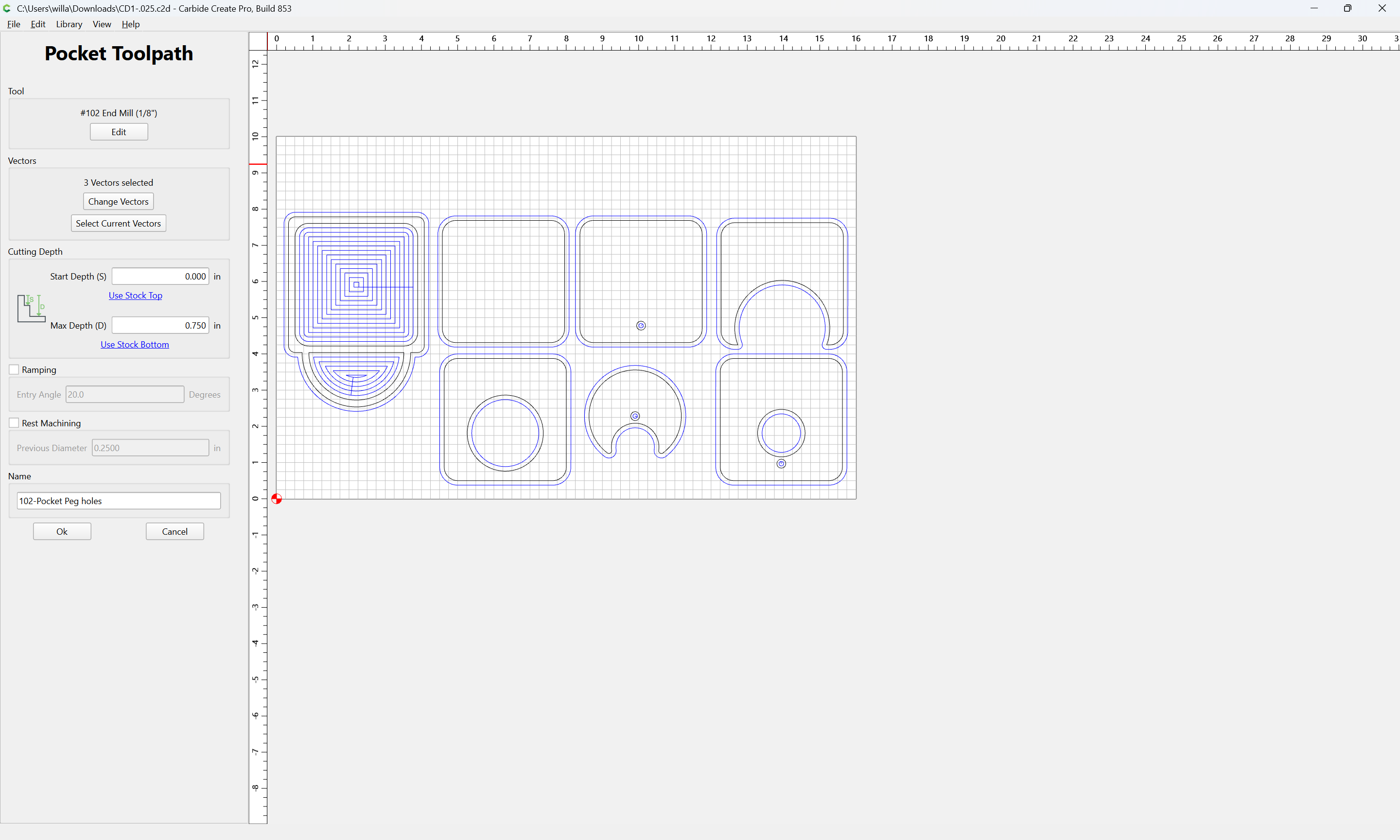

If the small hole is the peg hole, you have the your max depth for the hole set to the stock thickness - .750"
Yes, the peg holes are simply holes that go all the way through .75".
The #102 tool only has a cutting flute length of 0.5", yet you are trying to cut 0.75" deep with it:
Get a “Long Reach” 1/8" diameter tool which has at least 3/4" of cutting flute length?
