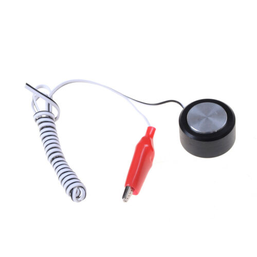

Z Touch Probe from Ebay
I have seen a touch probe on Ebay with just two wires. I was wondering will this work with XL! Thanks in advance for help .
TOUCH PLATE|500x500
Anything that can close a circuit can work, so this can definitely work, though not with Carbide Motion, which has hardcoded dimensions for the (Carbide3D) probe. You will have to use a different sender.
