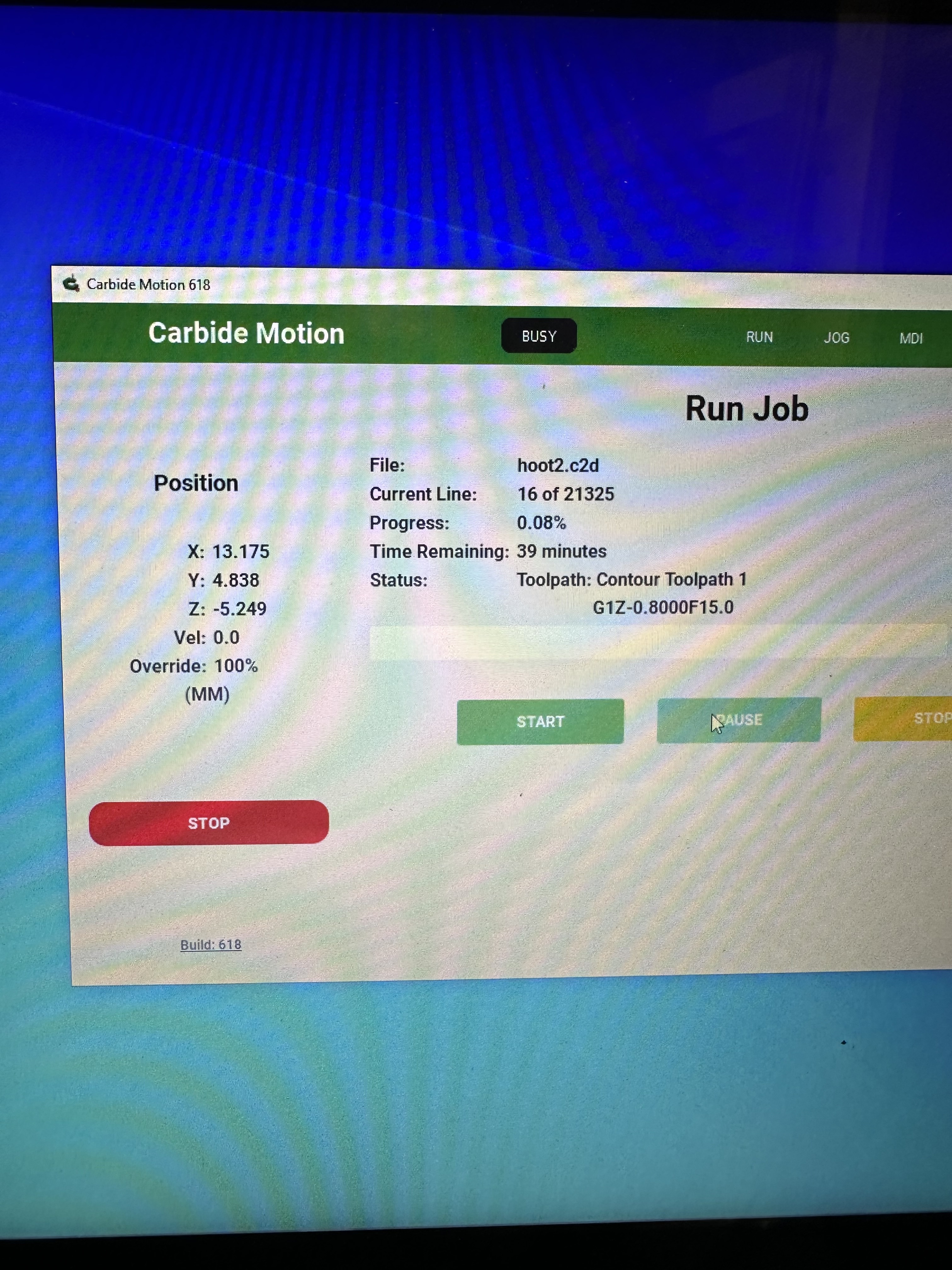

Z zero ignored?
Steps taken:
Launch CM
Turn on SO5 (at pendant)
Connect to machine
Initialize machine
Measure bit
Click jog
Remeasure bit
Set x/y/z zero
Load file
Start file
Load bit
Machine runs to start and plunges to z -21mm.
File is set to 0 at top, lower left corner. Toolpaths all start at 0 z.
I’m just kind of baffled as to what might be causing this.

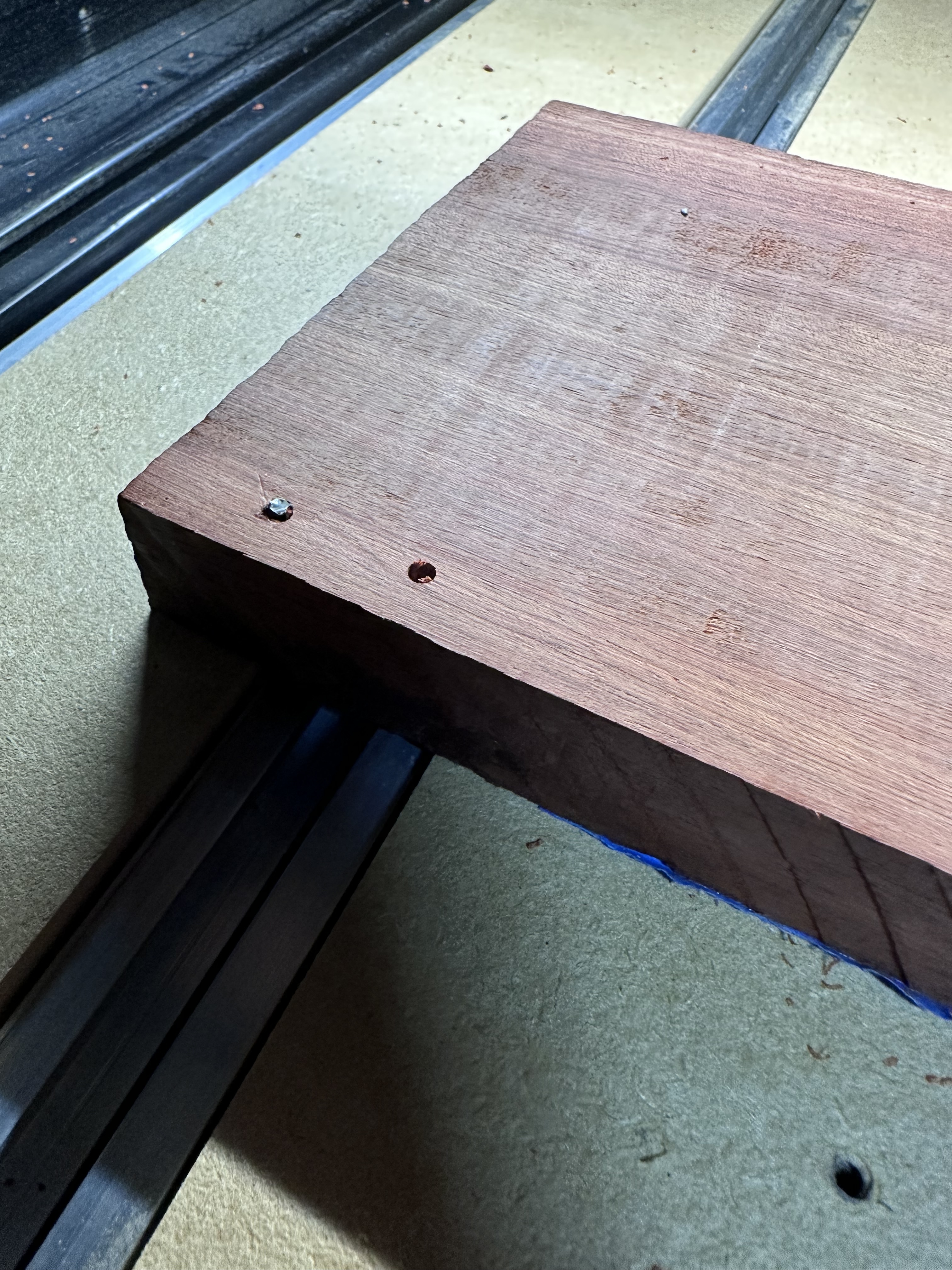

I paused the job so I didn’t break another bit (the broken bit can be seen to the left of the empty hole). Tried to time it right, but I was slightly too fast. I screwed up the video, but the link is the moment of impact. I don’t really want to try again at the moment.
https://youtube.com/shorts/h4rD-r7gGjk?si=EGUeBYppZyWcmgiS
Stock is secured with painter’s tape and CA glue. Z zero set with paper method.

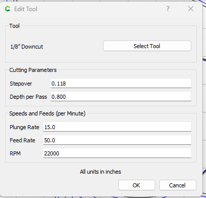

Looks like your depth of cut on the bit is .8 inches
Looking at the initial cut, the setting of 0.8" depth per pass looks a little aggressive for a 1/8" downcut mill
:man_facepalming:
Of course it is. Thanks y’all. It’s a glaring error.
I’ve been writing code for 30 years. It’s always something simple and stupid. I appreciate the extra eyes.
