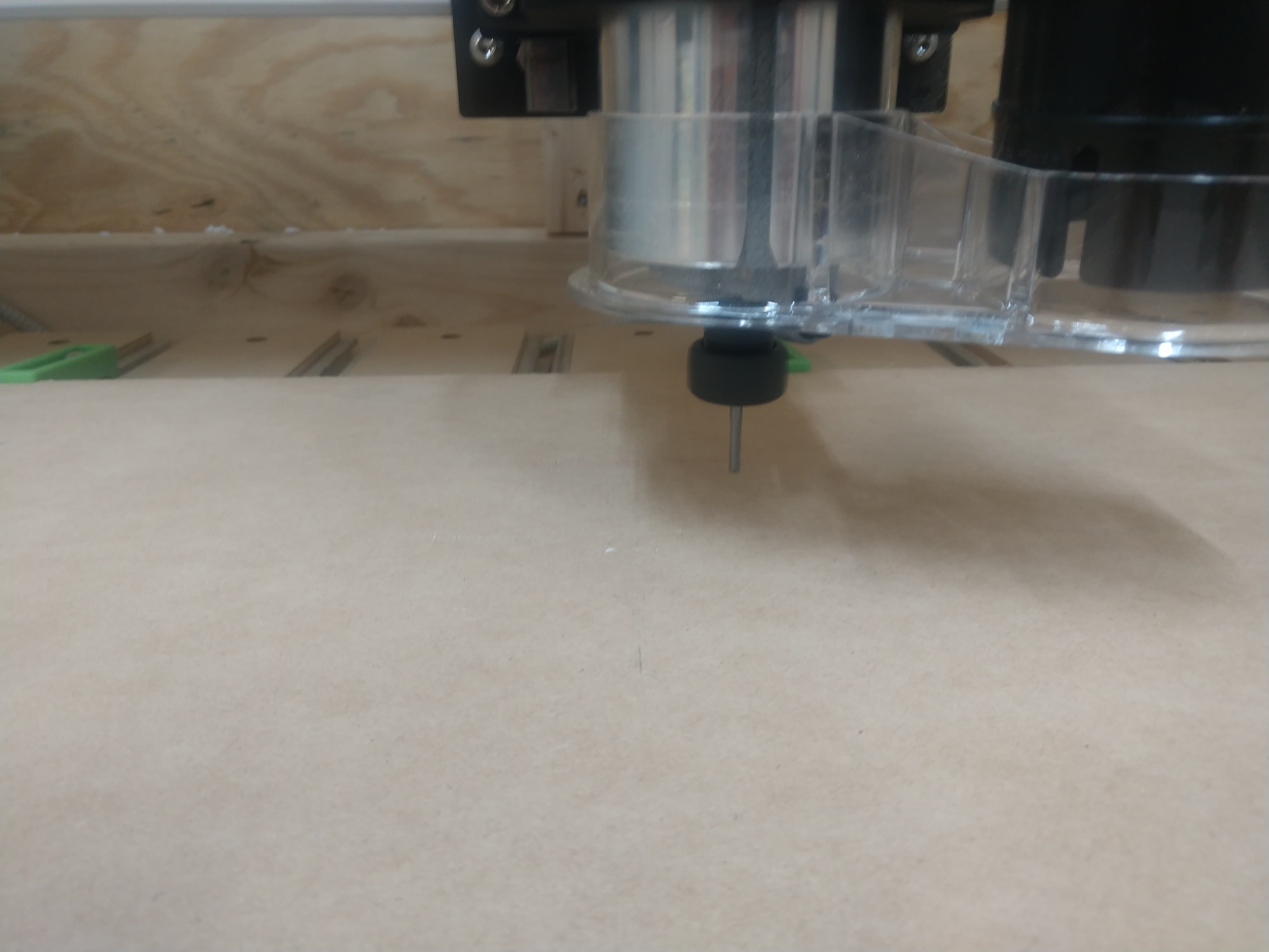

Hello still having the same issue. It’s still running the job about an "1/8 of an inch above stock. I’m using the bit zero and it’s touching of on X Y Z but still only cutting air. How can you manually set the z axis (stock top). Thanks
Please send a photo showing how you position the BitZero when probing for Z
Sounds like you are not setting the edge off the edge of the material. The edge of the BitZero v1 I have is .118" or 3MM. Since you are off by .125" (.118") make sure you are putting the BitZero over the edge for X Y and Z probing. You set the whole BitZero on top of the material without the edges hanging over the edge of the material for Z only.
Hello William I’m still having the same issue it runs above the stock and isn’t cutting anything. I probe the corner and then the top of the stock for Z. Here are some pictures. Thanks.
Is the machine physically able to jog down to where you want zero set?
Is something mechanically interfering w/ it moving that far?
If you manually set zero at a surface and then jog up 1" does the machine move 1"?

Yes the machine is able to jog down and touch the stock there is nothing stopping it from touching the surface. The pictures don’t show but it does touch off of the bit zero on both the corner and top.
