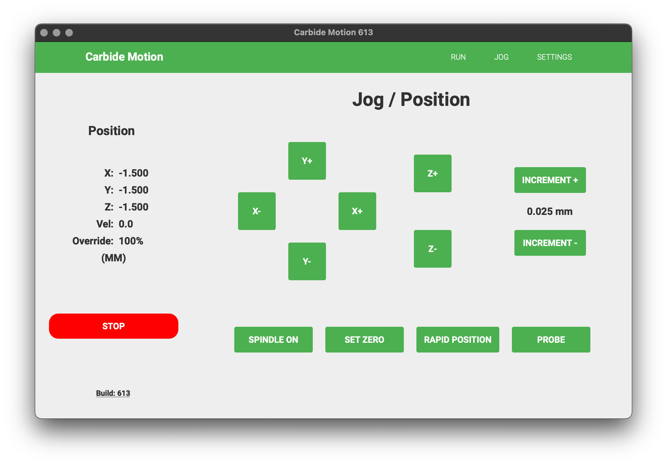

If I am running numerous jobs in a row, I can’t seem to reset the zero without having to exit out of CM, and turn off my machine. I have tried clearing all offsets, then making a new “zero” point (using the jog function, placing bit where I need and attempting to zero again), but it does not seem to reset to this new position. I do not get the prompt “set current location as zero”. At this point, I exit out of CM and have to restart, and go through the initialization process again. Am I missing a step here?

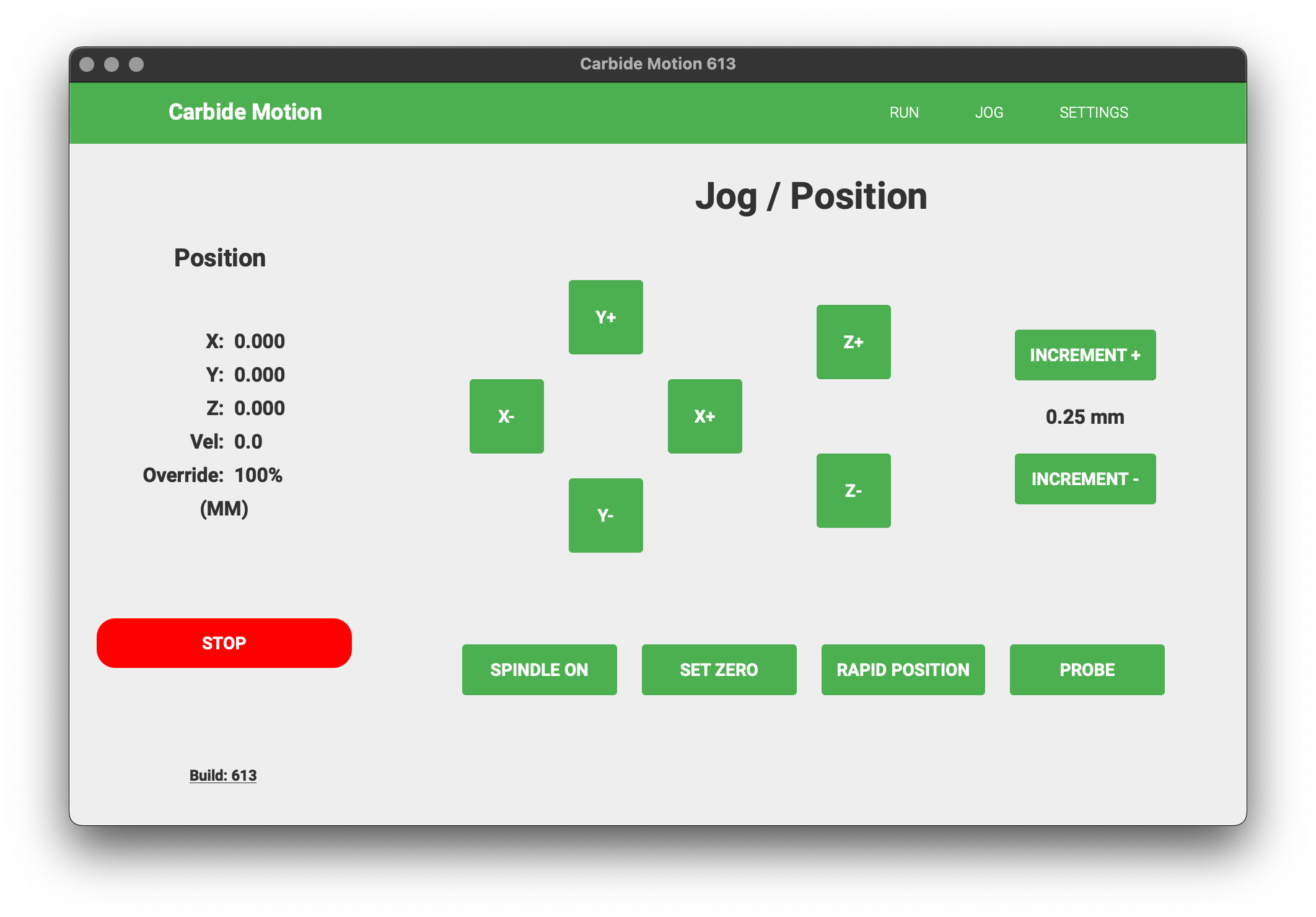

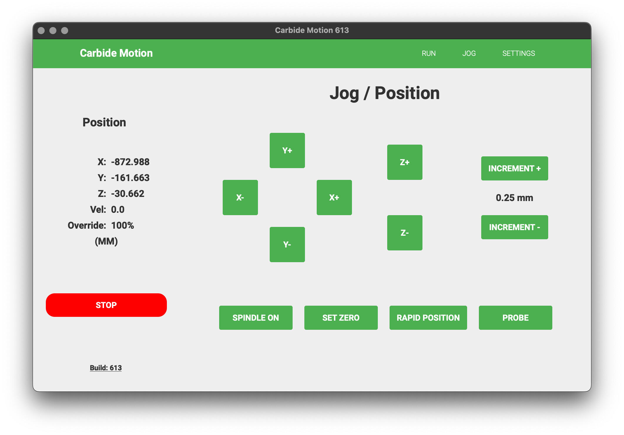

It should be as simple as:
  • jogging to where you want the new zero to be
  • choosing “Set Zero”
  • zeroing the axis/axes you wish to
See:

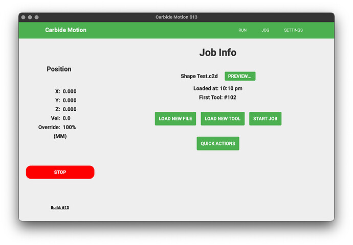

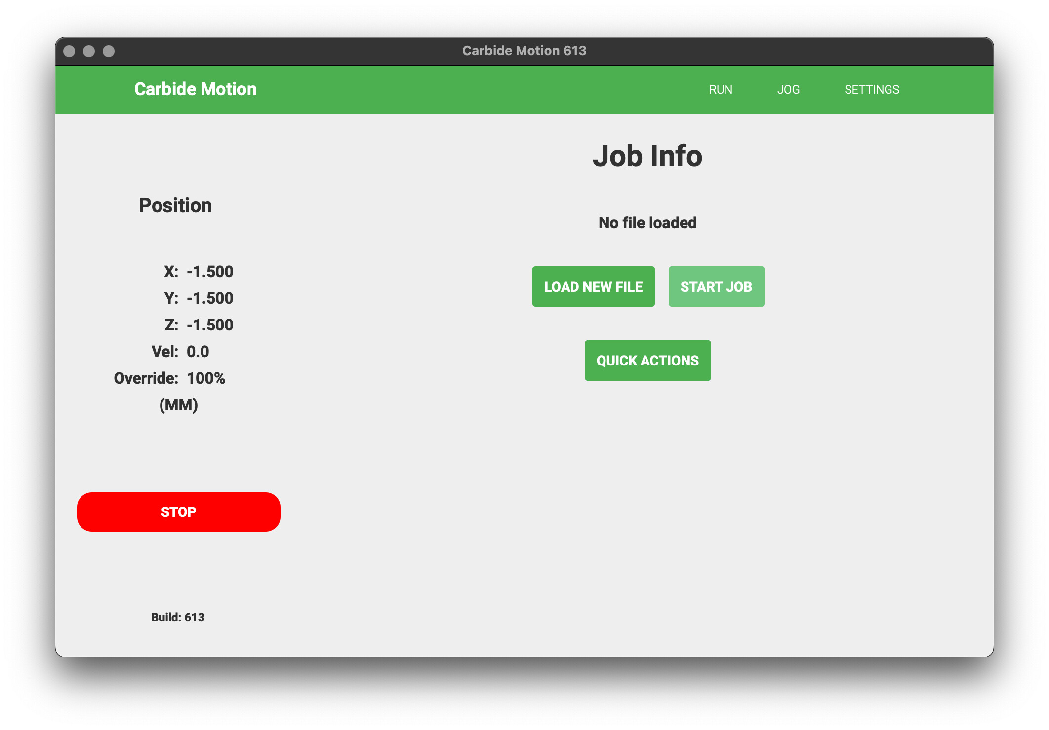

Here is my exact process after finishing a job and the machine returns to the back.
-Quick action and re-initialize machine
-Load file (new job)
-Jog menu, rapid position to the front center and change tool (not prompted to, but it is in position to do so)
-After tool change, I jog to new zero point and set zero
I get no prompt asking if this is new zero location as I normally do when starting the
machine
-Run, start. At this point, no new zero seems to be set as the machine isnt even going to a starting point on the new work piece I again had to exit CM, turn off my machine, and restart the entire process. I am totally stumped as to what I am missing in the process.
I am running CM on a Mac Desktop. Thank you for the advice and help!

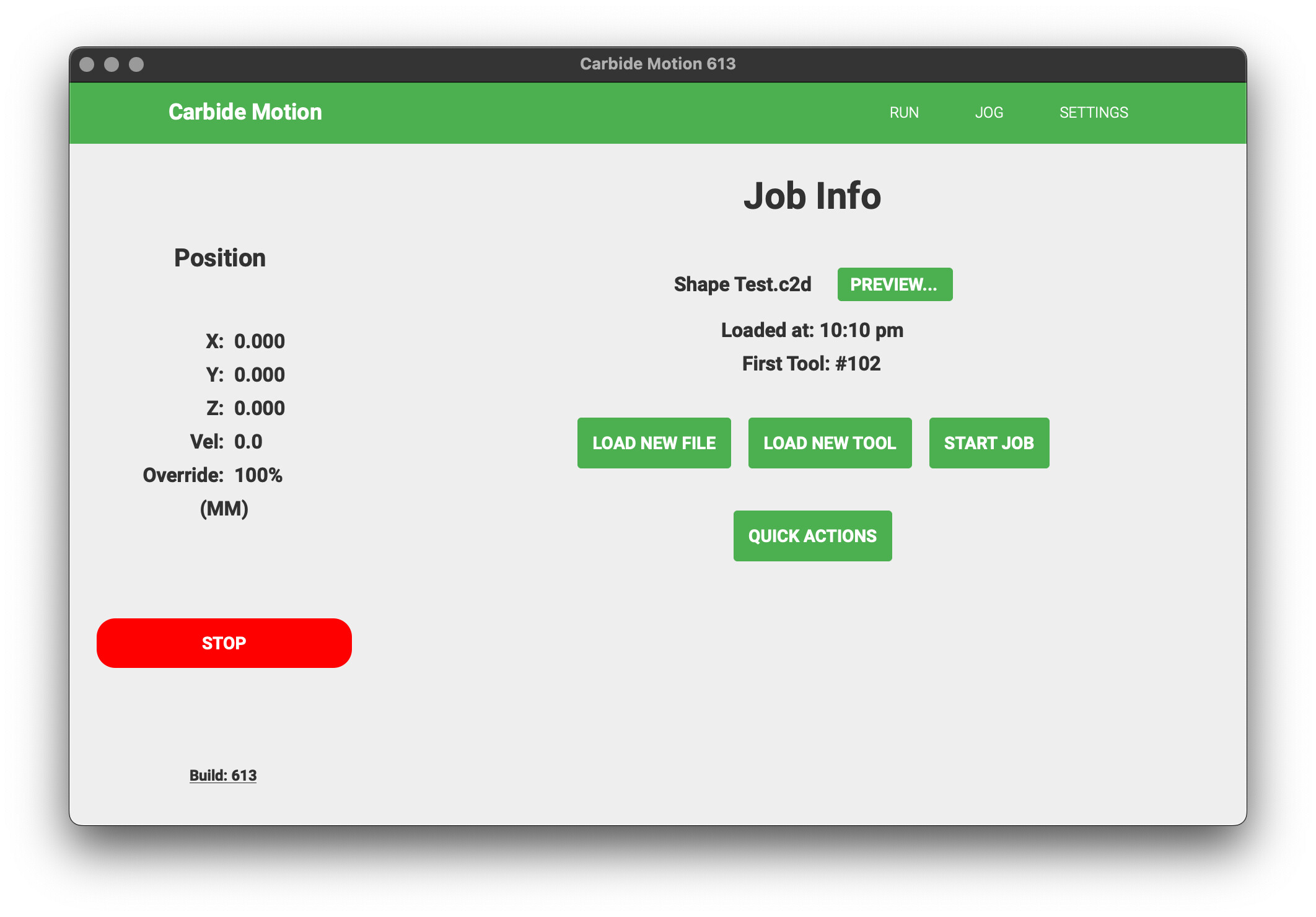

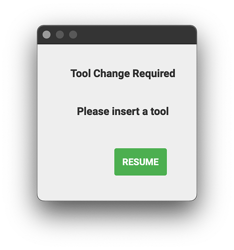

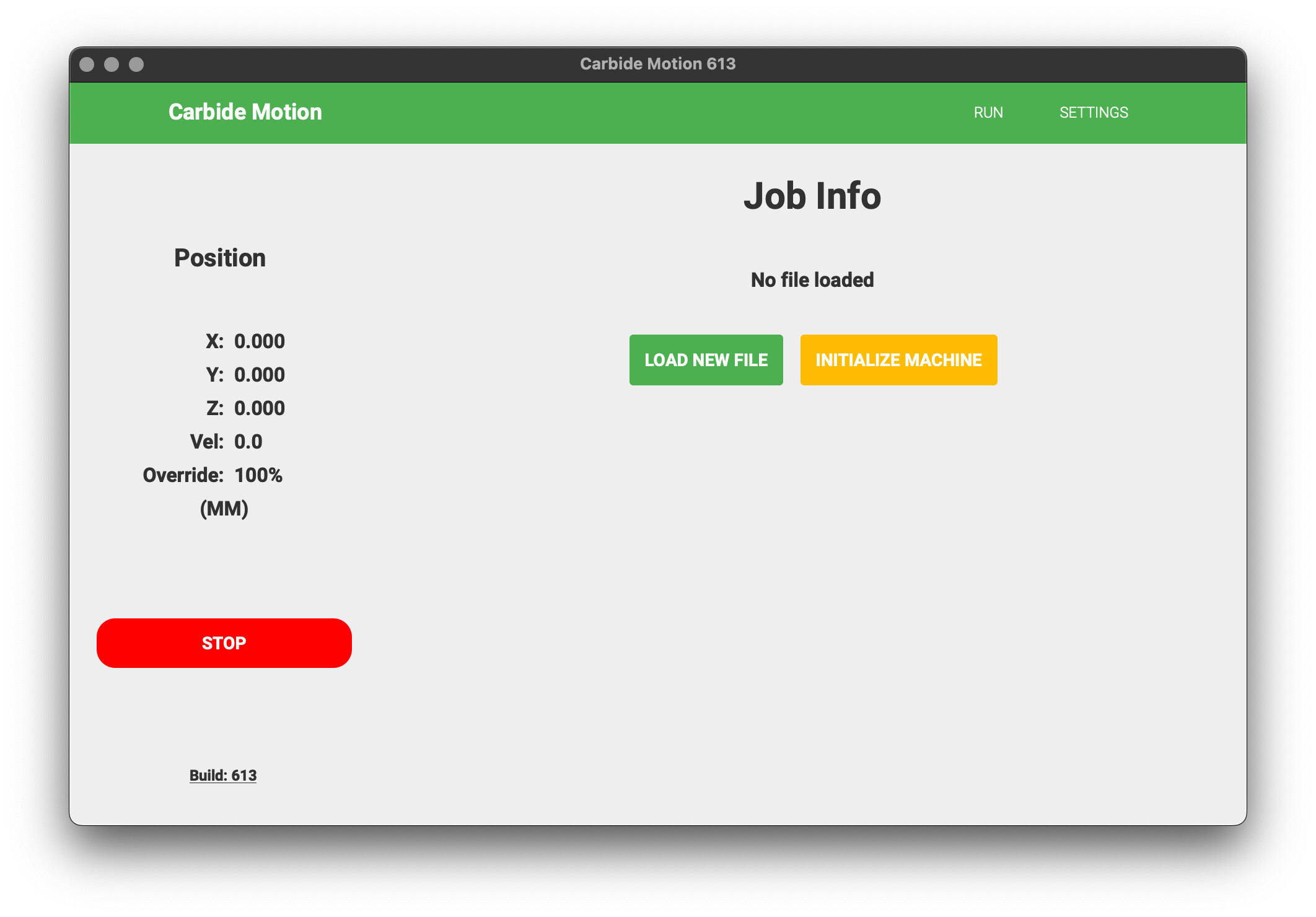

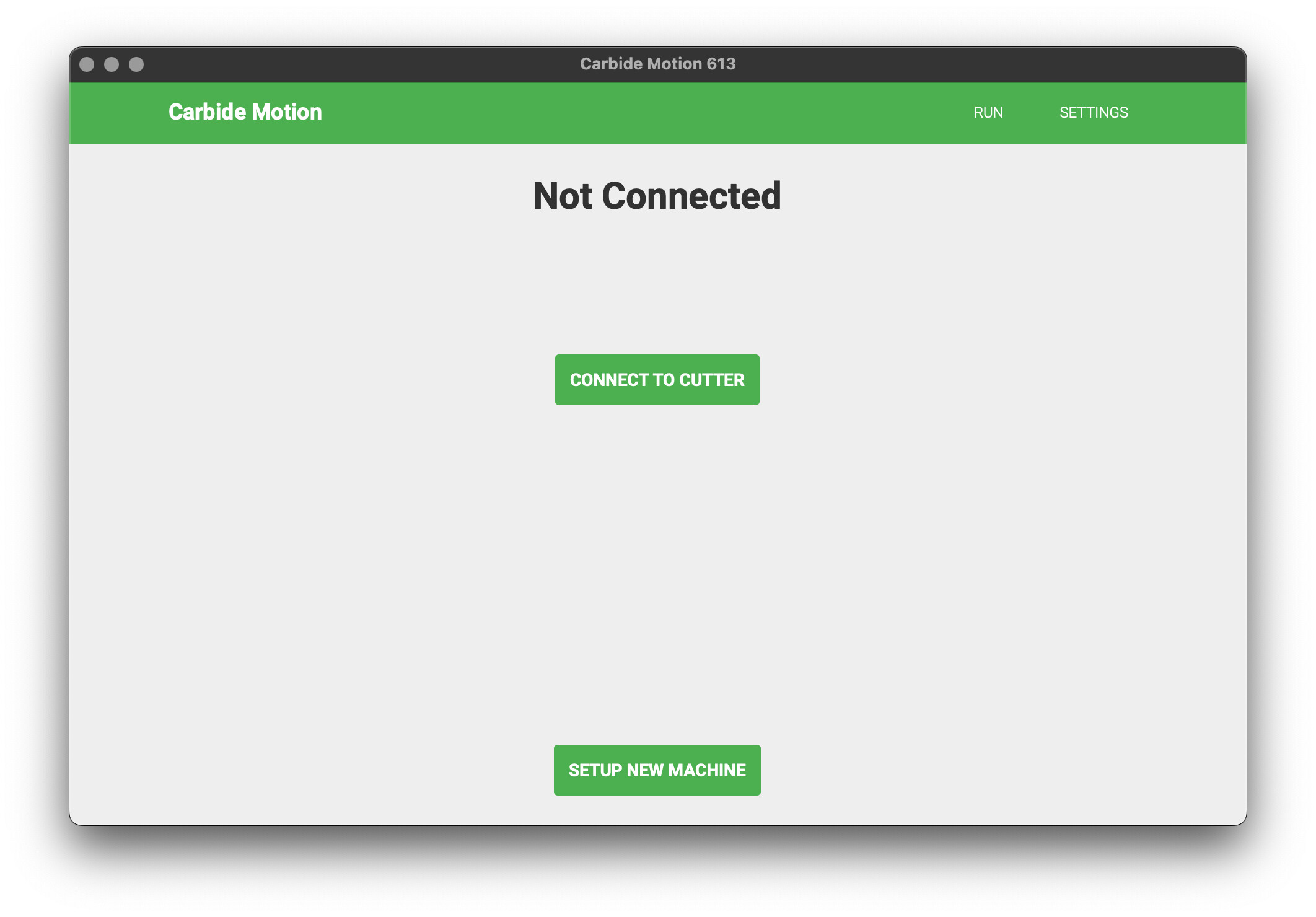

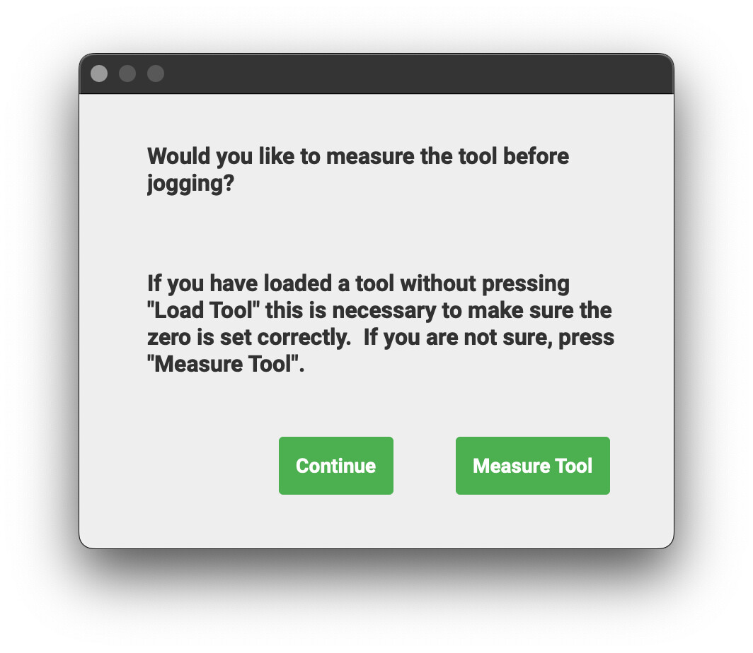

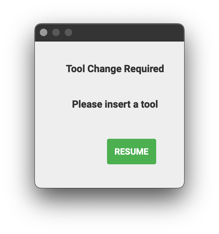

Here is how I do this:
Launch Carbide Motion:
Connect to Cutter
Initialize Machine
Prompt for loading tool
load a tool, allow system to measure tool
Jog
Query for whether or no to measure:
Continue since no tool was loaded since the tool was last measured.
Use the interface to jog to where zero is to be set:
Set zero:
Zero All:
Done
Run
Load new file

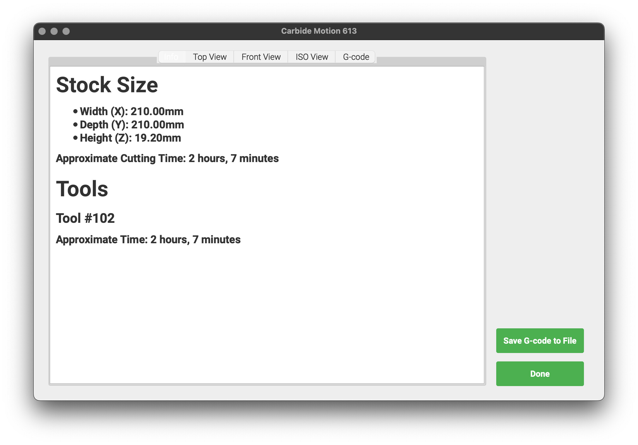

Verify the G-code in all tabs
Done
Start Job
The machine should lift, move to the tool change position, prompt for the first tool, then measure it, then begin running the file.

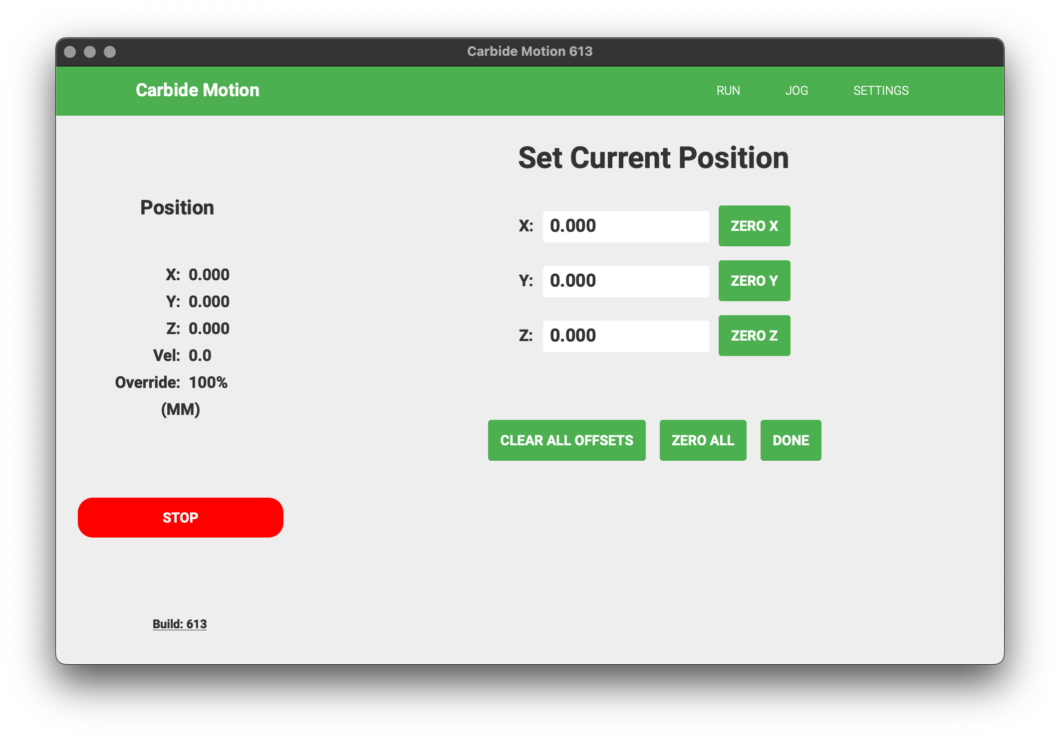

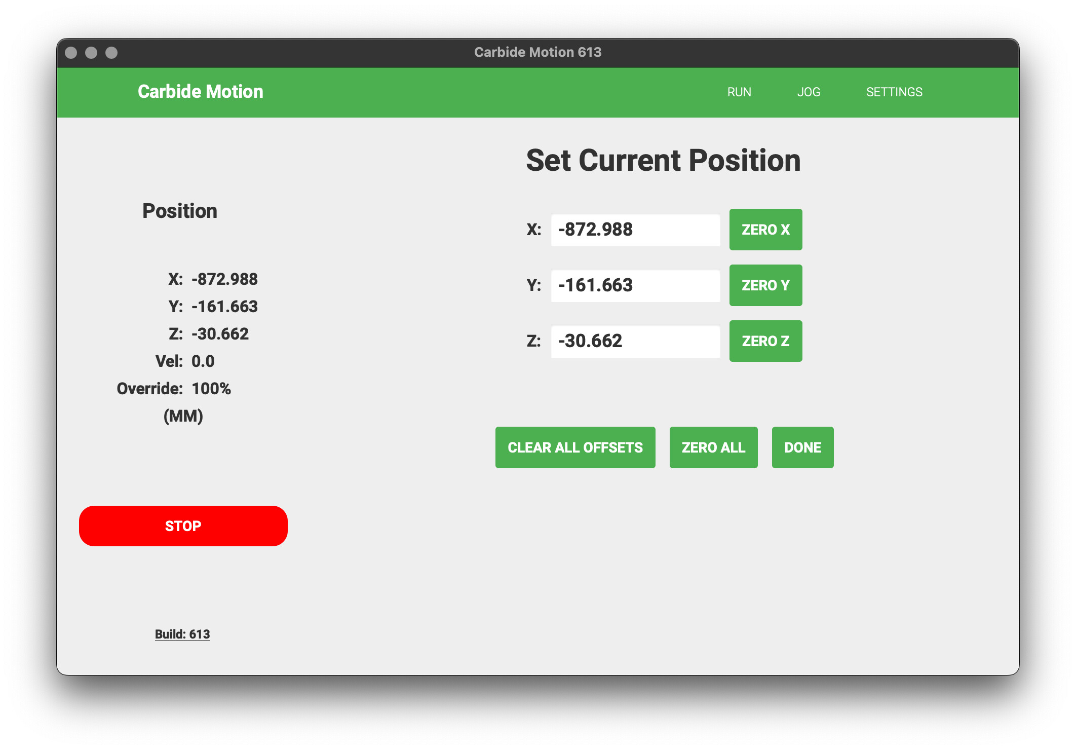

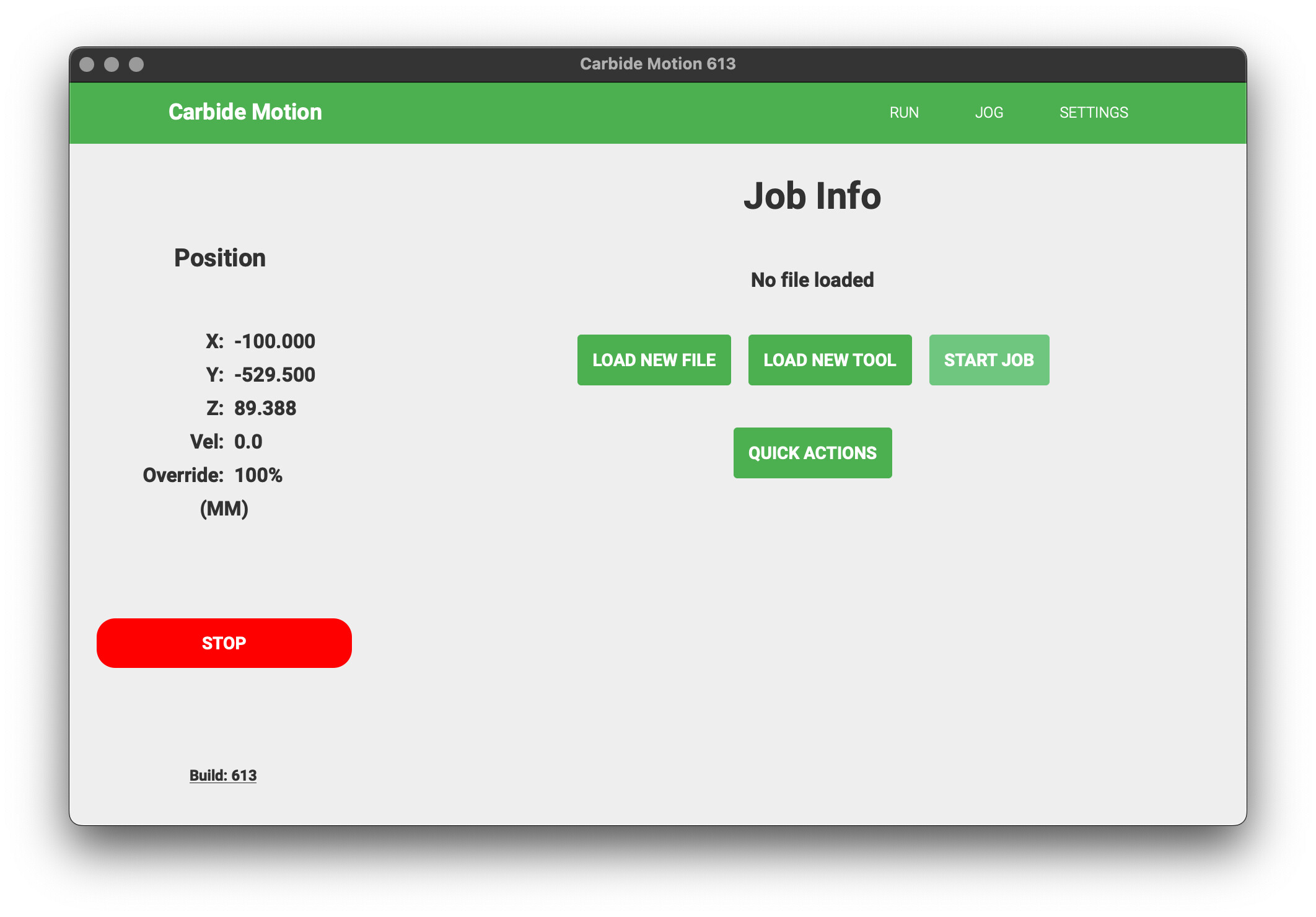

It should just work to jog to the new position, go to Set Zero, then set the new zero position.
Post a screen grab showing the Set Zero screen after setting zero?
The big thing is, as long as you aren’t using Stock Bottom for origin you can use the buttons for current XY and for Z+6 origin in Rapid Positions to verify that the position is set correctly.
I don’t believe there is a "Set position as new zero " prompt. You just go to the set zero screen after putting your bit on your zero - and zero all or the specific axis you’re zeroing. That’s it. No prompts…it just turns to 0.000 so you know that the axis is now considered at zero.
Click the “ZERO Z” button.
Will’s instructions for that step were descriptive, not verbatim.
