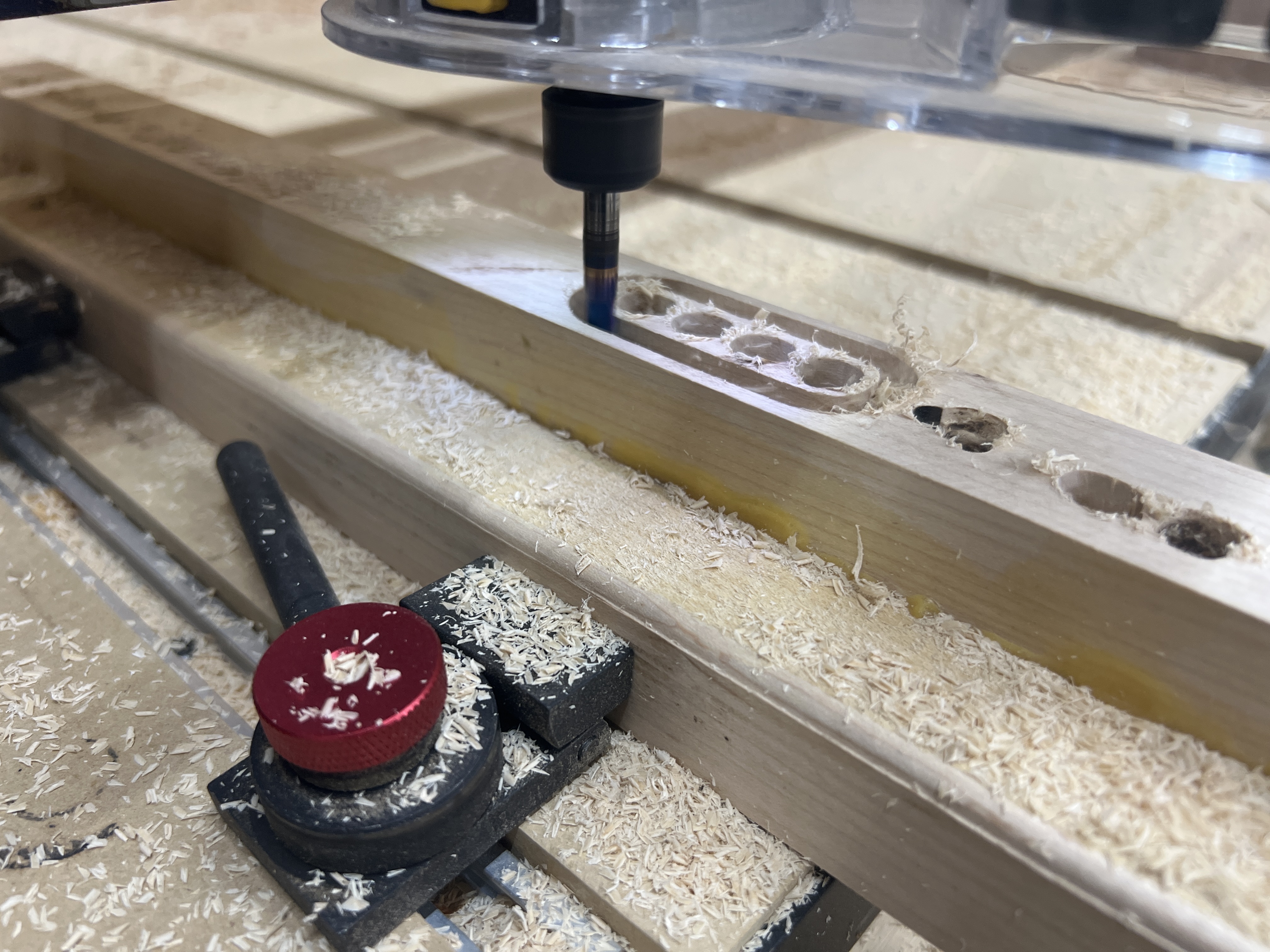

Hey team, I am stumped on this one. I have had my shapeoko3 for years and it’s been great. But recently it starts to lose its zero right after I start a project.
I zero it, start the program it raises the z and tops out with a grinding noise (like z limit didn’t catch it) then asks me to change spindle speed, and runs the program fin but about 7mm off.
If I start the program with my z set about 7mm above it runs ok ish.
So I think it’s my z limit but when I initialize the machine it works fine???

The grinding noise would indicate that the Z-axis is hitting the mechanical stop & losing steps.
The limit switches do not do anything after machine initialization.
This would suggest that the Z-axis configuration in the controller is set wrong or became corrupted.
You can check the values from the Settings panel in Carbide Motion

HD Z axis, Carbide motion 613? Where do I get the .c2d file? My tool chain is Vetric VCarve3d then carbide motion.
Did not realize that after initialization the limit sensors aren’t needed. That makes sense just didn’t think about it. So then maybe it’s just my gcode? I have used this code before but maybe I got lucky in the past?

Which lines are telling carbide motion to raise the Z and prompt to adjust spindle speed? I need it to stop asking for that if it would just start when I hit run it would work fine.
Thanks in advance.
As it’s sounds like your machine is lifting too high for a toolchange, then it’s the T1 command initiating this - which is then handled by the CNC controller. Which comes back to the Z-axis configuration is likely not set right in the controller.
Also the S12000 is setting the spindle speed.
Deleted this line and it runs just fine now.
G0Z0.8000
Need to get into settings and figure out what’s up with the z travel. But it’s running great now.
