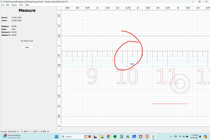

I initialize machine, load tool as prompted, set zero, run a job, then disconnect or “park” machine (using CM) which sends the spindle to the back right top position, then power off and go inside. When I come back out the next day, power on, initialize machine, and load tool when prompted shouldn’t the XYZ zero be in the same place as it was?
Shapeoko 5 PRO using current versions of CC and CM. Thanks in advance.
Yes is should. But I would never just trust it start cutting. Always double check!!!

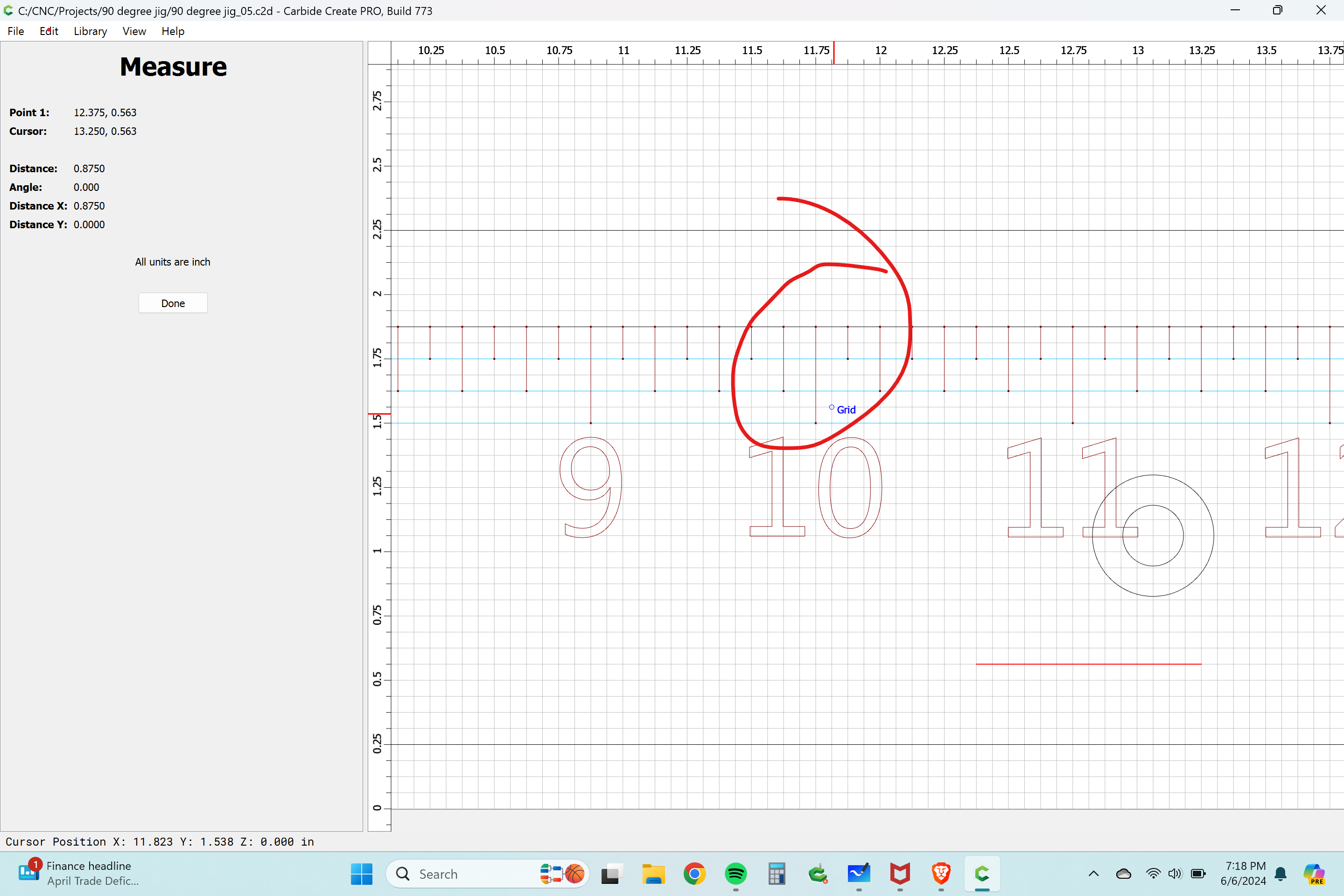

I always double check my zeros before cutting. The reason I ask is I made a sort of ruler out of ColorCore the other day and noticed the dimensions along the X axis are off. The 12" mark I cut measures to about 12-1/16", 24" mark is 24-1/8" and so on. So this has prompted me to look really closely at the X axis and I’ve noticed when I turn the machine on the day after a cut, with the previous days stock still in place, the x needs to be re-zeroed, but not z or y. Curious if anyone else has noticed this.

Well, mud on my face. It was my error in CC.
Must have got carried away with the old cut/paste. Case closed.
