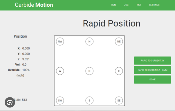

First, zero, once set should be persistent until changed (though tool length may need to be re-measured).
Click on “Position” to toggle to Machine Position — that will give you a set of coordinates to write down, then to restore, reverse the process:
  • click on Position
  • jog until Machine Position is arrived at (or use the MDI to go directly, or set an offset zero)
  • set zero once at that position
My machine remembers zeroes even after powered off. Although it could be off by a few thousandths just due to the accuracy of the homing cycle. If you need it exact, then re-zero. Otherwise I usually just rapid to XY zero & check it. If it’s the same tool left in from the last job, Z should also be very close.
Even through a power off cycle the zero is officially maintained?
Another “EZ” way to do this is to set your XY Zero as one of the Rapid positions and make a corner fence for that position.
Yes. We have some customers who set the zero once (say as part of positioning and machining a corner square) and then never change it.

Correct. Carbide Motion does this when it sees an M2 or M30 move.
This will depend on the G-code and if a tool change is necessary.
Where the machine was shouldn’t matter — so long as it won’t hit a clamp from where it was getting to where it needs to be.
As noted the machine initializes, then uses the new Machine Zero as the beginning point to get to the offset Workspace coordinates.
If a Probe operation fails, Grbl goes into an error mode which must be recovered from since the machine does not know if steps were lost or that the current position in the software matches the physical state of the machine.
It should be accurate to w/in half the homing switch sensor positional accuracy as it interacts with the step size for that axis — I’ve re-homed and re-run V carving files with good results.
It should only be necessary to re-probe if you need a new origin which is different from the current one.
