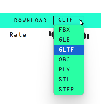

Is there any way to get the output of ZOO Text to Cad into Carbide Create? I couldn’t find a output format from Zoo that I can import into Carbide? Anybody else try this or give me the format I can get converted and imported into Carbide?

Looks like STL is the only format that CC can import…
Although I wouldn’t want to cut something prismatic (primitive geometry) as an STL.
I would want the curves to 2D machine it. I’d output STEP or OBJ and pull it into a 3rd party CAD system to translate.

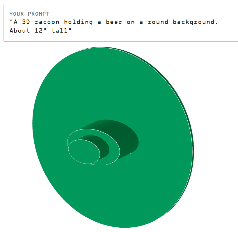

Seems to have some issues with more abstract prompts…
