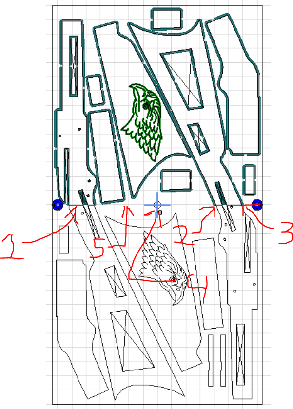

The big problem is how to continue the pattern cuts after rotating the panel on the center peg hole and match the cuts in the 1st half.
Note in the rifle pattern a vertical line (on the center line) that divides the pattern into 2 parts. This is important and will be shown in the next picture.
Note 1 is that line. It does not divide the cutting of the part but assigns a start point and end point which you can start from with the second half of the panel. In Estlcam, there is an “engrave” command that assigns a tool path to single lines which do not require being “closed”. Using that command, I start at the end of that line (note 2) and follow dot to dot around the pattern until I reach the other end of “that line” (note 3), you simply select the “close” box in the “engrave” command and Estlcam treats that single line as a closed “vector”. Note 4 shows the center peg and Note 5 shows the grey center line.
Estlcam Engraving command, 1. select command, 2. on line, left or right of line 3. Recognized lines or dot to dot 4. Dots, intersections or center points.
When you get to the other end, select the “check mark” to close your selection and complete an engraving tool path. The green line simply shows an expected path you can continue with. The blue line is the tool path.
The first cut I do with my cut file is to drill the 2 alignment holes. They will be important when cutting the 2nd half of the panel.
It is important to note that I create 2 cut files, 1 for each half of the panel. Since both halves are created from the same drawing, all 3 holes are in perfect alignment for each half of the panel. The side alignment holes than allow a perfect 180 degree rotation of the panel for cutting the second half of the panel.
The two cut files, 3 alignment holes, starting and end points of the patterns and the pattern in full are all rotated together so no misalignment can occur. The second half is rotated, placed over the 2 side alignment pegs and you have perfect alignment of the 2nd half with the 1st half.
The 2nd Estlcam cut file simply starts where the 1st left off and continues the cut.

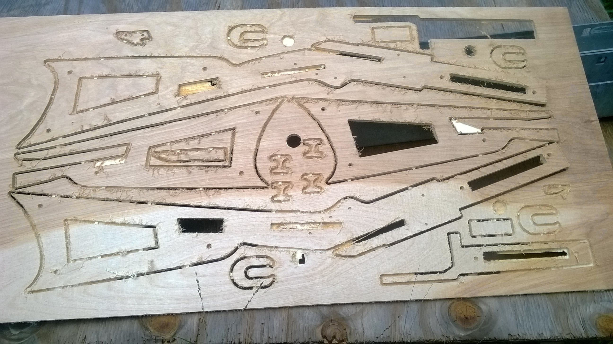

The next pictures are of a panel cut and a panel with the parts popped out.
It is just that simple. I hope this is useful to you.
