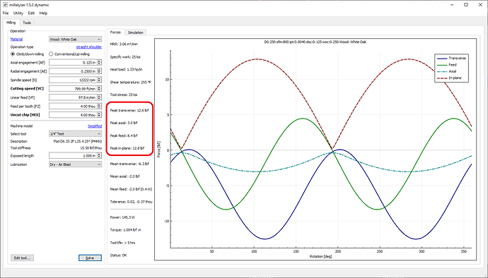

Internally any machine that uses V-wheels I try to limit to around 20ft-lb. That’s not a perfect number but a decent starting point. To demonstrate the above I’m going to use Millalyzer (Link) for these calculations. It doesn’t come close to accounting for everything but gives a good general idea and is mostly accessible to everyone. For all of the below I’m using a “generic geometry” endmill and it’s 1/4", 2 flute, 800SFM (12,222RPM), in white oak.
0.125" deep, 0.004" chipload (97.8IPM), slotting.
Here our peak forces are around 12lbf so we are probably okay.
Same cut but 0.250" deep.
Now we have crossed into ~24lbs and are probably going to run into issues.
Again, any increase or decrease in the chipload (feed), stepover, or pass depth will change the forces. So it becomes trade offs.
Also again, all of these are dependent on multiple variable like tool geometry, material, runout, or in the case of wood even it’s water content. So your best bet is testing so you know what is working on YOUR machine with YOUR material, and YOUR tool.
