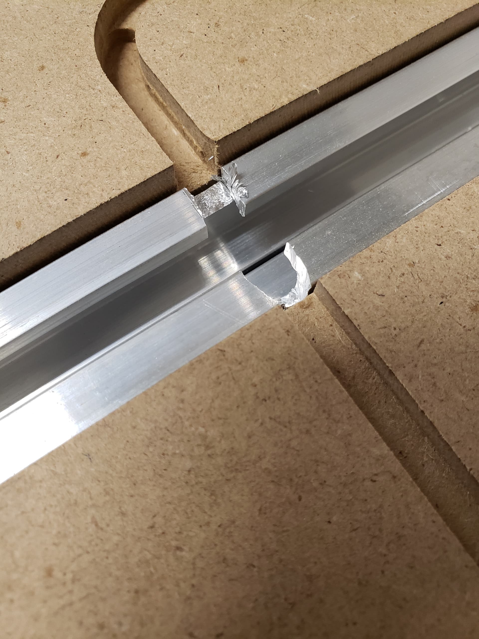

1st Time - Material comes loose

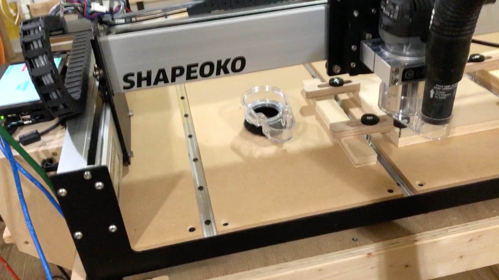

I have a Shapeoko 3 XXL (Or is that a 3 Pro? Can’t keep track of that kind of thing.) I’m trying to make the endmill holder in the tutorials. I save using the 102 tool (1/4") for last, since that cuts out the finished product from the surrounding wood. I tried this once, without the T-Tracks, but it didn’t work and I figured I’d be safer if I went on and installed them before trying anything else. It was easy and quick to install them. With each rail and each board, I pushed down and to the left to make sure they didn’t stick up and were tight against the left size. (Also worth noting that I put levelers on the table legs to make sure the tale was level as well as using levelers on the Shapeoko to be sure the bed was level and checked to make sure everything was square.)
When I was ready to try a 2nd time, I clamped down my material. I also put the Sweepie on (I know the bottom part is off in the photo below.)
I had no problem getting through the first two files, using the 1/8" endmill and the 60° endmill to etch the lines. (Well, one glitch - I mention that at the end, in case it matters.) Everything was fine until, in the last step, the router started making a “top” corner and ran into issues, as you can see in the photo below. I had to use my emergency cutoff switch. The endmill came out of the router and put a hole in the fill board between the T-Tracks.
I suspect that the problem on this test was that the wood piece I had down on the other side of the clamp was just a little thicker than the material I was cutting on and that might have lead to a loose hold on my material on that side.
I changed to using wood of the same thickness of the material all the way around, on all clamps. I did make a mistake of positioning my material, and that led to a mess due to the grain on the surface level of the plywood splintering and coming up. That’s my bad, I know what I did, so no need to worry about that.
This time the router made it around the edge of the work once, but when it got to the same place as before, on the 2nd time around (last time it happened on the 2st time around), the same thing happened. The material came loose and everything went bad from there.
You can see that, once again, it went off track and drilled an extra hole in my project and made another hole down into the fill board. So the same thing happened in the same place both times. The difference is that the 2nd time, it had already gone around once.
I’m wondering if it could be related to another issue. When I first used the 302 endmill to draw the lines on the surface, I re-zeroed the Z-Axis, since I knew the endmill tips were not all at the same height. You can see the result I got:
The lines etched in on the left, but not on the right. I know this means the distance from the tool to the board are not consistent. I checked if it was clamped down and that the fill board was all the way down. I have not yet checked to be sure everything on the Shapeoko is still squared off. To fix it, I just rezeroed a few 1/100 of a MM lower and ran that file again. It looked fine and I could swear that I could not see a difference in depth in those lines when I inspected them later.
I’m wondering if this issue could be connected with the big issue - maybe something’s not level and that’s creating a problem? I question that, though, since it looks like the lines aren’t etched in other places, so I’m thinking the board (which has been in my shop for a few years) might have a slight warp to it that I can’t see. I’m not overly worried about this issue, but thought it best to mention it in case it has something to do with the bigger issue.

So that would be the root cause: if the endmill is not nice and tight in the router, and it starts to slip, then all bets are off. You were using an upcut endmill, and while cutting they create a force that tends to pull the stock upwards…or pull the endmill downwards, whichever gives first. This may be due to not tightening the collet nut enough, or having dirt stuck in the collet, or a faulty collet, or using inappropriate (too deep) depth per pass during the cut.
So you had both the endmill slipping out of the collet AND the stock coming loose ?
Did the endmill slip in the collet the second time too ? If so, you may “just” need to eliminate the endmill slipping problem. When an endmill slips and starts cutting too deep like it did here, the machine will start pushing hard against the stock, and if the workholding is not great it will move the stock, but all of this shouldn’t be happening in the first place if the endmill stayed put in the collet, so you need to fix that first.
As you identified, this is typical of shallow vcarving when the stock surface is not quite parallel to the machine axes. Things to mitigate that effect include:
  • surfacing the MDF between your T-tracks, to provide a reference surface that is parallel to the machine’s XY plane.
  • surfacing the top of the stock before running the job, when your project allows. This is by far the most efficient way to get rid of uneven surface depth issues. But of course, sometimes it’s not possible (typically with plywood, when surfacing the top may partially remove the top layer).
  • when surfacing the top of the stock is not possible, the next best tip is to use spacers/cards and place them below the corners of the stock to artificially level out the surface (assuming it’s flat…which is not always the case, or at least you should not assume so). There are videos floating out there to explain this better than I can, but if It take your pic as an example, it’s quite clear that the bottom right part of the stock is slightly lower than the upper left part, and therefore does not get cut. Place one or two playing cards under the lower right corner of your stock, re-fasten the clamps, and retry: chances are this time the vcarve will cut the lower right part just fine. The downside with this method is that it takes a little time to adjust the corners to reach perfect levelness. You don’t need to run cuts though, you can touch off on each corner and check the absolute Z value in CC interface, and adjust until you get similar values in each corner.

Yes, the endmill came out both times. So would it have started cutting too deep as it was coming out of the collet? If that’s the case, I’d lay odds that’s what happened.

If you tightened normally (with a set of wrenches, monkey tight not gorilla tight), and the endmill still slipped (using normal/conservative cutting depths) then it may be a defective collet. I suggest you get in touch with support@carbide3d.com and troubleshoot that issue with them. The standard collet delivered with the machine should work, with no slipping. You may later want to invest in a set of high-precision collets (either C3D’s or a third party like Elaire), but this is more related to optimizing router runout/precision, it is not related to slipping (which should never happen).

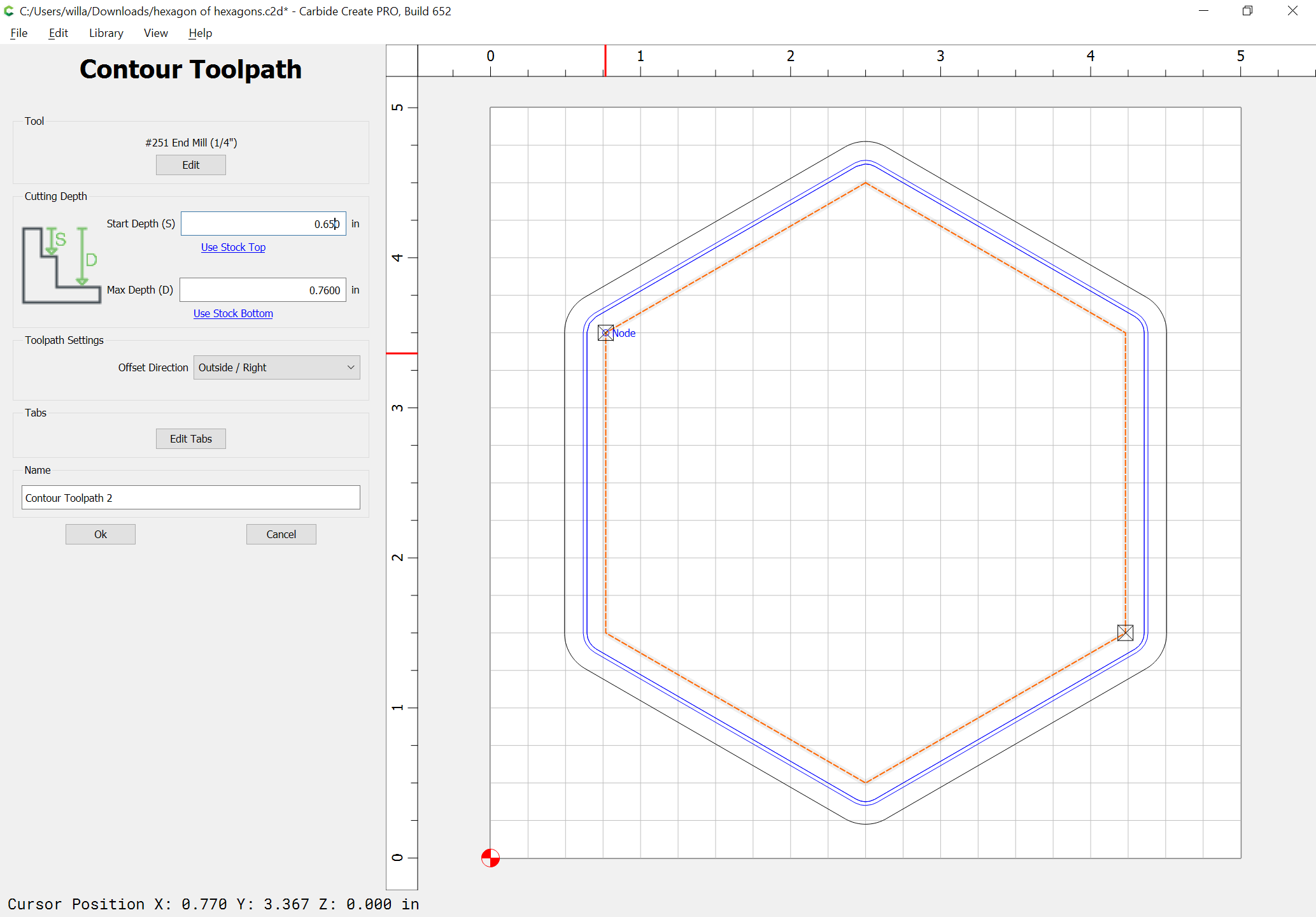

What is really obvious in your 2nd photo is that you are trying to cut too much in one pass. You are probably losing steps.
You have to cut in multiple passes so you don’t overload your machine.
Another thing to do to help keep a cut from overtaxing the machine is to minimize “tooling engagement” which is how much of the tool is involved in a cut.
If you have the machine lower the tool and begin cutting — that will result in a slot and is a “slotting cut” which has 100% tooling engagement, the worst possible cut to make on the machine and the most difficult. Continuing this and going deeper, say to cut out a profile just exacerbates the situation and repeats w/ an increasing amount of the tool involved in the cut.
To avoid this rather than:
Go back to the Design tab:
and choose “Offset Vectors”:
offsetting to the outside by endmill diameter plus 10% or more:
Then cut as a pocket down to tab depth or the penultimate pass:
and then finish the cut w/ an outer profile contour which starts at the bottom of the pocket and finishes the cut and which if need be has tabs:

Today I was in the shop and looked at my 2nd trail (the 2nd photo in the original post) and I put a piece of paper on the slot it was cutting when it went bad. I put wood behind the paper and drew a line on it using the top of the wood as a ruler. This is what I got:
There is a significant difference in depth from when it turned the corner to cut that one side of the slot and at the end, where it went bad. It goes down at an angle. That makes me think it’s either the G-code itself that does that or that the end mill is sliding down.
So is that something Carbide Create would do when generating the G-code, or would it cut one layer at a time? How hard is it to check G-code to see what it’s supposed to do?
I would put my bet on the end mill is sliding down - if the design is to cut at a given depth, the G-code will instruct the machine to hold Z as constant while moving X/Y. If the end mill is fastened, I would check if the spindle is fastened, too.
I tightened the spindle as tight as I could and this happened 2 different times. I’ve got a new collet on the way - one I could get delivered in a few days. If that doesn’t work, I’ll probably order precision collets. I’m also getting some good wrenches to use instead of the simple flat ones from Carbide3D.
I don’t know the G-code, but I’m betting, since it was cutting out a rectangle, it was cutting at one depth all the way around, then going down more at the start point and that it is NOT going down on a slope.
Carbide Create doesn’t do ramping in cuts, or cut at angles except for 3D toolpaths, so this was mechanical.
You can verify how many passes are being taken using the 3D preview — just turn off the view of the stock material for a clear view:
CC can’t generate that kind of ramping toolpath, so basically “no”.
This is quite easy and a very useful habit. I like using ncviewer.com, other folks use CAMotics, and there are a variety of other gcode viewers you can use in case of doubt
