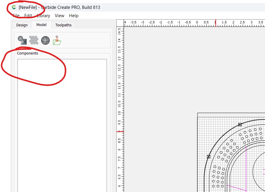

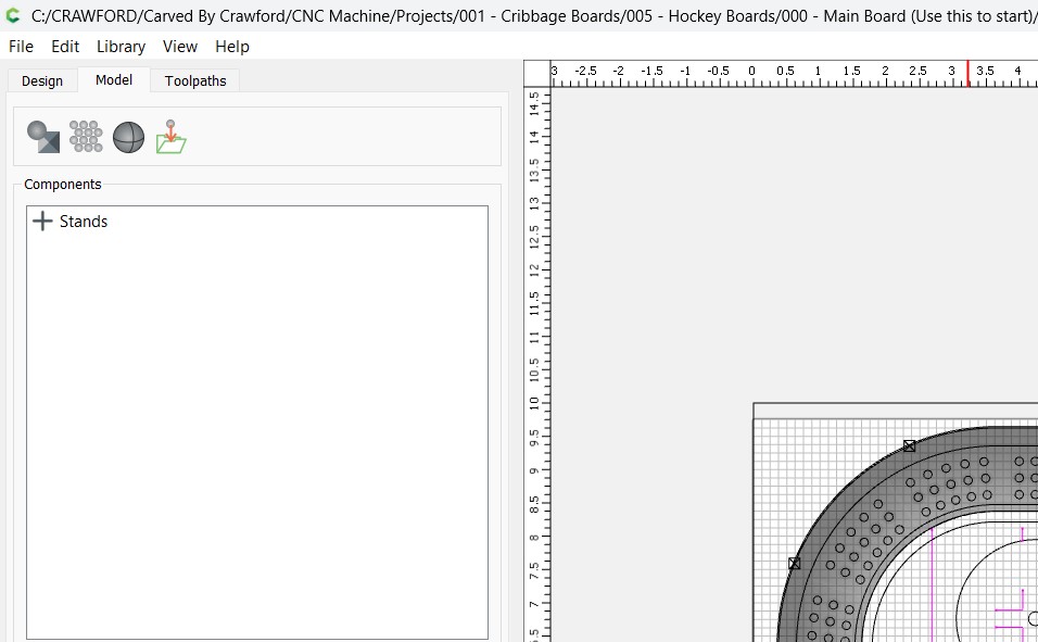

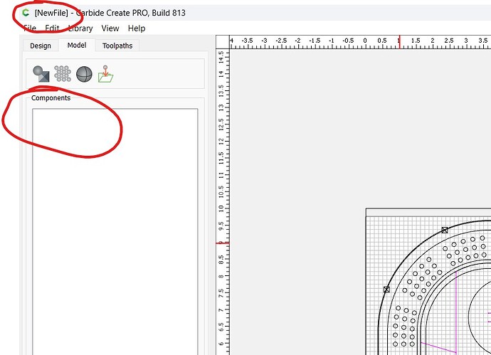

Updated to build 813 the other day. A 3D file of mine that I have used many times previously, no longer contains model components. Also, opening existing files now display as “new file” in the upper left corner.
Attached are two pictures of the exact same file. One opened in build 813 and the other in build 778.
Any ideas?

  • Files from prior versions will not load 3D components in V8. There were too many changes to the internal format for the new capabilities of 3D, and there was no good way to map existing 3D components into V8.

It will only result in lost data if the converted file in v8 is saved over the original v7 file.
