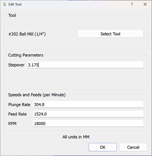

Set up 3D toolpaths with suitable tooling:
Note that for the 3D Finishing toolpath it will be helpful to adjust the default Stepover:
If the selected tool is not able to cut details, it may be necessary to use a smaller tool:
Iterate and adjust as necessary — note that when using small tools it will be necessary to take into consideration the interaction of cutting flute length and vertical features. Also remember not to skip sizes, e.g., before making a cut with a 1/32" tool, make sure to have a preceding toolpath w/ a 1/16" tool.
