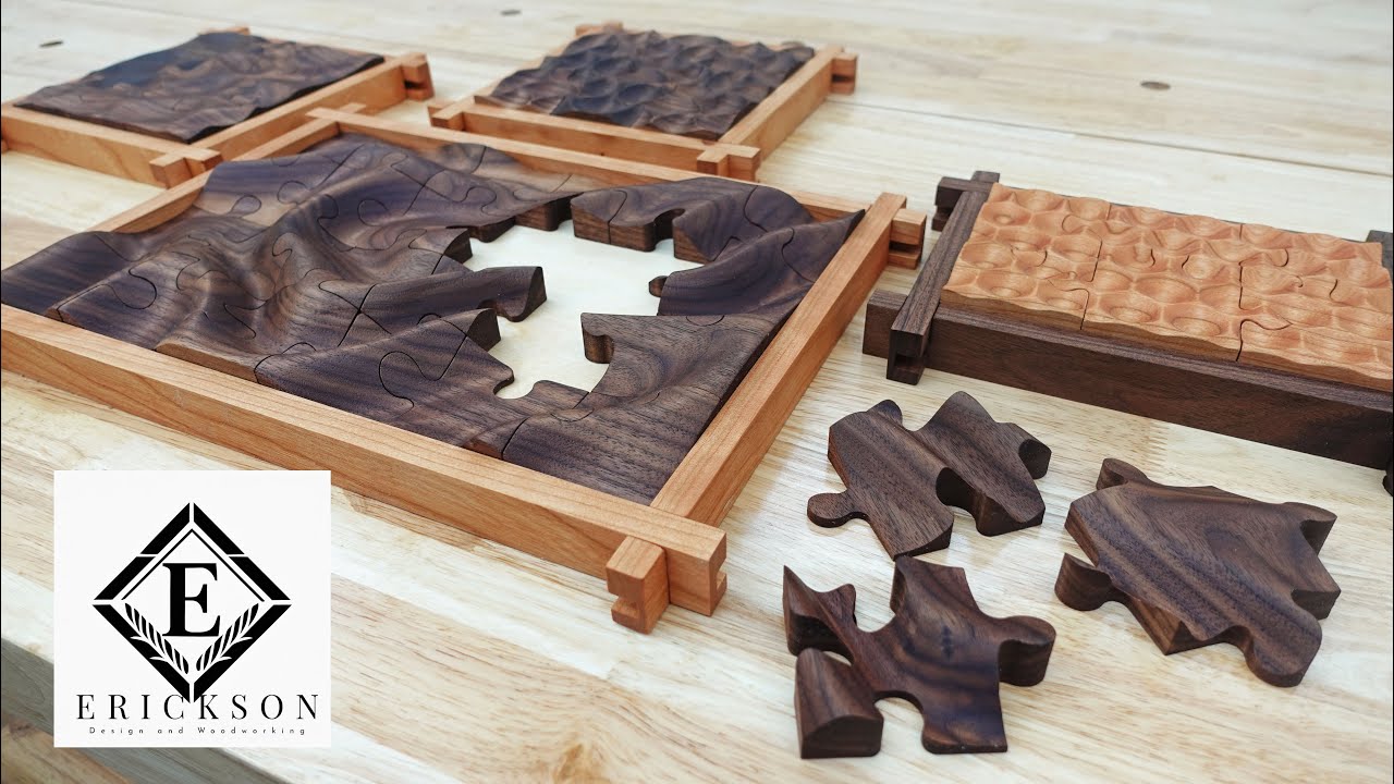

So a good friend asked if I could make a jigsaw puzzle out of wood for him with his business logo on it. I really liked the idea, but I told him what if I put a texture or curved surface on it to add to the dynamic of it as I thought it might be kinda blah. He told me have at it :nerd_face:
I have 5 different versions with the surface and sizes, I’m really liking this idea.
I did some test cuts to get the right tolerances for seasonal wood movement, not to loose and not to tight.
I ended up landing on this, about .01” space between the block edges.
I plan on cutting all the pieces for each set, total of 5, then assemble the puzzle, then cut the curved surface texture.
Should be pretty cool :sunglasses:
Cheers :beers: everyone!

@CrookedWoodTex not worried about the gaps lining up, I’m mostly worried about movement for each individual piece when I start putting the profile in. I ended up making a jig to snuggly hold the piece in the machine. The gap is super tiny, so as long as it’s close, the profiles will automatically align.
For those with a drum sander, this is my go to for cutting out pieces, or multiple pieces that require no cleanup. I no longer do tabs.
My last pass stops an .02” short of the bottom of the material.
The tape is not necessary, but helps me not having to assemble the puzzle once the material is removed. I’ve never liked putting puzzles together.
Into the drum sander taking off the remaining bottom material.
Removing the sliver of pieces is extremely easy by hand, and leaves a finished fine edge.

@CrookedWoodTex this is the jig I made to hold the pieces together. It’s pretty tight and I didn’t see any movement in the pieces. There were some gaps, but not noticeable with the top profile.

@CullenS im finishing the other 3 x 3’s today, they have a different texture feature for the top profile. One will go to him and I’ll use my laser to map the surface and laser engrave his logo. I’m a little nervous about mapping it as the laser uses a “laser” measuring system to pinpoint the area of the profile, if it hits a seam between the pieces, it will not measure correctly. I’ll have to really pay attention to that. For the larger profile in the previous pictures, that profile is a little to extreme to map.

Fun fact, the base is also a puzzle made to be put together :nerd_face:
I might just need to make a custom keepsake box for these.
