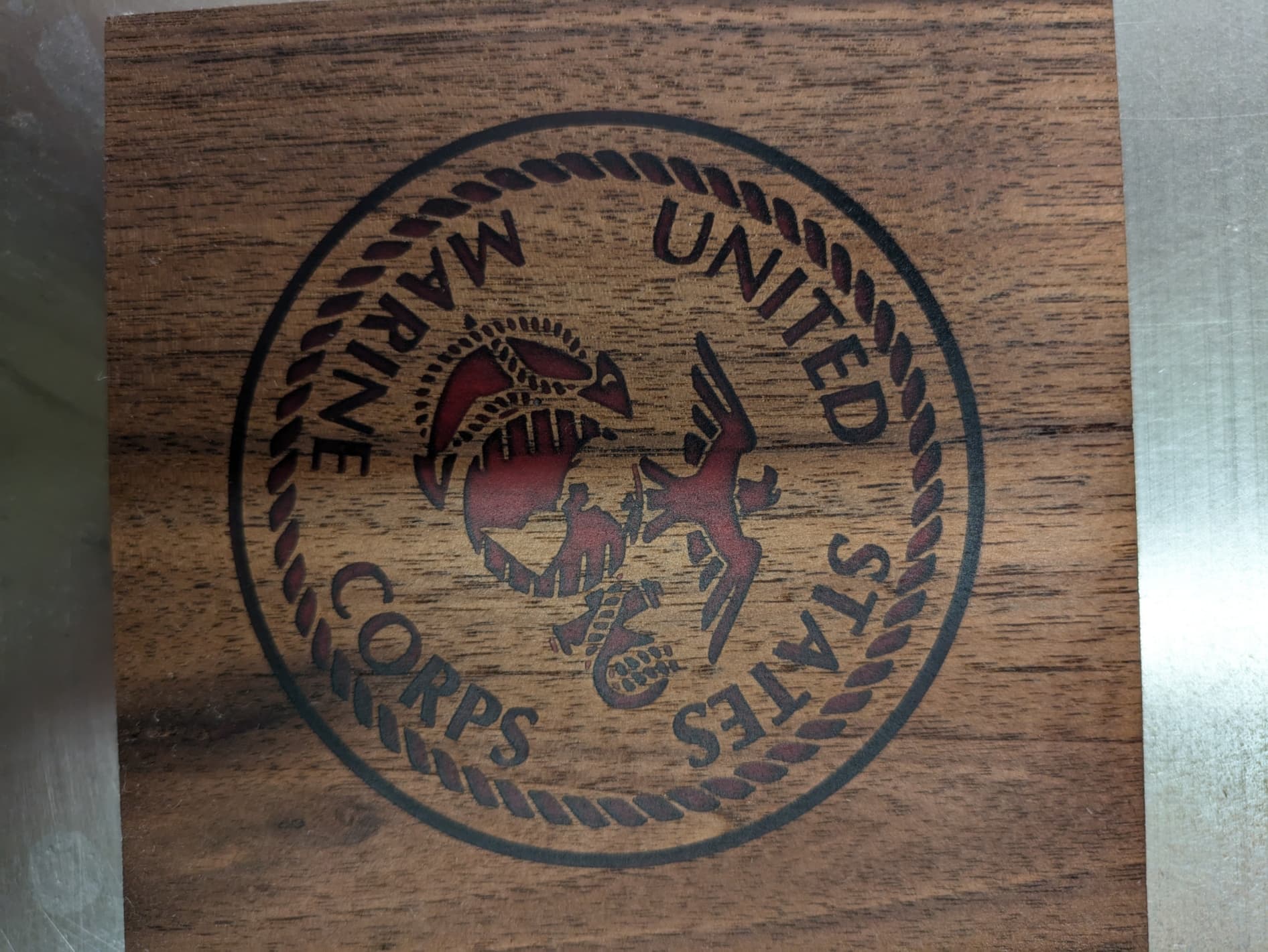

I imported the USMC anchor and globe svg but the eagle and globe don’t show up as being cut on computer model. Any suggestions?
Those are unjoined/unclosed/open geometry. It would be necessary to edit them so as to create closed shapes in order to use them for making 3D elements.

I have a post in the gallery about making an EGA and attached is the EGA I used. If you can use great if not find another.
usmc_seal_
This was an advanced vcarve I used as a test and filled it with epoxy.
Here is the test file used to carve this.
emblem_test.c2d (544 KB)
