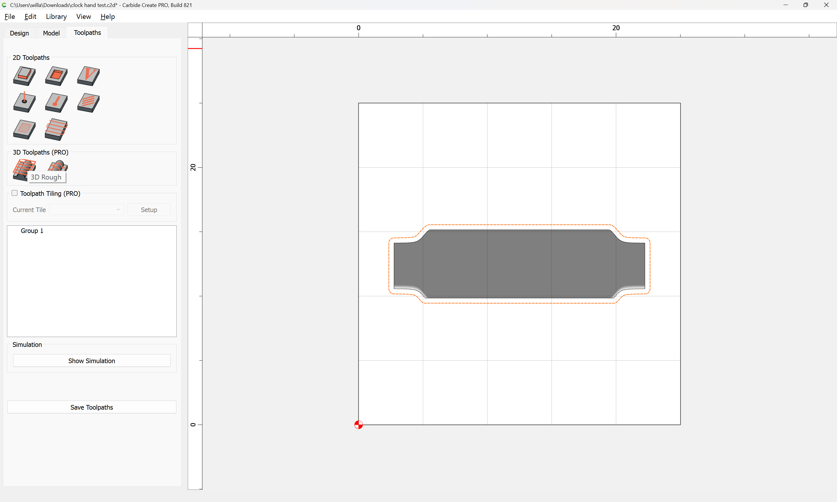

Hi there I just got the carbide create pro and have been doing test cuts on some wood with the 3d rough pass. I’m seeing odd gantry movement on any round contours, it’s sort of stuttering and isn’t smooth at all.
So I checked my bed alignment and did some simple circles in 2d contour and the gantry moves smoothly as it should on various tight and wide curve contours.
I’ve seen other people post this same issue on earlier versions of carbide create and they seemed to solve it by going to previous versions. Those posts are quite old now though and there are many updates since then.
The toolpaths look a little bit bumpy so I am wondering if the STL formatting might be causing this in some way.
The finish is okay and you can’t really see the result of the stuttering unless you look closely but it does require more sanding to get it smooth than I’d like. Any help would be greatly appreciated!

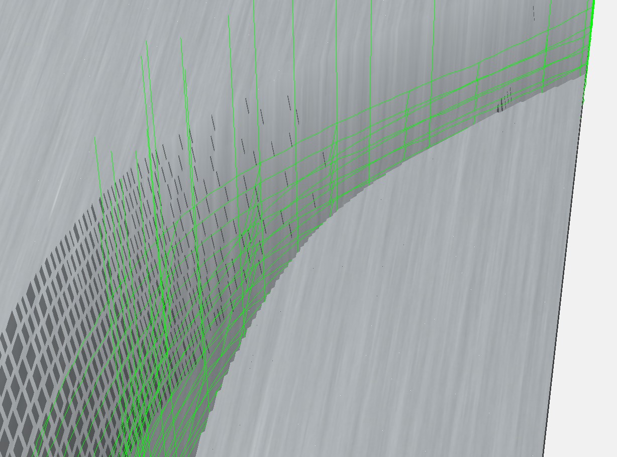

Here’s a photo of the tool paths I simplified so you can see the steps easier
Carbide Create converts things to polylines to make the math simpler — but it should be done with line lengths short enough to result in an accurate representation.

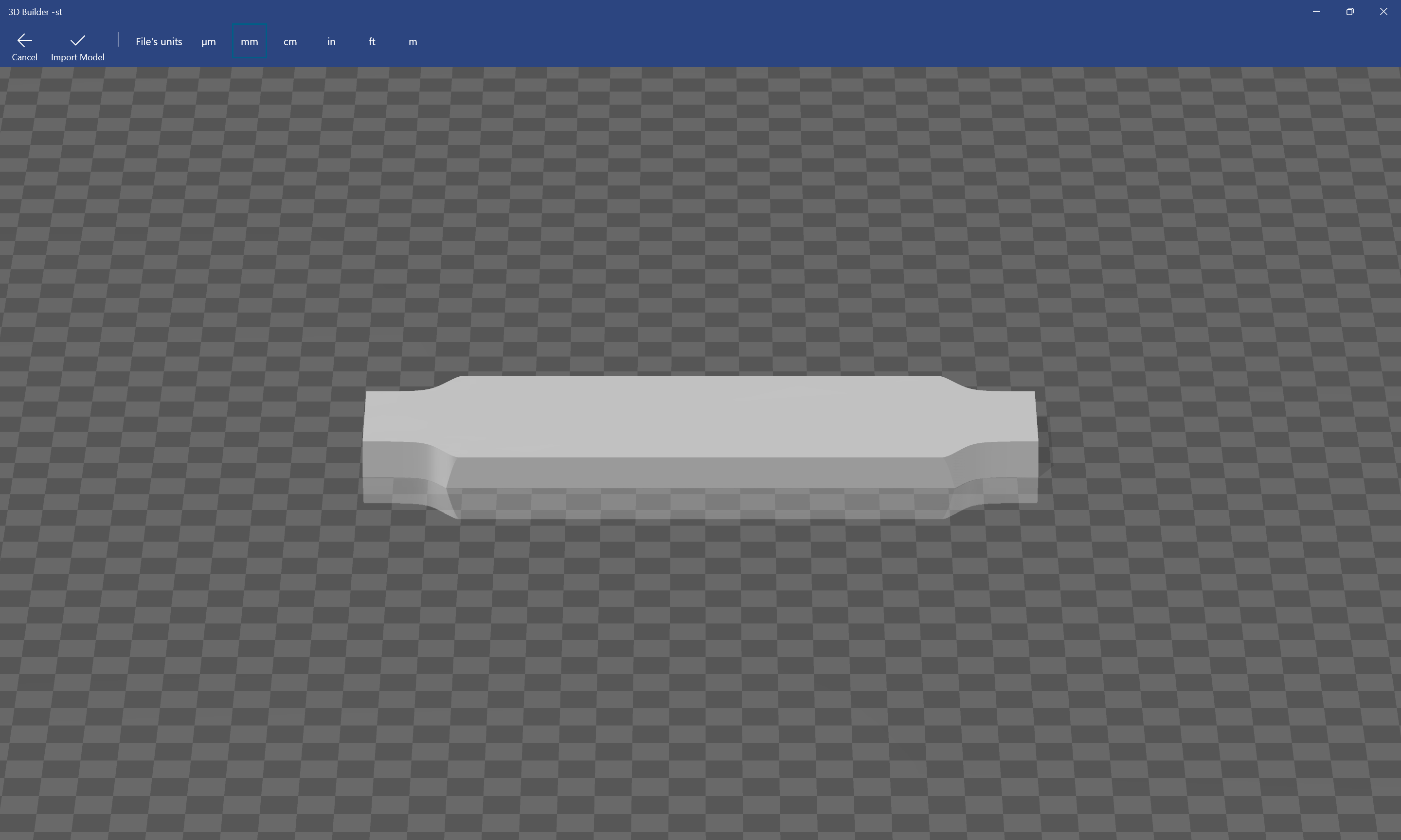

What does your source STL look like in a third-party 3D viewer?

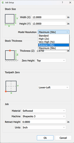

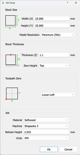

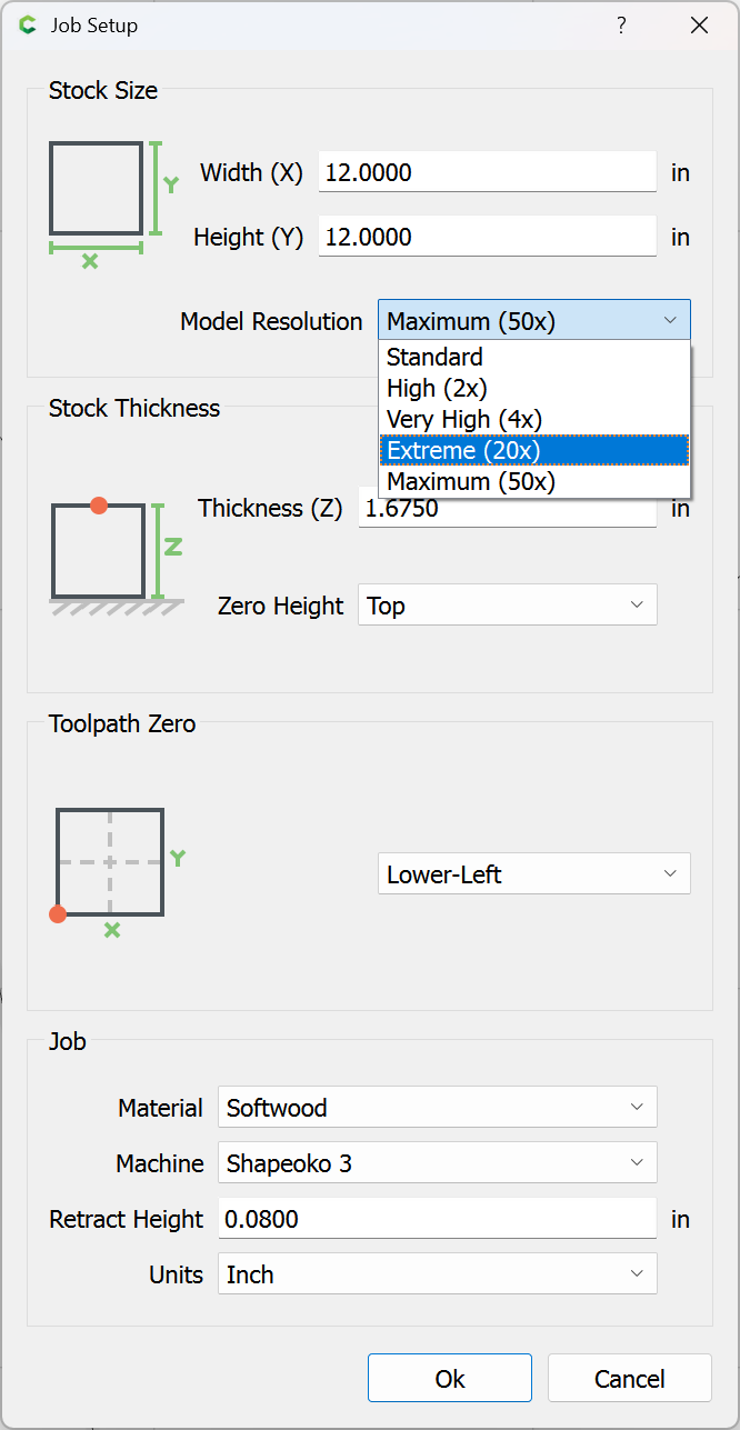

What do you have set for Model Resolution?

I just realized I have an older version of carbide create on this computer than the one connected to the machine (V7). I’ve downloaded 8 and will try again. I did notice that I don’t have the same model resolutions in the dropdown as you do, it only shows standard, high and very high in the latest version I just installed. I’m using Rhino3d for exporting the STL.

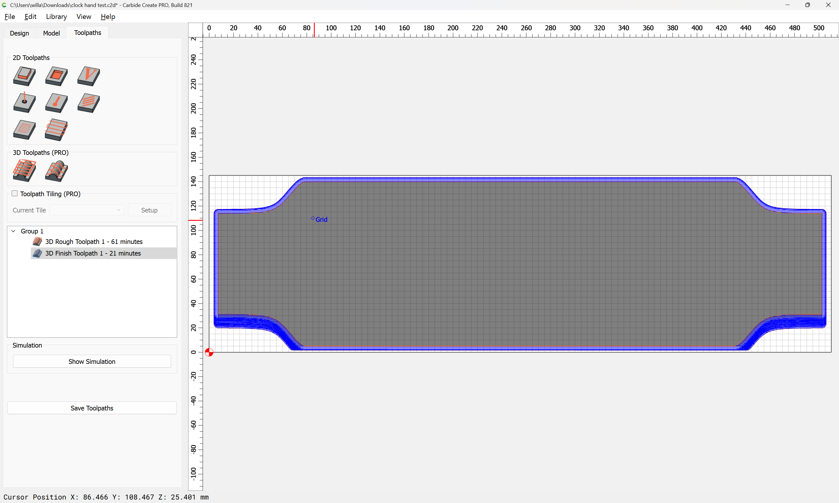

Here is the same file in v8 and the toolpaths look way worse with zigzags. (in any resolution).
V8 test.c2d (456 KB)
I just ran this program to see how the machine would react and it’s really moving around erratically now on the round contours. Way worse than the carbide create v7 stuttering issues I had.

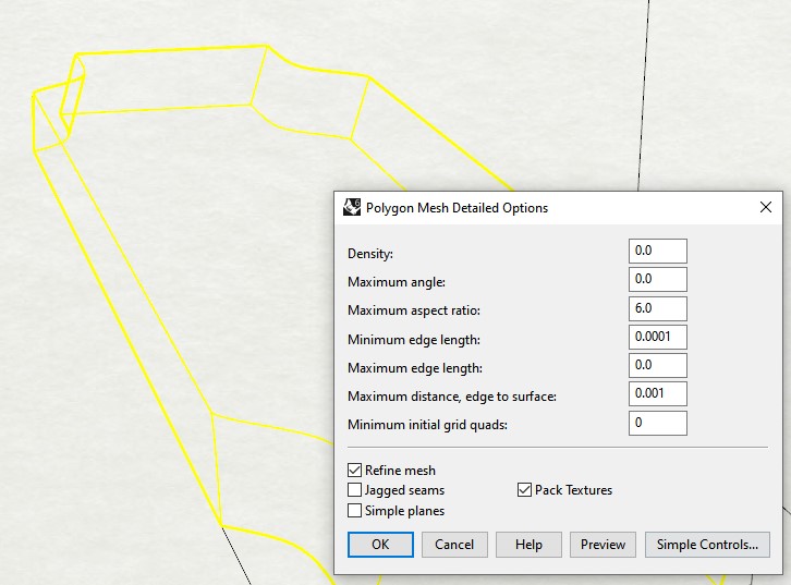

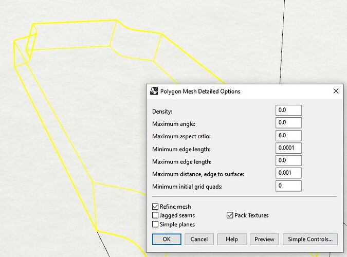

Here are my settings for exporting the STL if that helps

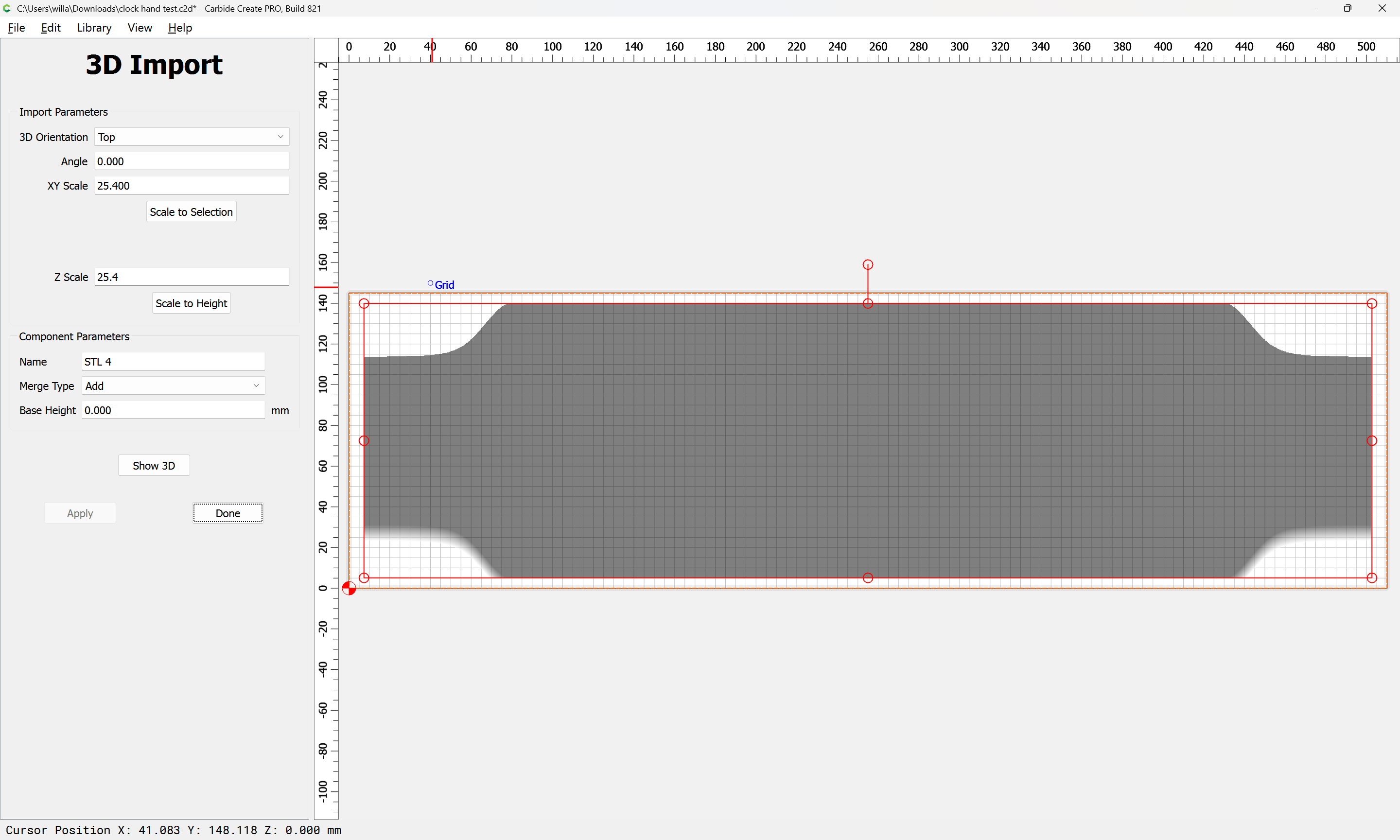

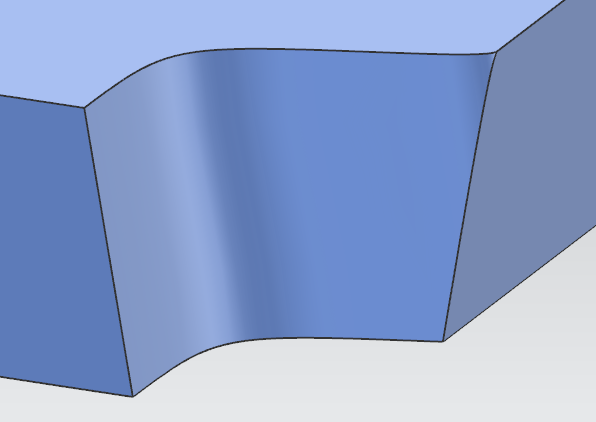

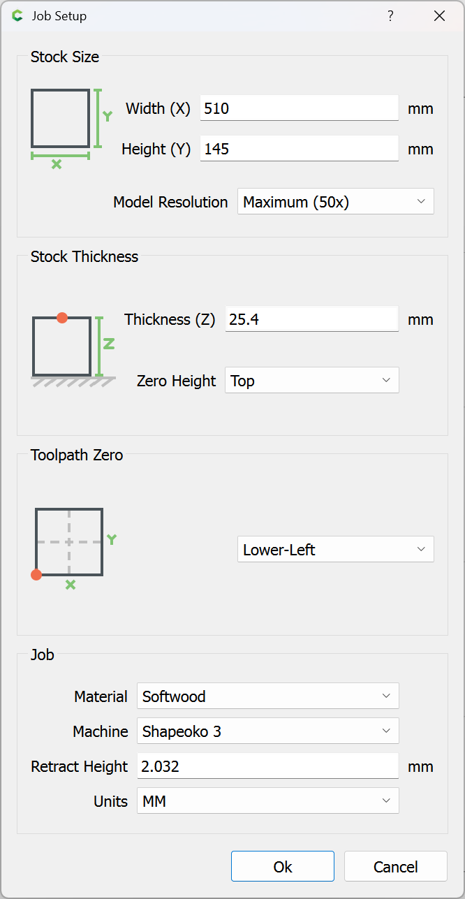

Okay, the 3D preview in a 3rd party tool seems fine:
Using the new beta of Carbide Create:

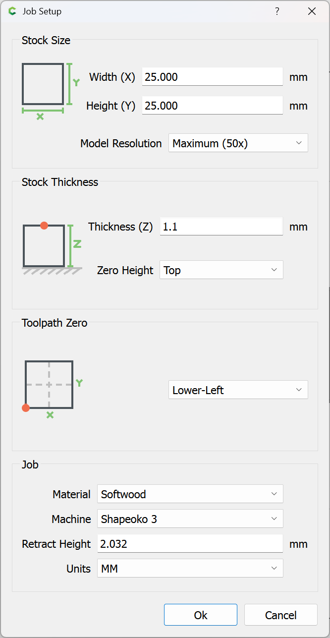

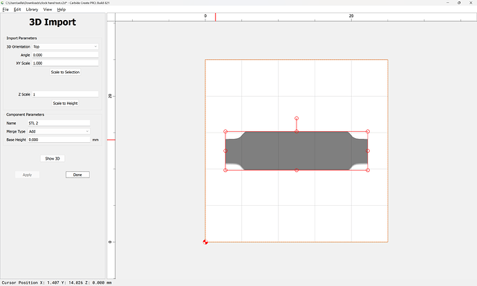

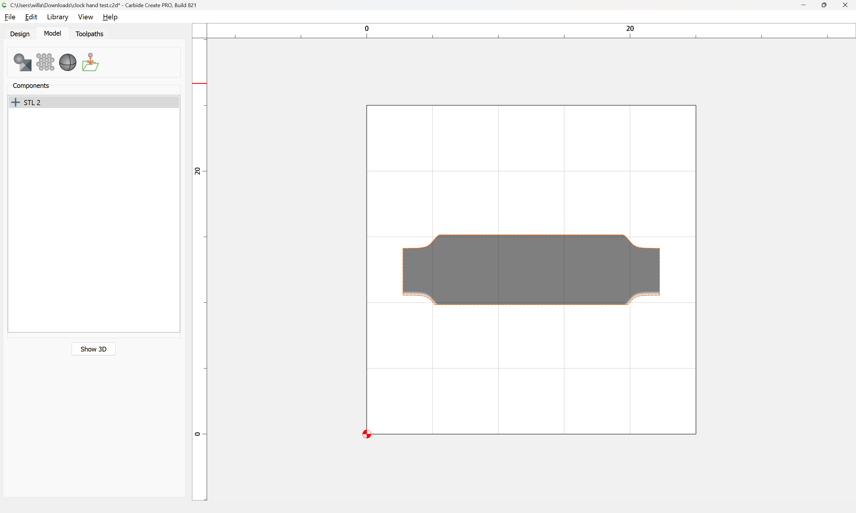

we have this as a very small part if mm are used for the import…
Setting things up to match the small metric size we get:

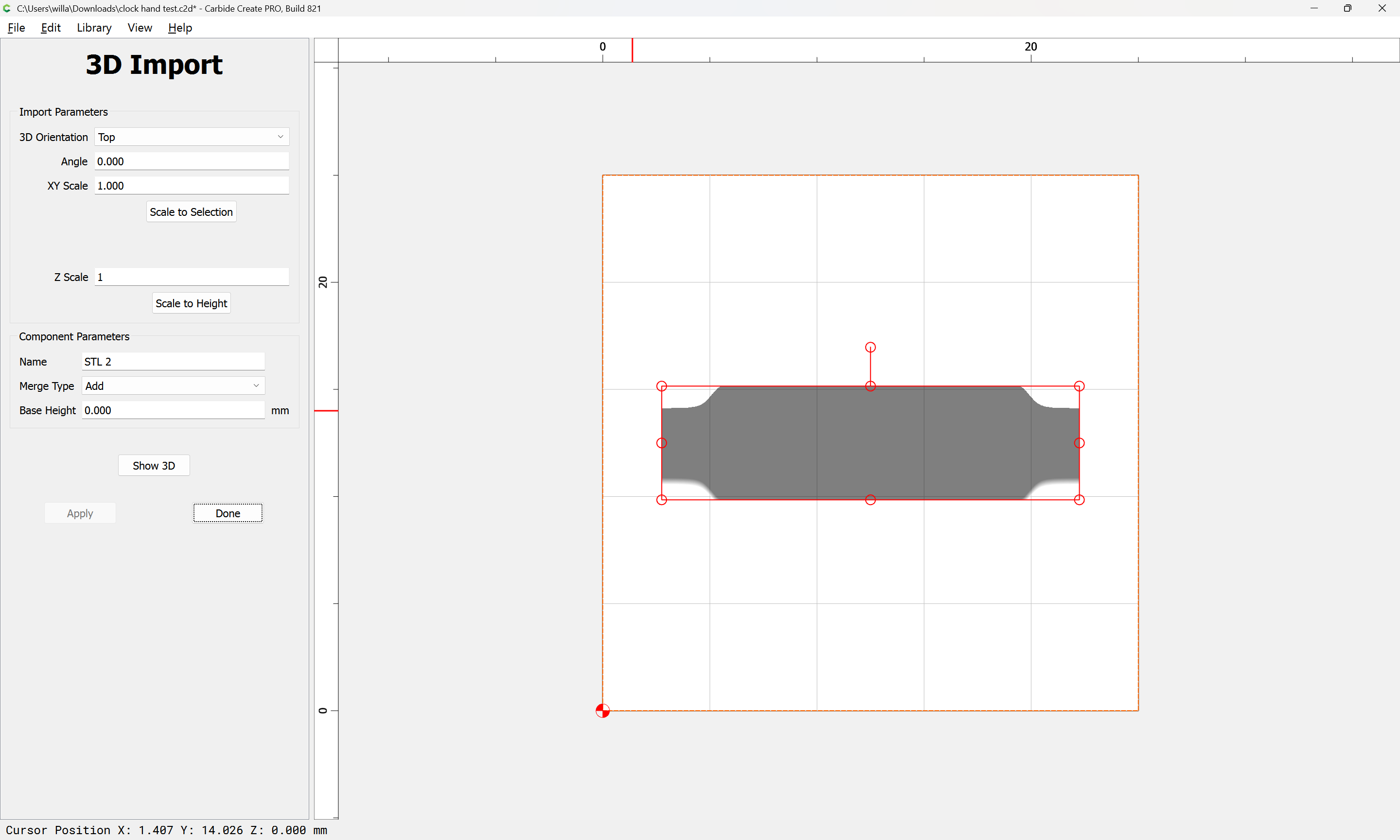

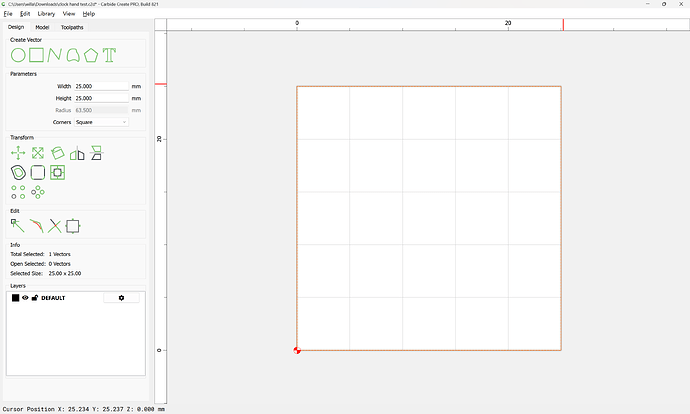

and we draw in geometry for the import:

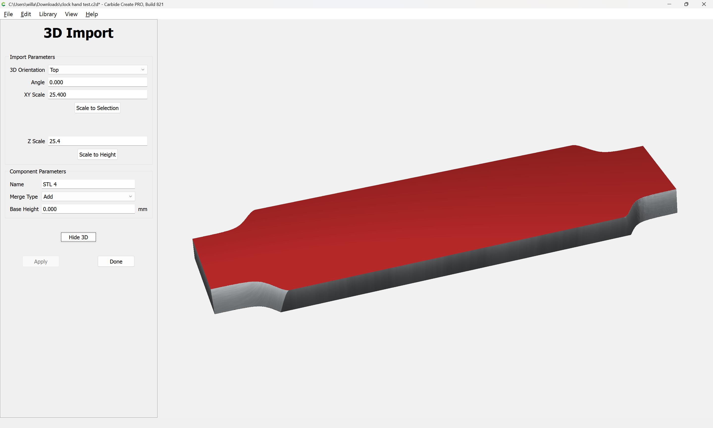

and set it to 1:1 scaling for XY and for Z:

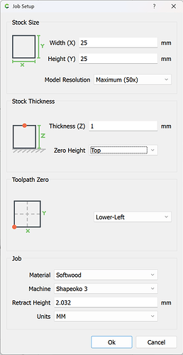

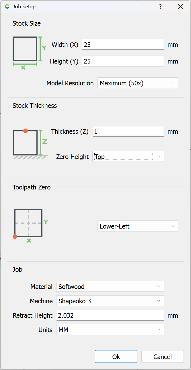

which seems to match (though the top is red which indicates it’s coming in at slightly more than 1mm — we edit the Job Setup:
and the model loses the red tint.

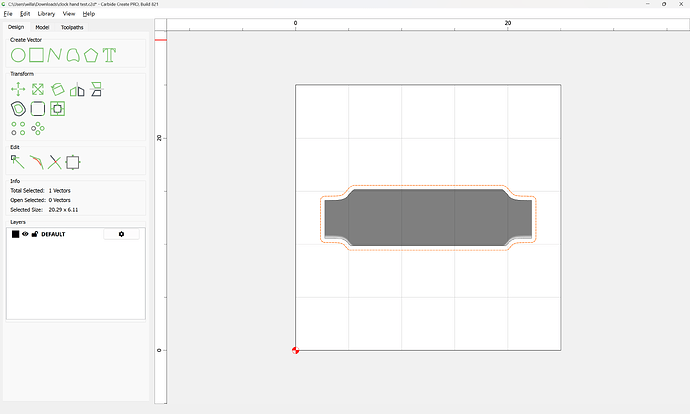

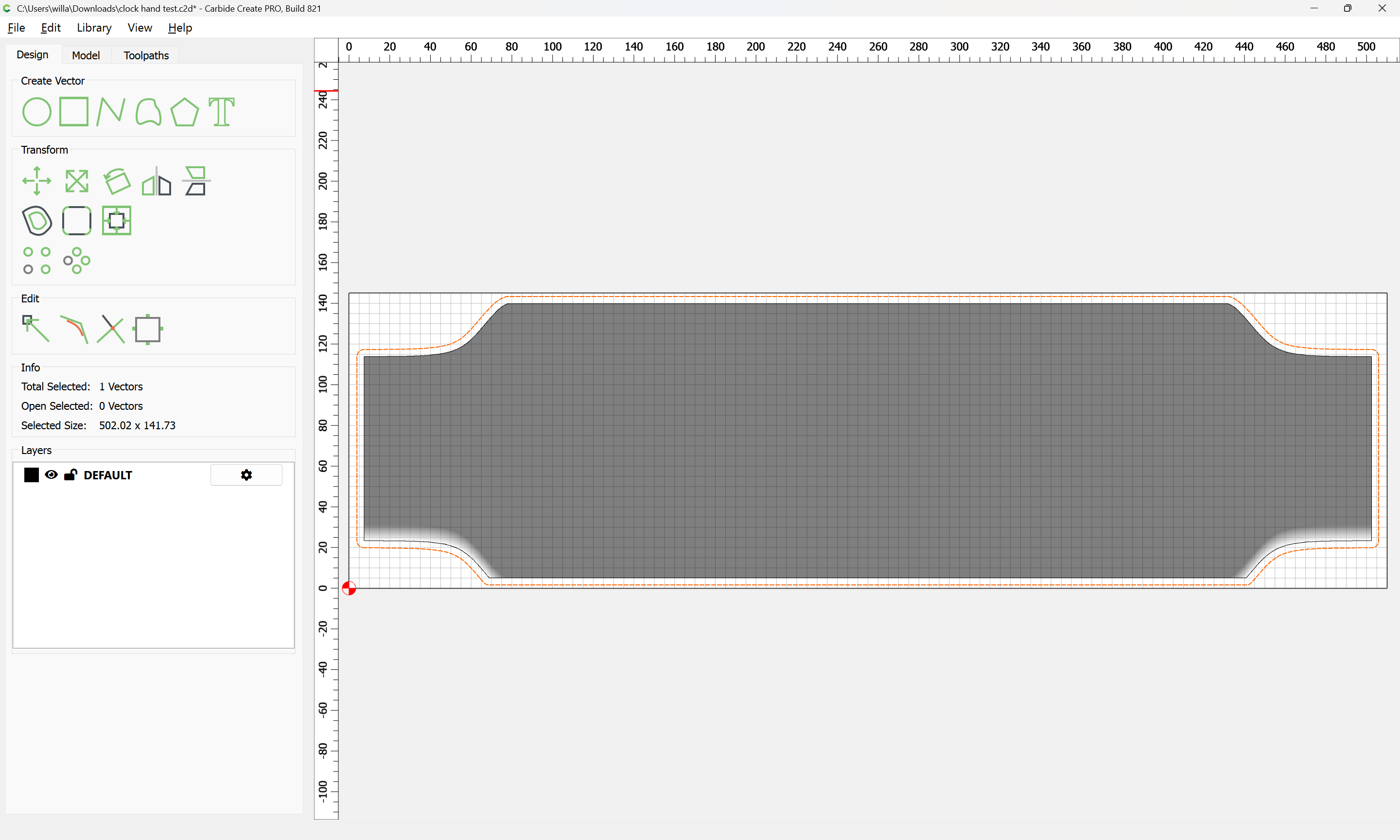

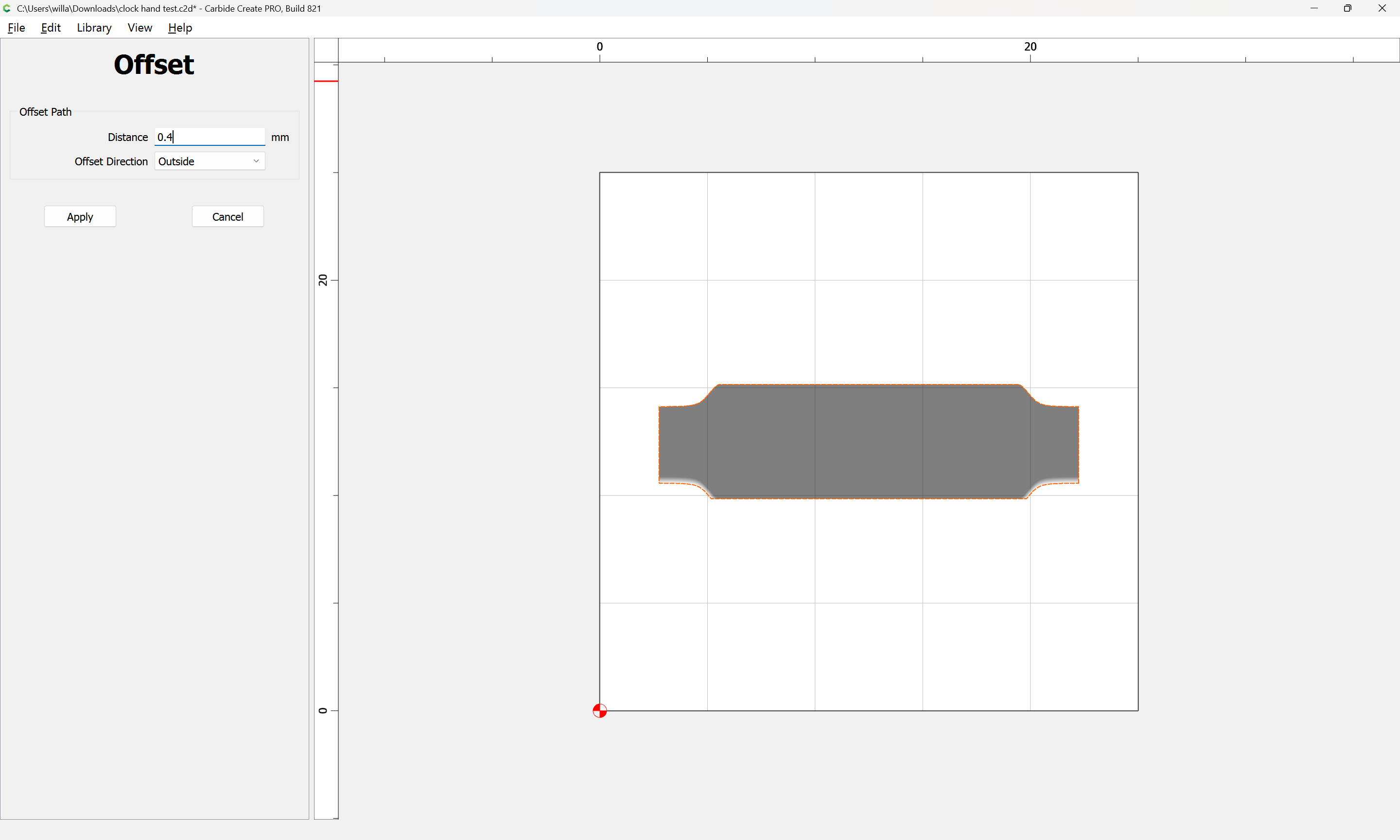

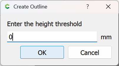

We then right-click and choose “Create outline vectors”
OK

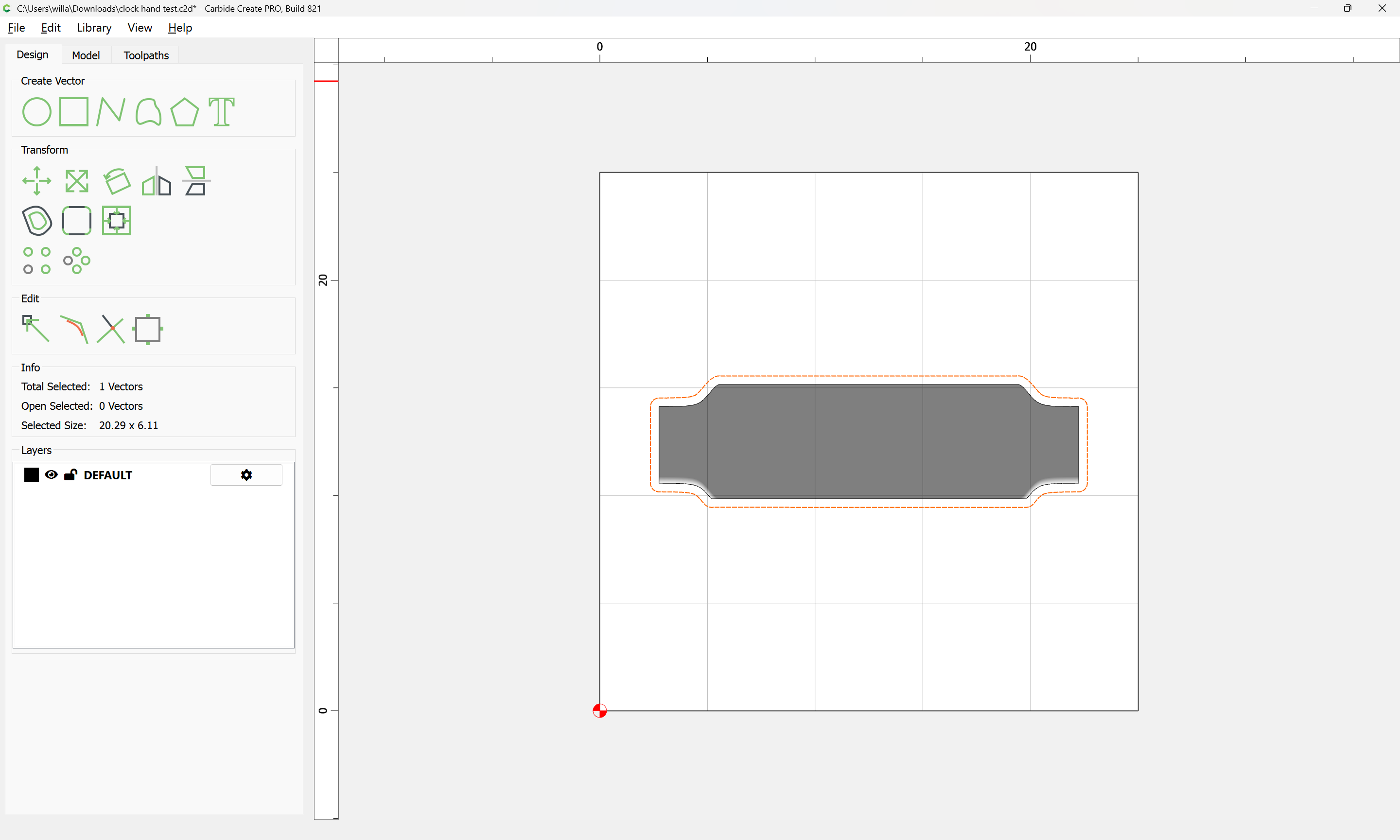

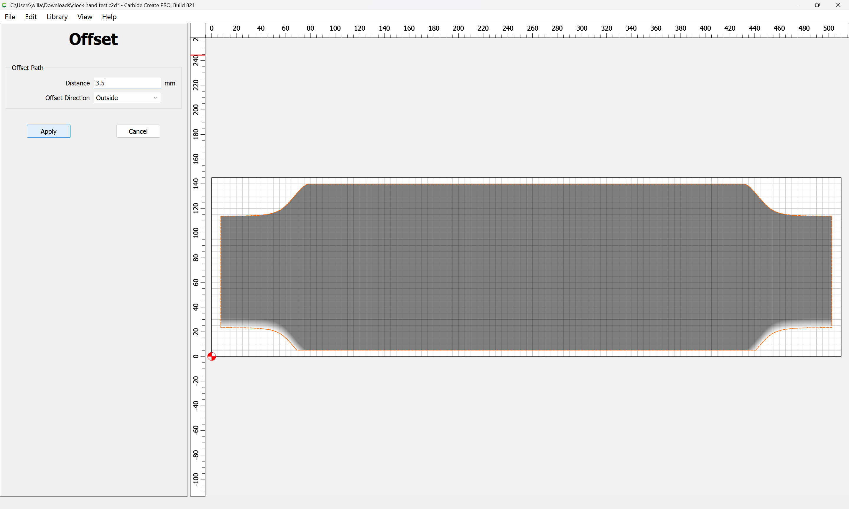

and offset by the radius of the tool which will be used:

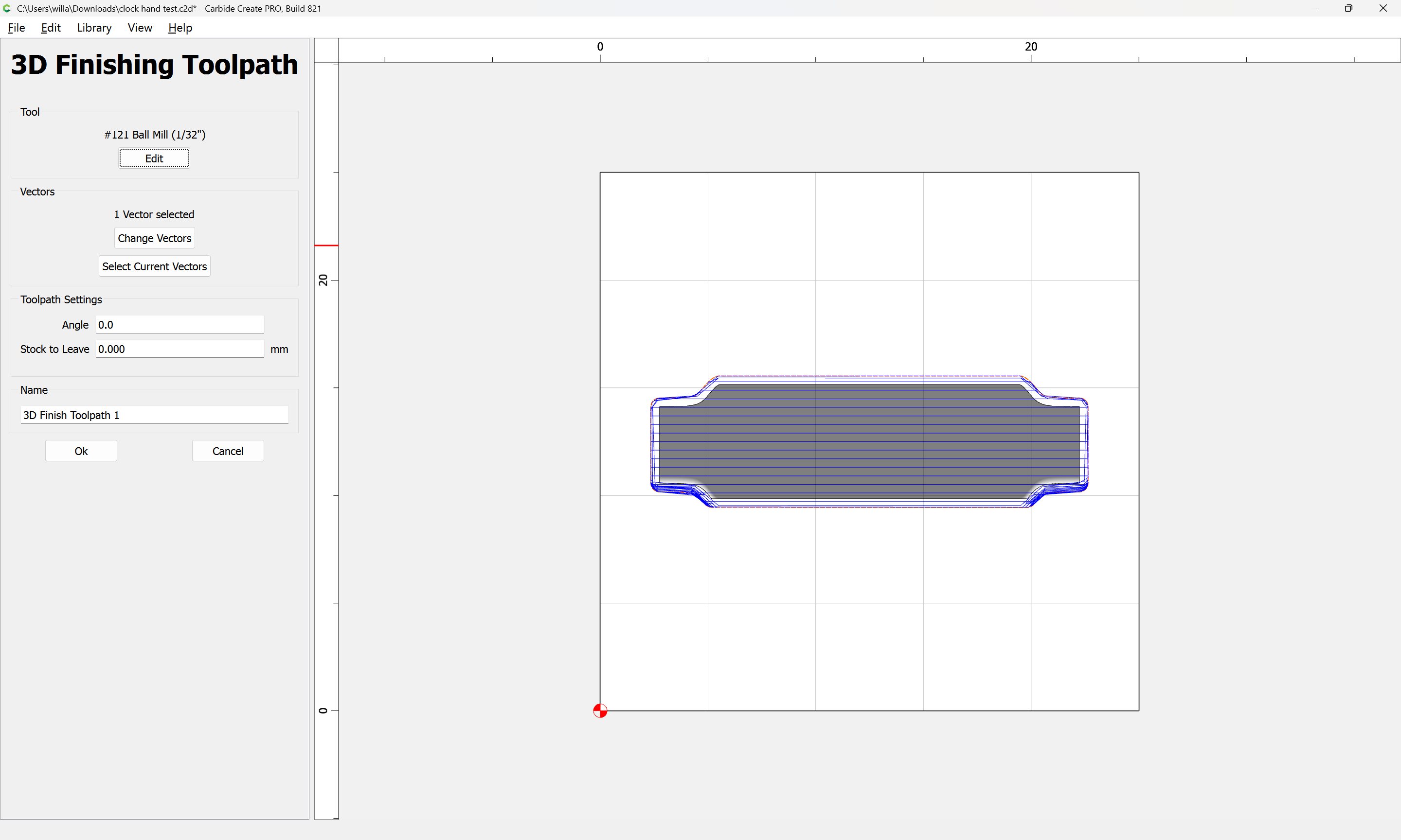

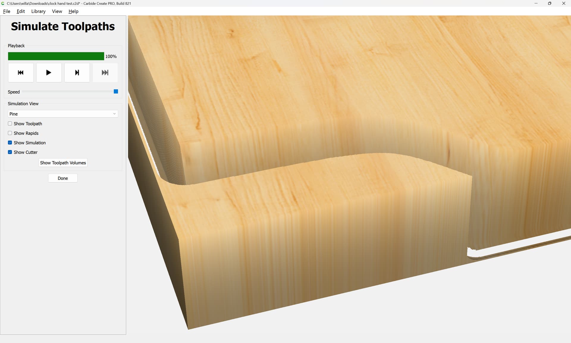

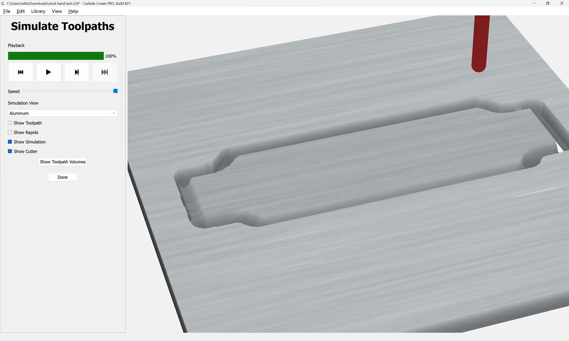

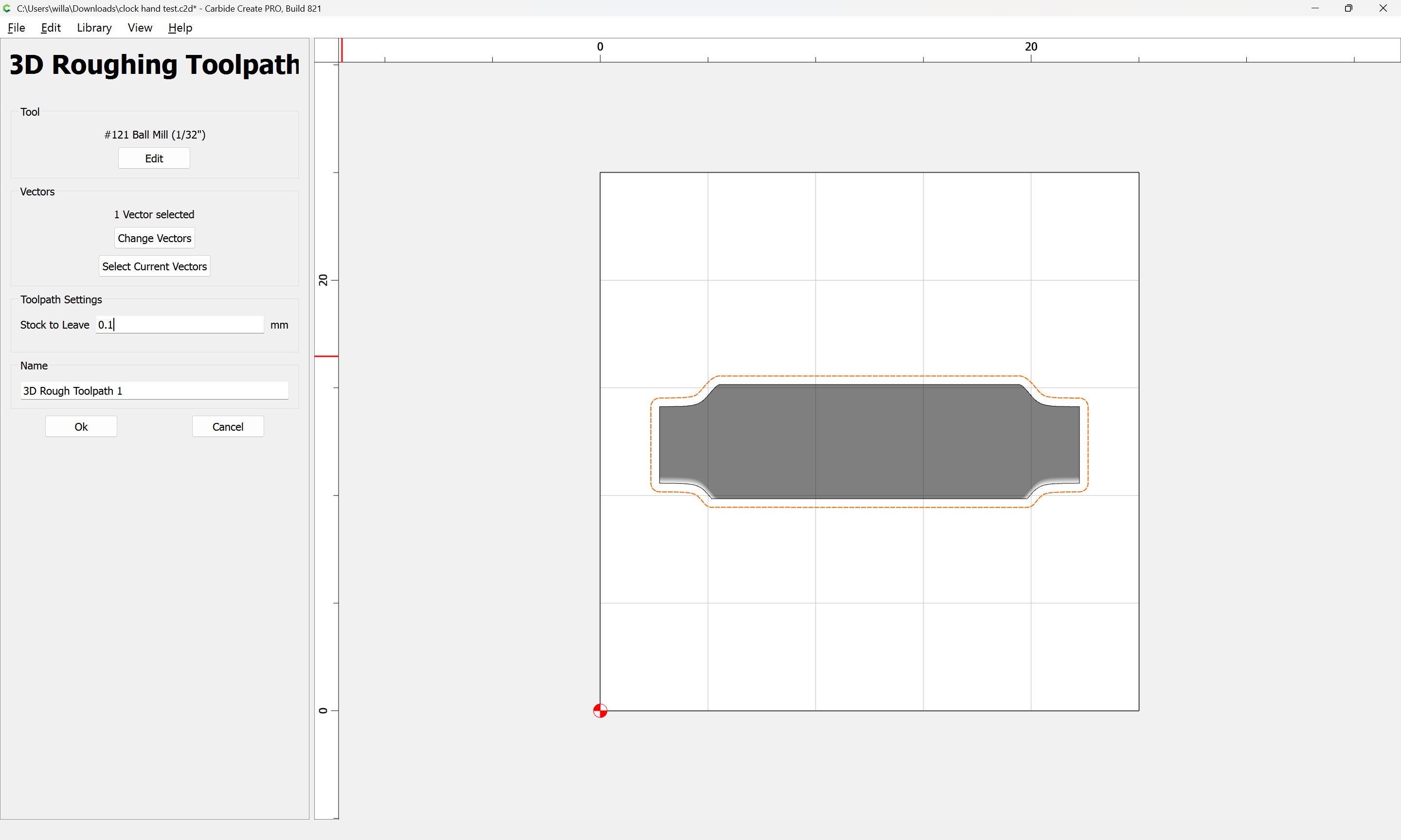

and then do a 3D roughing toolpath:

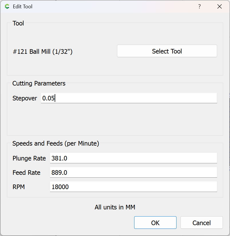

and then a 3D finishing toolpath, adjusting the stepover:
which has a pretty good preview:

I have everything set to inches I’m not sure if that will change what you did here? I played around with the export settings from Rhino3d by changing the maximum edge length to .1 (anything less and it wouldn’t compile the toothpath in ccp) The mesh preview showed a lot more contours in the export and I think that helped as the contour toolpath motion in the machine is much smoother now (not perfect but way better).

Should the file have been imported as inches?
If so, set the scaling to 25.4 (and increase the size of the stock commensurately):

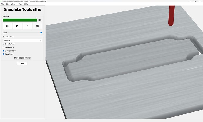

It appears that in the st_v8.c2d file you sent the simulation is not cutting in 3D. The path is straight down and not cutting the angles on the corners. It looks like the angle is there in the photo you uploaded though so I’m not sure why it changed on my end (in both rough and finishing pass it’s straight down).

I’m sorry, @ingotvein, I might have misunderstood your problem. It sounds like more than the CC curve interpolation. I’ve never used Rhino3D (my main experience is with SolidWorks), but looking at your STL export screenshot way above I see the setting Maximum distance, edge to surface which is set to 0.001. Just as a shot in the dark, that is R3D fitting tangents to the modeled surface, which will ultimately determine the mesh density as the local curvature changes. You might try tightening that number to 0.0001 and see how much of a difference it makes on your part (or even a test case, like an ovoid or egg shape). That is independent of the Carbide Create input, where Will showed the corresponding setting CC uses , I’m guessing when parsing an STL.
The STL looks pretty smooth in NX.

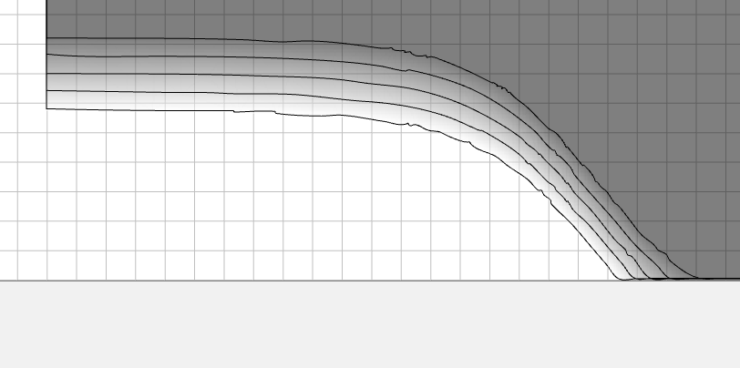

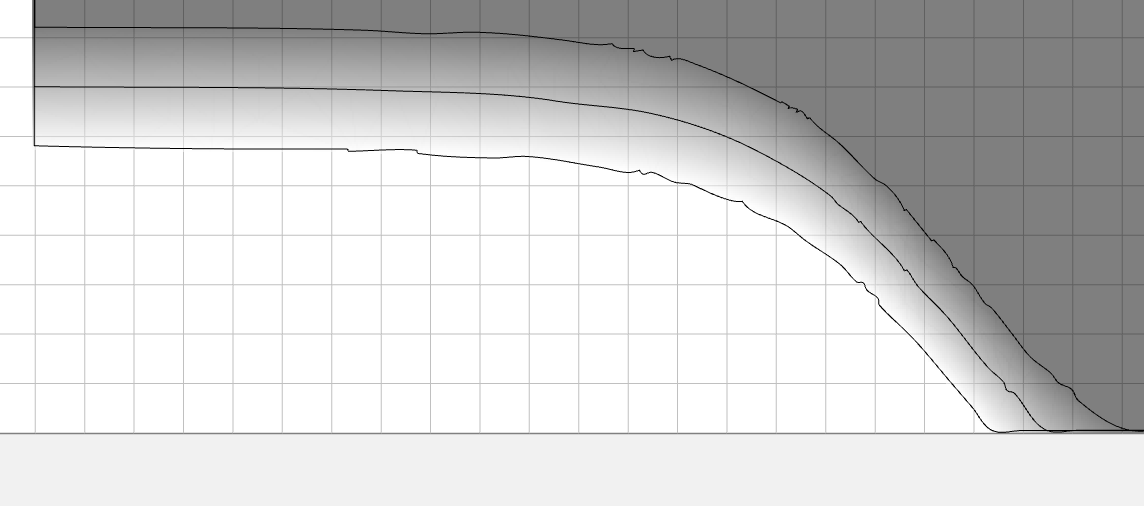

When CC imports a STL, it converts it to a 3D height map. Similar to a 2D bitmap, but with a 3rd dimension. You can see the edge trace after the conversion is not very smooth, and if you do another edge trace at 0.5" or 1.0", you’ll see it’s not that great either. It’s just the nature of the 3D format.
These are the same traces you will get with 3D rough path.
If you want precision machining, you’ll need a CAM system with a little more horsepower than CC.
