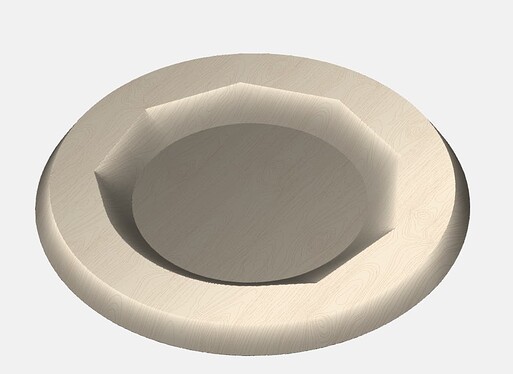

However, in doing my quick test, I did discover a quirk in the modeling. I made a base circle with a 9-sided polygon subtracted in it. The 2D view shows what you expect. But upon generating the 3D model, the polygon loses a few sides.
Tested polygon shapes below 9-sided & they all seemed to render as expected with all sides. But above 8-sided, it seems to reach a limit & create a curve in place of the sides it can’t handle.

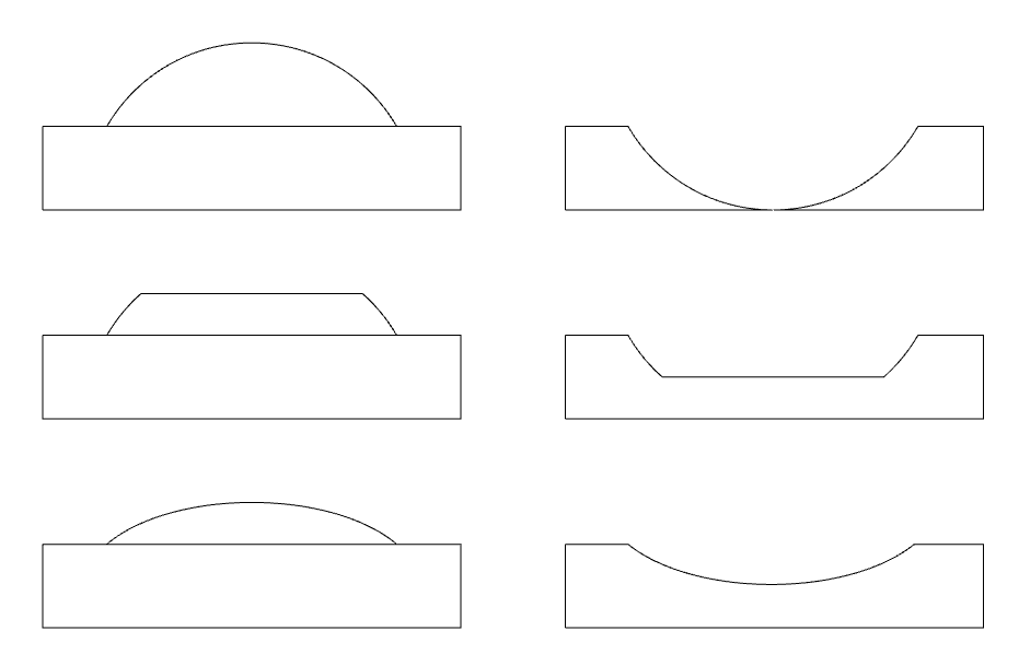

Check under “Height Limit”.
If I define an angled or round component, let’s say with a 45° angle, with no height limit, I will get a shape defined only by the angle. With a 45° angle I’m getting a quarter of a circle.
Top image is no height limit, add on the left, subtract on the right.
If I limit the height to something smaller, it chops it off at that height.
If I scale the height, it scales the whole feature down to that height.
Thanks, all of this makes sense. I must have been flailing all around the past few days learning about this software, and got myself confused. Now if I choose a height, and subtract, it works as expected.
