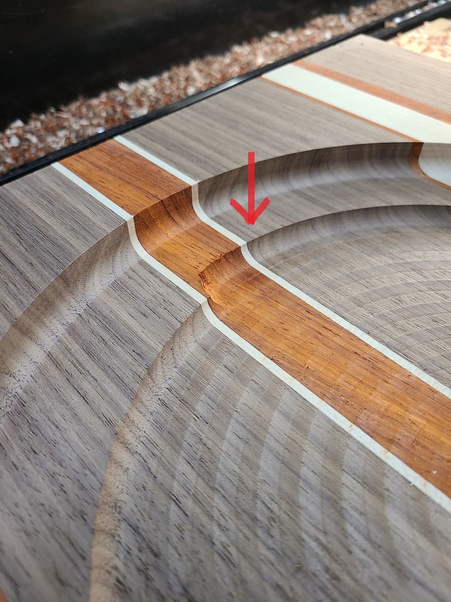

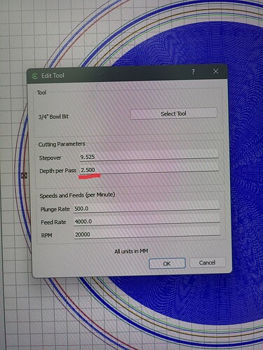

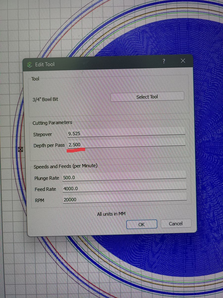

I’ve had this issue happen three times in the past couple of week. So far it has always happened on a circular pocket toolpath. I set my depth of cut for a 3/4 bowl bit to 2.5mm and the machine is actually cutting over 5mm deep. Here are some photos from tonight’s incident:
Tool settings

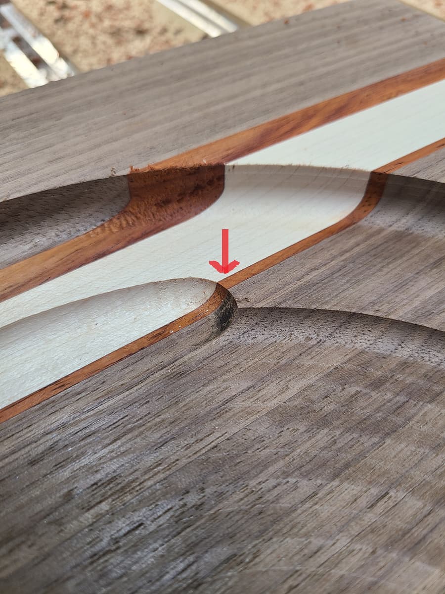

And two shots of the actual cut it made:
Note that the arrows are point to the cuts that it made too deeply. The level you see above that cut was done in multiple passes (DoC set to 2.5mm) as it should have been via the Lip Pocket toolpaths. As an added reference point, the thin strips of wood are 3mm wide.
I’ve checked and it is not that my bit is slipping in the collet. Any other thoughts on why my machine is cutting deeper than it is programed for? My file is attached below if that helps. In the below file, the Deep Pocket looks like it starts at 15mm instead of where the Lip pocket finishes (123mm), but is only because I made adjustments to it after it cut too deep. The original file started the Deep toolpath at 12mm.
