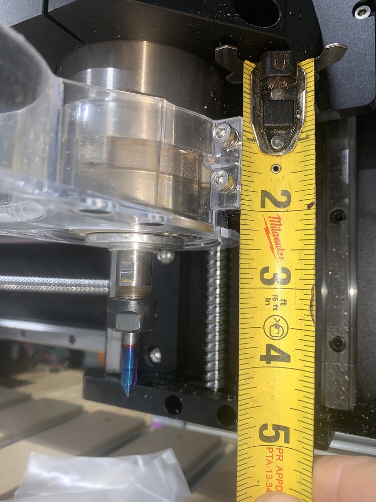

Using the shortest tool is unambiguous — inventory the tools you have, select the shortest o.a.l., see:
(for terminology see: Glossary | Shapeoko CNC A to Z )
The photo in the assembly manual:
https://carbide3d.com/hub/docs/65mm-vfd-spindle/
discusses this on pg. 10 and includes Figure 9:
which shows having roughly 3 and 1/8" inches from the bottom of the spindle mount to the tip of the nut on the spindle.

I sent you a clear photo of the exact measurement of my 65mm spindle so you could set yours and get cutting with the explanation that you can always adjust later if needed? The measurement is exactly what you’re asking for, set for the “shortest bit” you will start off with.
I have proven this measurement is safe for operation.
Why are you still having a problem with the height setting?
The height is somewhat relative to the thickness of the material.
I have to have almost maxed up to allow for the Sweepy and 3.5" thick material.
Most people have their router as low as it will go. The only reason to not have it as low as it will go would be on exception cases where you are trying to cut a tall object. The router can be loosened and moved anywhere you want. As @WillAdams shows above you want your shortest bit to be able to touch the spoilboard.

Since it was in a DM, I’ve attached it here in case it’s helpful to someone else in the community.
