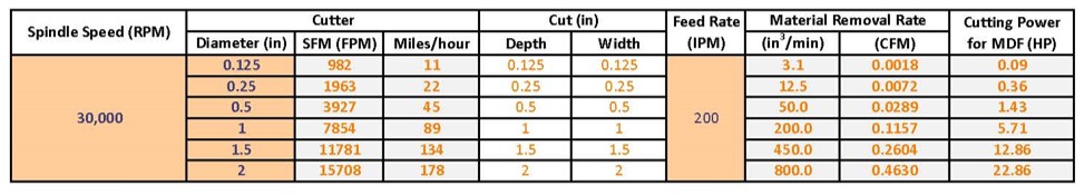

As shown below CNC routers can also generate high speed dust streams. Fortunately they don’t produce very much of that dust, so shop or other vacuums are well suited for use with them.
The following shows how my central vacuum’s 1" input, which can provide 13568 FPM (154 MPH) airflow at 74 CFM, compares to other vacuums and dust collectors.
Since my central vacuum uses two of the motors shown below in series, it has 12.38 in-WG more static pressure (suction) than the 48.62 in-WG pressure drop in the ductwork.
