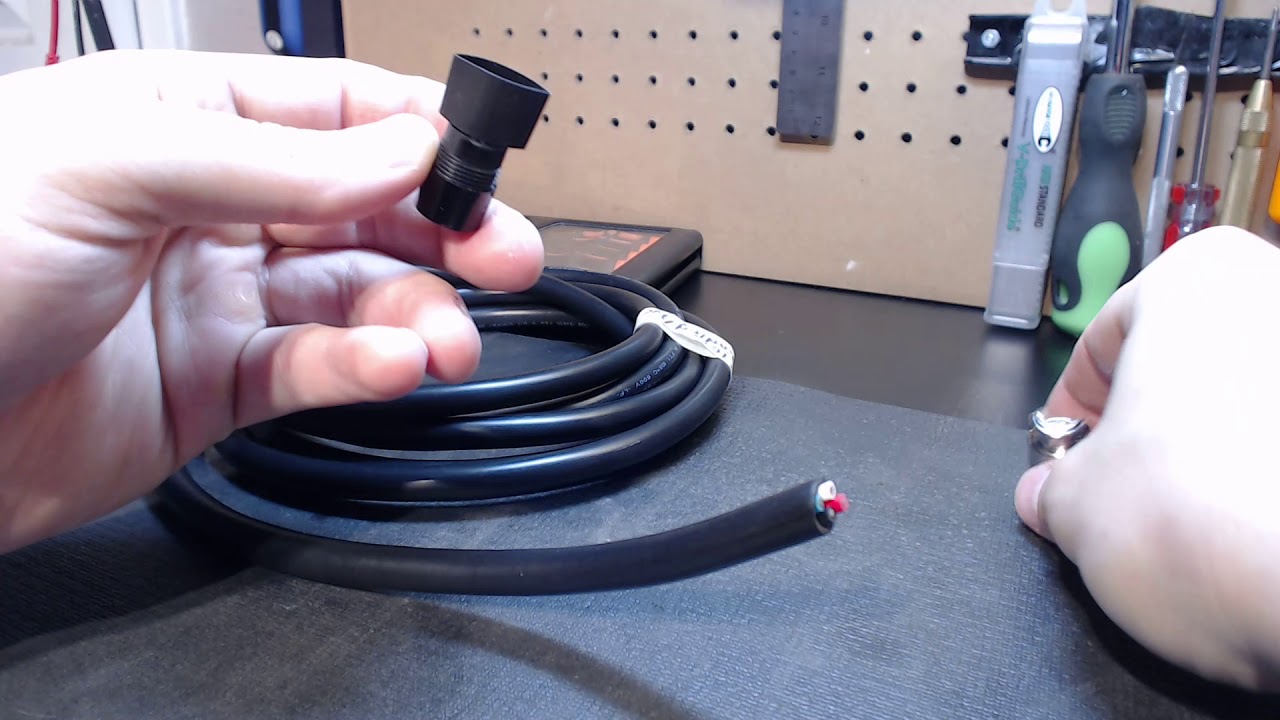

I am currently in the process of setting up my 800w Gpenny spindle. The electrical connector on top of the spindle that came with it is quite small. It is an H17-4 “aviation” style screw on plug. The wire I have will only fit into it if I remove the outer insulation and shielding. Even then, the individual wire insulation gets really beat up when inserting the wire because of how tight it is. I looked for replacement connectors and could only find more of what I already have. How has everyone who upgraded to a spindle dealt with this problem? Here is a picture of the connector and wire:
I got my wire from here:
I also have some shielded 18g 4 conductor high flex wire that I could use but it still has the same issue of not fitting.
I cut off the crimping portion with my Dremel and then used F4 self fusing tape to wrap it up after putting it together.

I saw other threads here where this same issue was discussed, the conclusion being to source a more slender cable that does fit. This was my solution when installing my GPenny 800W spindle, and it has been rock solid. https://cpc.farnell.com/pro-elec/pel01680/cable-cy-4-core-0-5mm-50m/dp/CB20789?CMP=TREML007-005

I am at work right now, but I can take some pics of what I did to my connector to get the Belden 29501F wire to fit. But basically, I cut off the tapered portion with the screw clamps, then ground down the backshell and then rounded the edges of the backshell until the VFD cable conductors fit inside it.
Then, I used F4 self fusing silicone tape to put a couple of wraps around the wiring to make it a snug fit in the backshell.
I then wrapped the ground shield around the outside of the backshell and then wrap it tight with F4 tape and that’s it. My spindle is shielded and I don’t need to put a ground wire on my bits to zero, because the spindle is grounded.
That is some rather large cable. Is that what the manufacturer recommends?
It is high flex 16 gauge shielded motor supply wire. I selected it based on the max spindle amp draw of 7A at 110V. 18 gauge will also work but it is only slightly smaller.

Edit 16 gauge is 1.3mm square which is, as the OP says, rated to 3.something Amps only. Seems that cable has a lot of insulation and screening weight around it.
This particular insulation is rated for 1000V and the shielding is braided making it pretty thick. For those wondering how I got to 16 gauge, here is the math:
