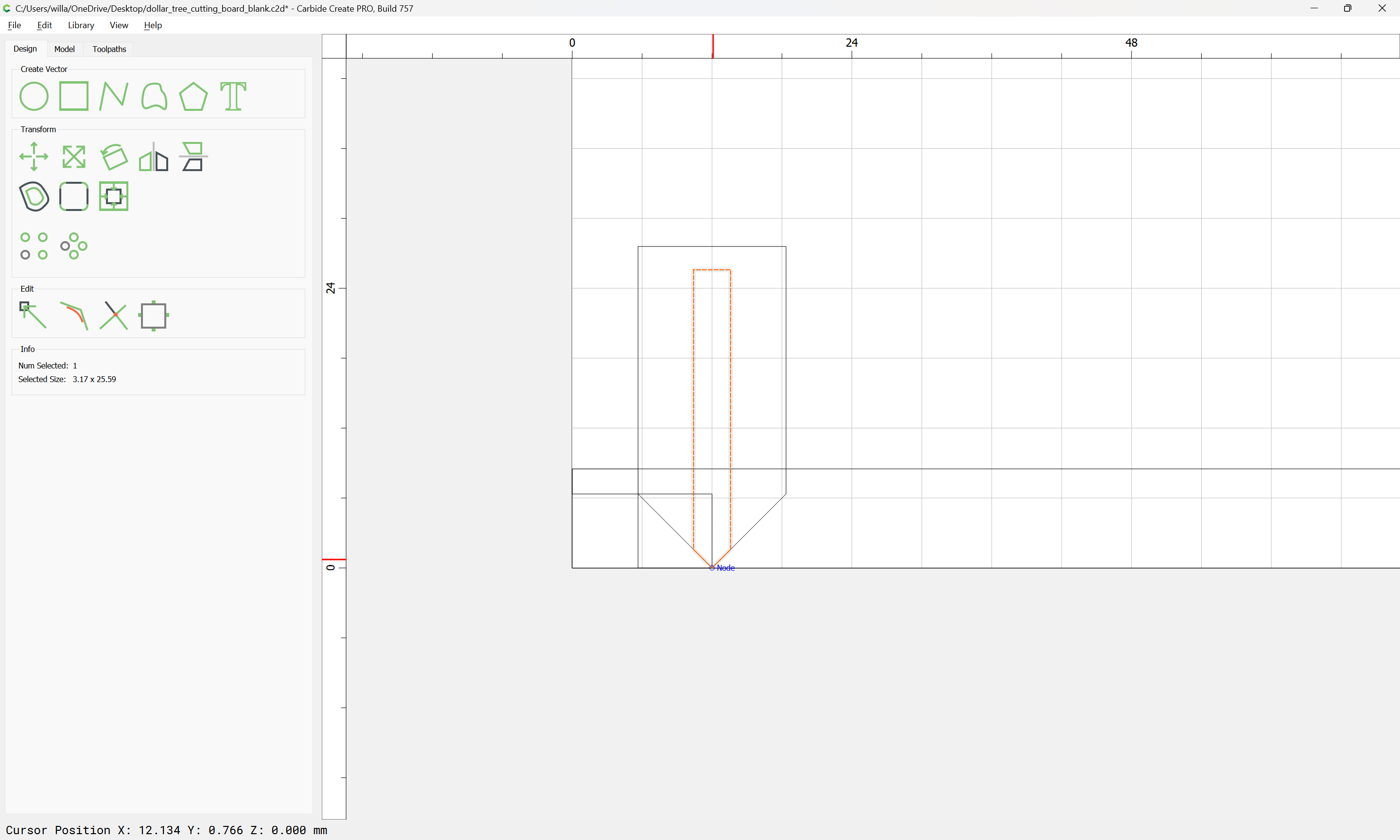

Zooming in after arranging the profile of the tool we see that we will need to cut
2.15mm deep to meet up with where the V endmill stops cutting the miter.
Measuring the tool we get half its diameter as the distance where that will be inset:
So we arrange things to show this and the other necessary geometry — the central cut with the smaller V tool:

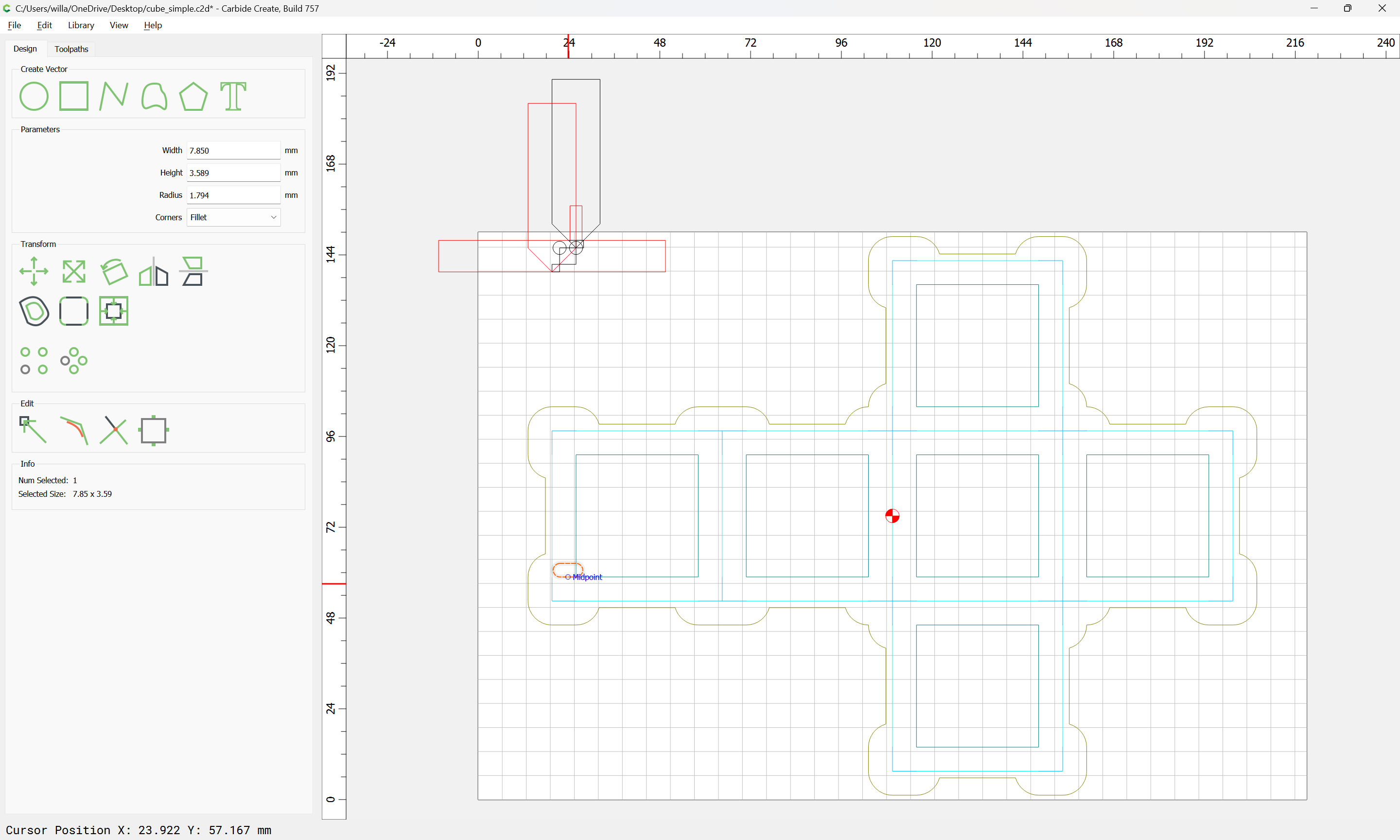

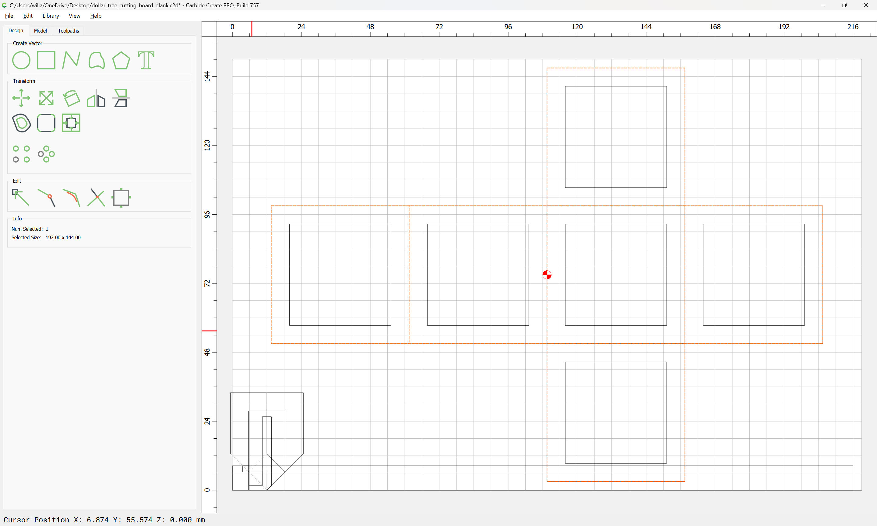

Draw up the geometry of the box:
and inset each part by the radius of the large V tool:
Select all the inset geometry and assign a no-offset contour toolpath to the requisite depth w/ the large V tool:
While it should work to just assign a no-offset contour toolpath to the part outlines, drawing in geometry which efficiently describes the regions in question is an interesting topological problem:
Assign a no-offset contour toolpath at the bottom of the stock using the narrow V tool (note that it will be necessary to ensure that this is cut last):
This geometry should be sent to a hidden layer and if need be locked so that it will not interfere w/ selections:
Draw a square which has dimensions which match the Stock Thickness:
Go into Node Edit mode and Cut the vector:
and then delete the nodes which do not describe geometry coincident with the contour of the part:
Assign a full-depth No-offset contour to this geometry using the large V tool:
Duplicate, rotate, reposition, and if need be, edit for conciseness:
which will all cut as:

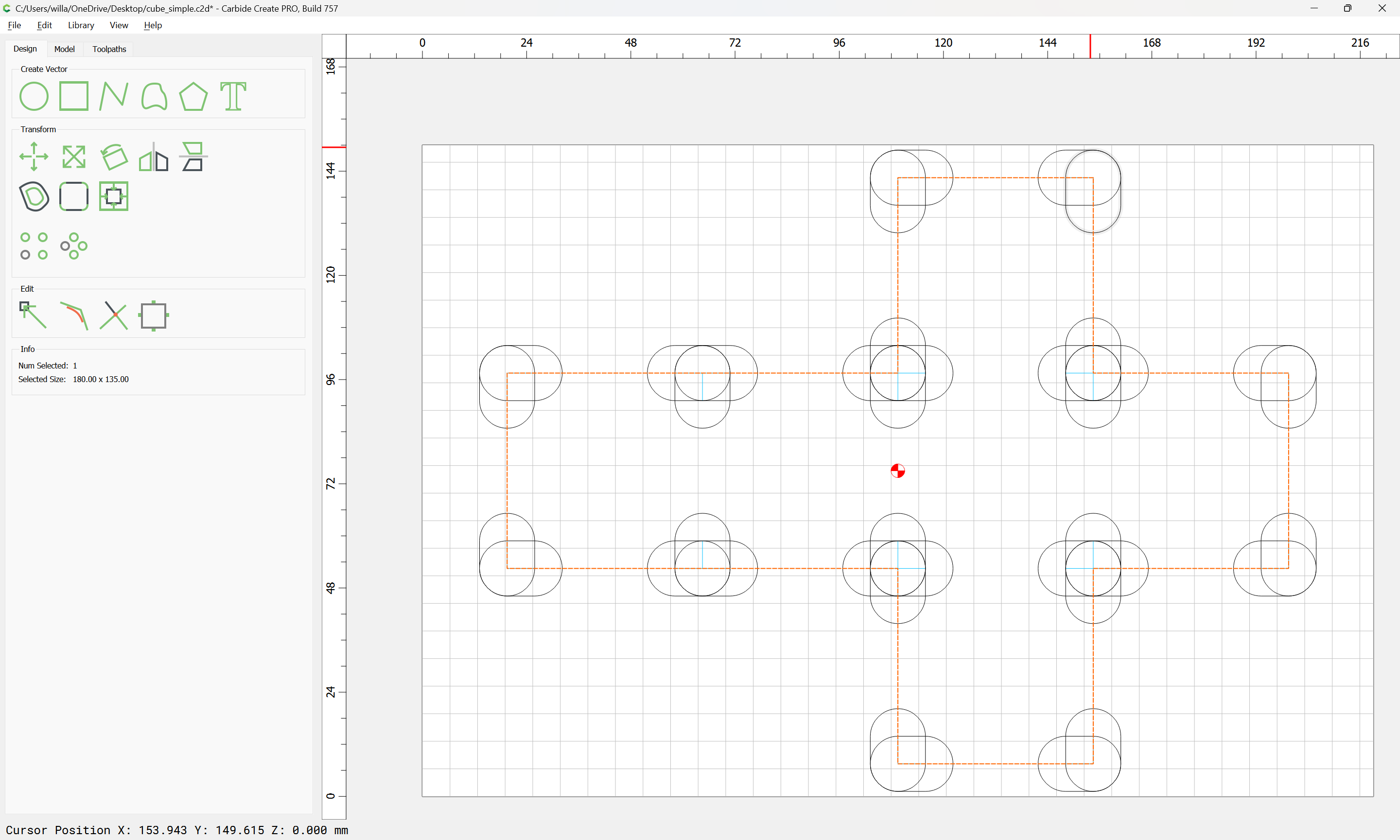

Next we draw in geometry which describes where this will cut 2.15mm deep.
Move things to appropriate layers, and then draw in a circle at a corner:
We check the dimension which the large V tool is cutting to:
and then draw a rectangle that height, and as wide as the tool:
positioning it so that the center will cut along where the V endmill cuts.
Then add the diameter of the tool and round the corners:
and duplicate and rotate and reposition a copy:
Then duplicate and place on all corners:
and add additional copies of the rounded rectangles as needed:
hide everything else, select all the circles:
and delete them.
Then show the corners and draw in the outline of the parts:
and offset to the outside by the smaller V endmill radius plus 10% or so:
Then delete the part geometry, hide everything but the rounded rectangles and the offset outline and Trim Vectors:
and delete unneeded geometry and then Join Vectors so that one arrives at:
which when selected along with the inset squares:
gets one to:

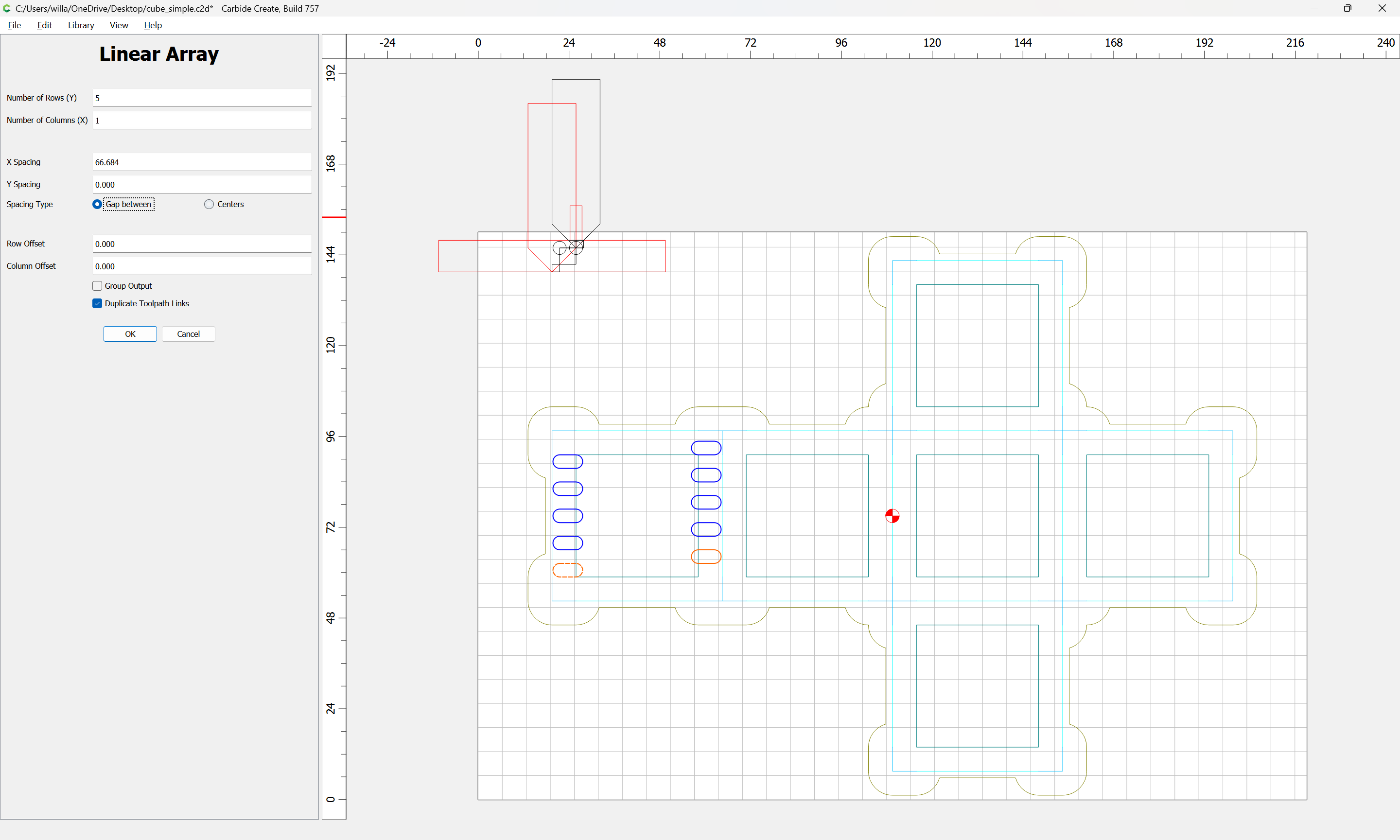

Then draw in a pair of circles to determine the width:
Assign the dimensions and and set the Corners to Fillet and the radius to half of the Height:
Drag it into alignment with the inset:
Then align it with the circles:
Duplicate it and drag it into alignment on the other side:
Duplicate again and drag into alignment with the previous copy:
Delete the previous copy and select both:
Then use the Linear Array command to duplicate:
OK
Delete the extra rectangle:
Then repeat along the other axis:

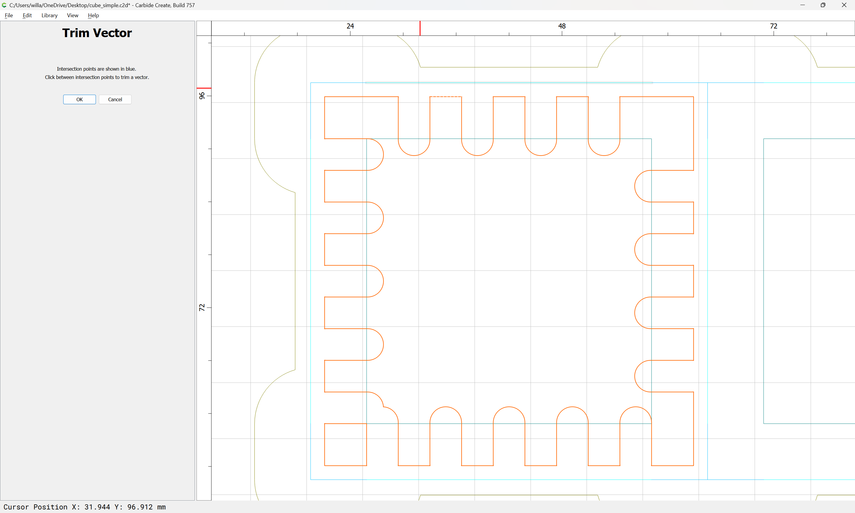

Draw a rectangle for the part:
Subtract the diameter of the small V endmill from both dimensions:
Select the rectangles and the inset part and use Trim Vectors:
to remove the outer geometry:
OK
then use Join Vectors to close things:
Duplicate and arrange as necessary so that the joinery will line up:
