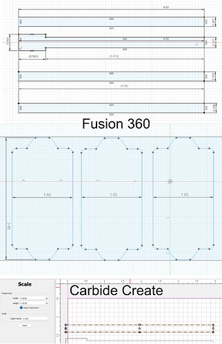

Hello,
I’ve got an issue that’s making my brain hurt. I’ve been using the 5 pro for over a year now, love the machine. Lately we’ve moved from CC to Fusion 360 due to some of the more complex geometries of guitar modeling and carving. I’m starting to get some pretty drastic inconsistencies in cuts - mostly pockets, and the inconsistencies are such that I can’t quite figure out if it’s machine related, software related, a tool issue, or something else.
I decided to run a test, using my main two end mills for the more precision bits of the carving (generally speaking, these are pockets and contours for pickup cavities, neck pockets, and truss rod/carbon rods in the neck)
The drawings I use for generating the sketches all originated in Illustrator, exported as .dxf, and conformed in CC and Fusion. Everything checks out in the sketches down to the thou.
BUT - my pockets in Fusion are distinctly smaller, enough that it’s a problem. I know I could sort out the gap and fix via some negative stock-to-leave, but this seems like a really clunky way to have to deal with the issue. Especially since (as you’ll see below), CC doesn’t have this issue.
In Fusion, I’m using the Carbide 3d Shapeoko 5 Pro post processor (carbide3d 02052026.cps).

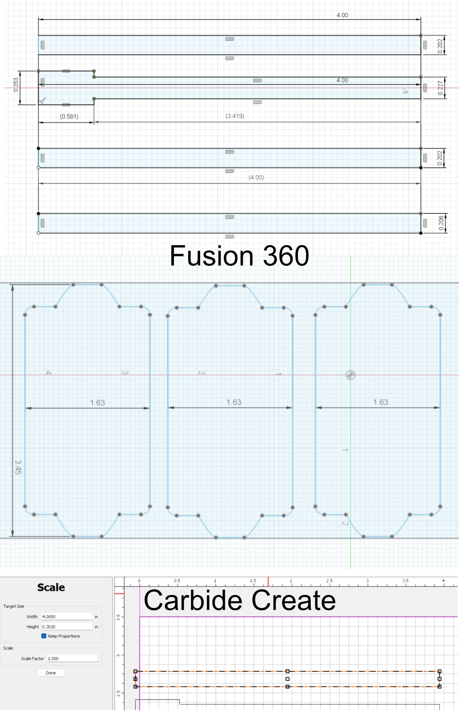

Here are some screen captures of the sketches being used with expected dimensions. The carbon and truss rods are top-to-bottom, all milled with 1/8" endmill:
1st and 2nd: 2d pocket, machined to the sketch (both top carbon and truss rod below it)
3rd position: 2d pocket with .020 stock left, followed by a finishing contour (with ‘repeat finish pass’ checked)
4th postion: machined to sketch, but this one is 0.206" instead of the original 0.202"
The three pickups are:
Left: 2d pocket with .020 stock left, milled with 1/4" endmill, then a 2d contour finish pass with 1/8" endmill
Middle: 2d contour only, 1/8" endmill
Right: 2d pocket, 1/4" endmill only
and here are the results.
I know there can be some tolerance issues with any machine, and a few thou is totally acceptable (especially since we’re working with wood), but this can’t be where I should set my expectations.
I have done all the maintenance I can think of on the 5 Pro - oil and checking the mechanicals. I’m at the point where I’m pretty sure this is something I’m missing in my Fusion setup. I’ve checked, I’m not leaving any stock on the pockets (unless I’m doing it on purpose to follow up with a contour finishing pass).
I’m attaching my Fusion and CC files here as well. I’m still relatively new to Fusion, maybe 3 or 4 months of really serious diving into it, but I understand the basics enough that I’m pretty sure I’m cutting pockets right. :slight_smile: I could very easily be missing something glaring that’s causing my 2D pockets to be undersized. If so, I would be thrilled to find out what setting I’ve neglected.
Thanks in advance!
Truss and Carbon slot troubleshooting.c2d (96 KB)
Truss and Carbon slot troubleshooting - Fusion360.zip (675.4 KB)

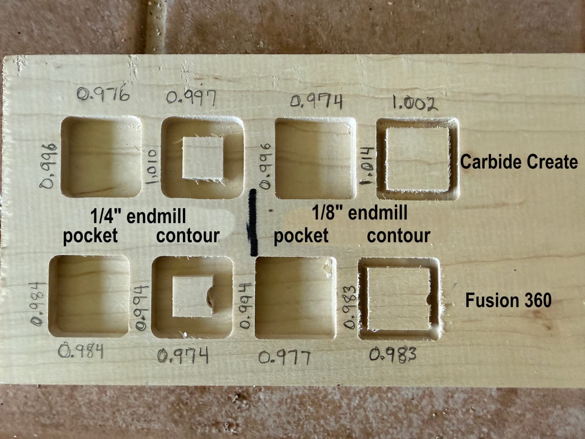

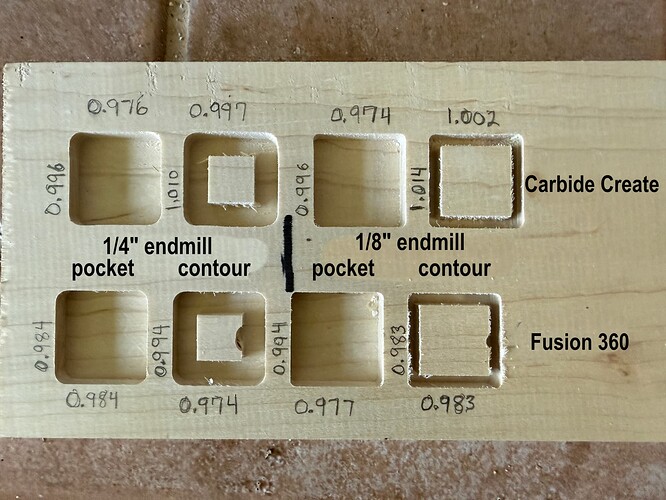

So here’s the 1"x1" test, pockets and contours, 1/4" and 1/8" endmills, Carbide Create and Fusion 360.
Not really sure what to glean from this. Attached are the files. Note - the tool name differences are simply because I built a new tool library in Fusion and organized things differently. The endmills used making this are the same for both versions.
I’ve included the .nc file from Fusion in case that’s of any help.

The default tolerance in Fusion is 0.004" which shouldn’t lead to this end result.
I have only been using Fusion or OnShape with my Shapeoko, so I don’t know much about what Carbide Create (with or without the Pro) is capable of feature-wise.
What’s telling here is that the contours have more variation than the pockets. Contouring like this is going to have the cutter at 100% engagement and puts a lot of stress on the tool, spindle, and stepper motors and can lead to losing steps in some cases. I don’t have access to Carbide Create Pro, so I don’t know if Carbide Create attempts a gradual acceleration here, but g-code generated by Fusion will rely on the machine to accelerate at the right rate. An actual ramp (helical or otherwise) is a better option since it will gradually lower the cutter into the material while also moving on the XY plane until the tool is at the cut depth you specified, then the cutting will begin. The end result is that there is less of the end mill engaged in the work piece, leading to less force on all of the equipment, and, in the case of open loop systems, less chance of dropping steps.
With a plunge ramping strategy, it’s possible to miss steps when using open loop steppers like the ones on the the Shapeoko. It’s odd that this doesn’t happen when you generate via Carbide Create, but maybe Carbide Create handles acceleration in software after a plunge, or you’re using Carbide Create Pro and it has more options.

The nc files I looked at in ncview for the 1/4 end mills have corner points .75 inches away from each other, so the data is good.
The material looks like pine, which will not clean up very well.
Try a hard wood or aluminum.

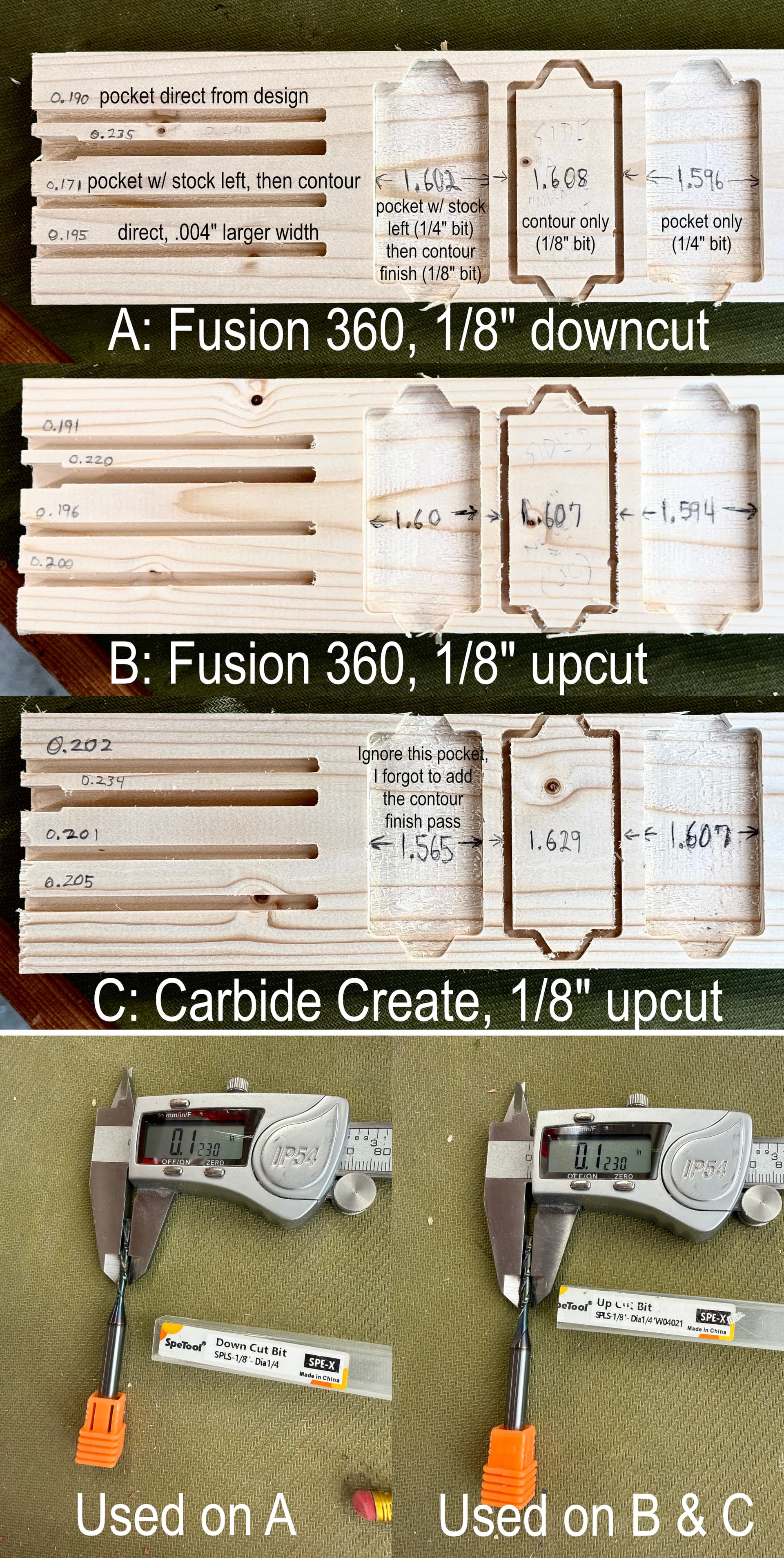

Ok, I bought a brand-new pair of 1/4" and 1/8" upcut bits and spent the entire day re-building my tool library from scratch, importing data from the manufacturer whenever possible (trying to eliminate any screwy data from my own brain). What caused that thought is when I tried to run another test a couple days ago, what should have come up as “tool 101, 1/8” upcut endmill" in Carbide Motion showed “tool 101, 1/8” ball nose". I figured there must be some weirdness in CM reading my old library from Create. Since I’ve been meaning to really think through my Fusion tool library anyways, I bit the bullet and spent all day making it right, then manually rebuilding a new Create tool library .csv, so in theory, both libraries are identical.
Well, after all that and hiding my old library from Create it still called tool 101 “1/8” ball nose" so I have no clue where CM is pulling that info.
Anyways. Here’s what I got. Still seeing the same couple-hundredths of an inch problem on the X axis, and a few thou on the Y. I did multiple finishing passes on all operations (except maybe that first pocket) to hopefully account for any deflection. Material is hard maple, I don’t have any aluminum on-hand at the moment.
I didn’t do a Carbide Create pass this time, might do it tomorrow, but I feel like I’ve eliminated every variable I can and it’s still off. I’m really hoping this isn’t something I’m going to have to live with and figure out how to adjust X-axis cuts differently than Y-axis cuts, that seems hellish. The baffling part is still that CC pretty much nails the sizes, at least in the previous test. Will do this one in CC when I have some time.
Attached is the new Fusion file, and here’s a pic of the results.
6-pocket test, new tools.zip (215.4 KB)

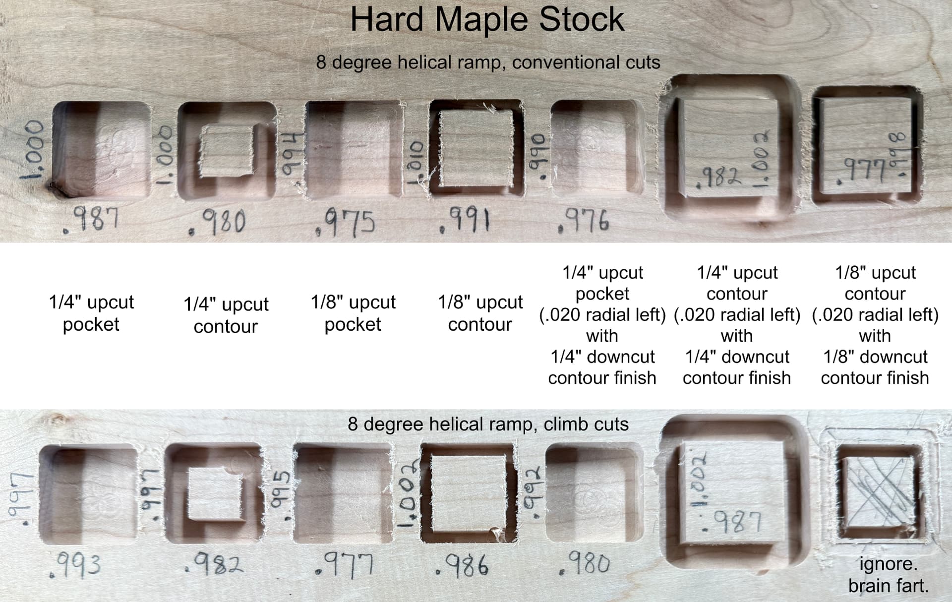

TL;DR - I think that this is not a Fusion post processor issue: the g-code is correct. There is a tool path issue in Fusion that’s leading to the machine losing steps.
What do I think is happening?
This is what I think is happening:
  • Both Carbide Create and Fusion are generating valid g-code, but they do it in different ways.
  • CC is likely controlling machine acceleration to reduce strain on the machine. (Or you have CC Pro and it does something to the tool paths that I can’t see in regular CC.)
  • Fusion’s g-code puts a lot of stress on the machine and it’s losing steps.
  • Because of this, the g-code from CC produces the accurate cut you’re looking for.
Why do I think this?
  • As @jtclose pointed out: the g-code in NC files from Fusion is correct. The coordinates point to Fusion’s post-processor doing everything correctly.
  • Fusion’s default entry to a cut is a plunge. I do not know why, but it is.
  • Plunge entry into a cut puts a huge amount of stress on all aspects of the machine, from cutter to steppers and everything in between.
  • When the machine can’t push past the resistance of the material, you are losing steps. (This is better than some of the alternatives like throwing the part or snapping the end mill.)
Questions:
  • In the Fusion tool paths, you’ve still got ramping set to “Plunge”. Is there a reason to keep that?
  • What is powering the end mills? Router? 65mm spindle? 80mm spindle?
How do we fix it?
Using some kind of “proper” ramping.
In Fusion, double click on a tool path, then click over to the Linking tab (last tab on the right), head down to the “Ramp” section, make sure “Ramp” is enabled, and then set the Ramp Type to Helix and Ramping Angle to 8.
Why helix? It’s slowly spirals into the material before beginning the actual cut. There’s very little strain placed on the tool and you can avoid situations where you could lose steps or snap the cutter.
Why 8 degrees? The default of 2 is too low for wood, you’ll be ramping forever. 8 is a good start to tune to your work and your machine.
Making this permanent
If you hover your mouse just to the right of the input box, you’ll be surprised by three dots. Once you’re happy with a ramping strategy, you can click the three vertical dots and select “Save as User Default” and then you’ll only have to remember this when you need a tool path to be different. Do the same for the Ramping Angle.

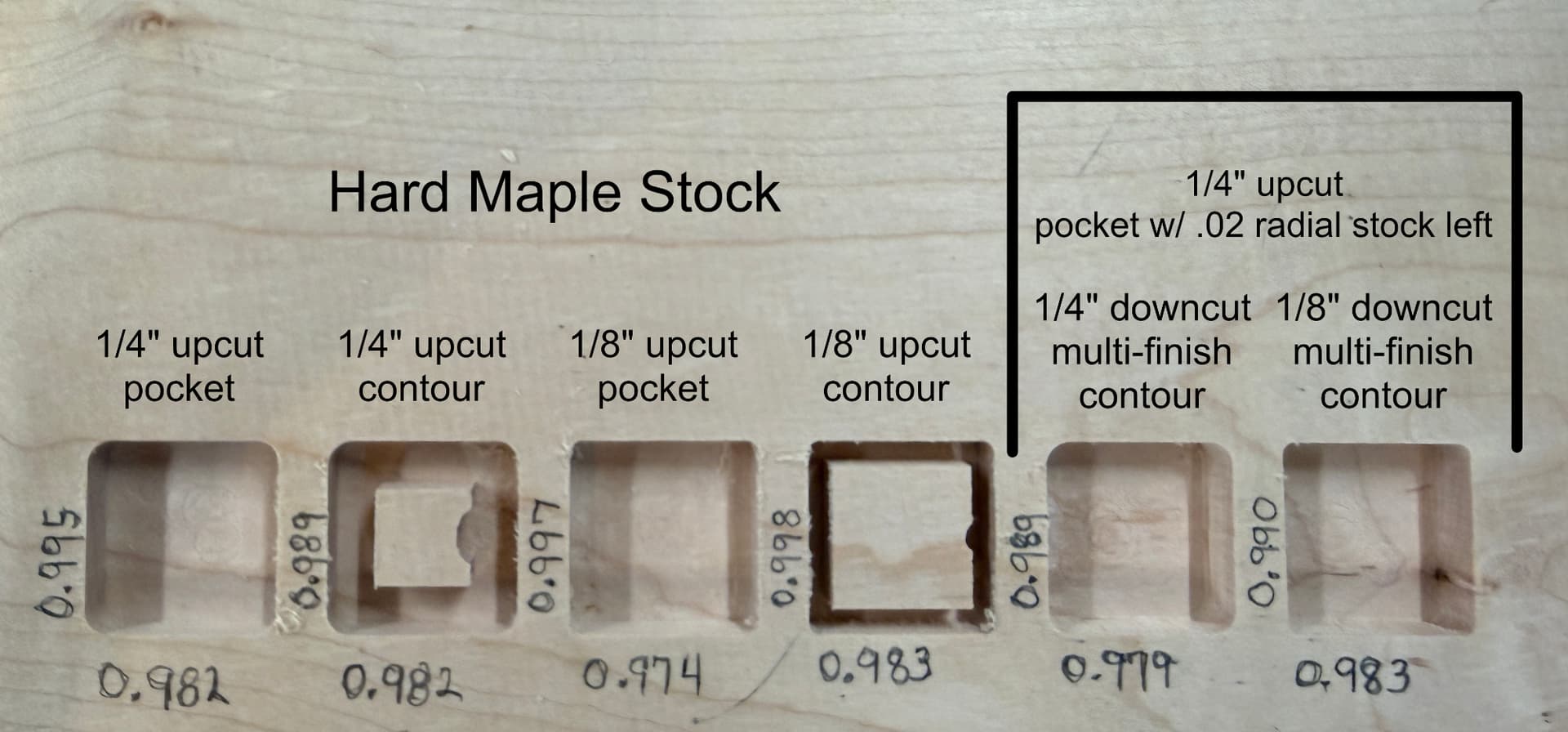

I’ve worked up another version of the test project doing ramps on everything as well as adding an outside contour operation to see what can be learned from that.

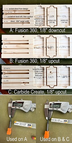

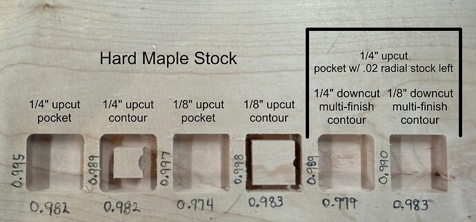

Ok, latest test. It’s becoming clear to me that I’m losing steps on the X axis, that seems pretty consistent across everything I’ve done (including a couple observations on actual projects over the past few weeks). Problem is, I don’t really know what to do about that. I feel like I’ve done all the maintenance-ish things you’re supposed to.
This time around, I did the ramping, which seemed to help a little. I did these with the default ‘left’ aka ‘climb’ setting. (bottom of image)
Then I did another one where I changed two things (top of image) - first was changing to ‘right’ aka ‘conventional’, but also after seeing those ‘bites’ the bit takes out of contours upon ending the cut I selected ‘perpendicular’ on leads and transitions, I wasn’t happy with the sound it would make when jumping out of the end of the cut, that felt like a broken bit waiting to happen. Will read more about this.
