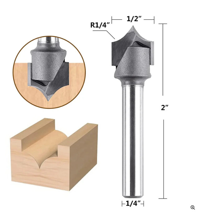

Anybody know how to add this tool in the database? This is a SpeTool CA W09001 Carbide Tipped Round Over 1/4" Radius x 1/2" Cutting Diameter x 1/4" Shank x 2" Overall Length 2 Flute Router Bit

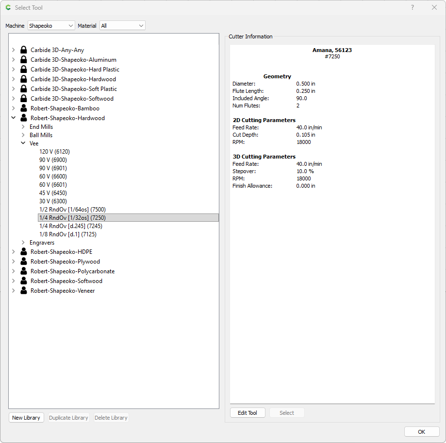

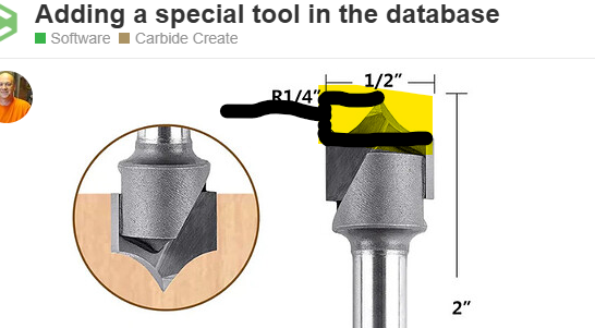

You can add the tool to your tool database pretty easily, the issue will be that it will not render in the model properly.
You’ll have to remember the tool number and its parameter, ie DOC.
I would add this tool a V-bit and in the notes keep the DOC max so you don’t go too deep with it. Measure the distance from the point to the shoulder and thats you max DOC.

After watching the video from CIC Workshop, not all round over bits are made the same. The difference is the depth of the cut, some flatten the point a little due to the high chance of breakage. The recommendation was to use your calipers and measure the depth. The CIC one I linked above is ground to a depth of .177 which is why the DOC in the spread sheet from them was set for .175.

Spetool has a database you can download. As others noted I would watch the CIC video on the round-over bits
I decided to define round-over bits in CC as a V-Bits, which enables the preview to show me as realistic as possible.
