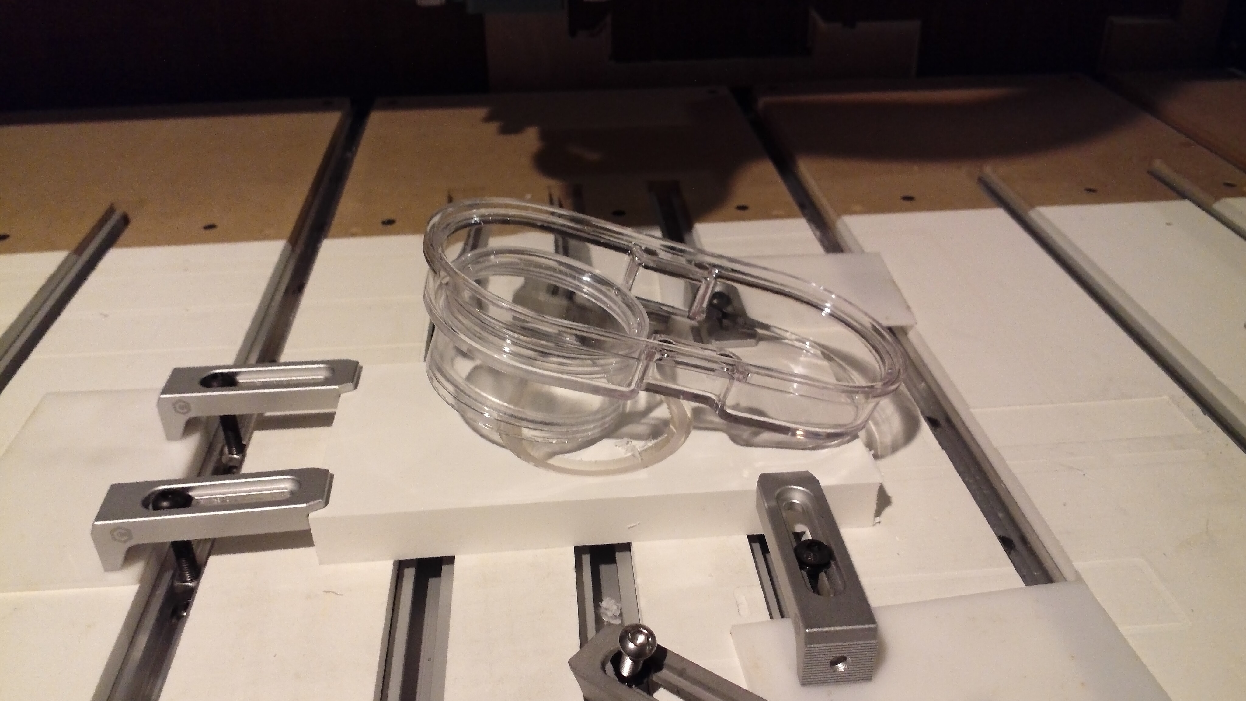

  • cut the Winston (the Sweepy bottom w/o brushes which is wholly transparent for better videos) up so that it will fit the now open lid and allow a bottom screwed in from underneath to secure
We start w/ a fixture to cut up the lid:
So we cut the fixture and secure the lid w/ a bit of double-sided tape:
trim the edge and test it, then cut out the inside:
We cut the bottom out by putting a base into the lid still in place in the fixture:
Success!
