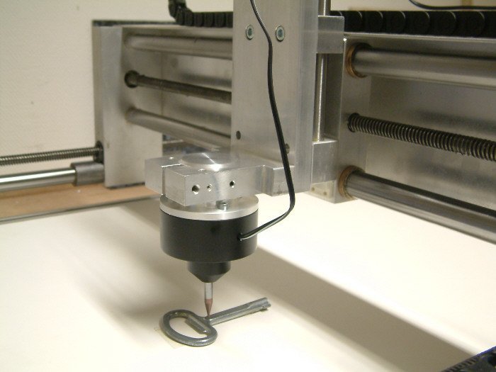

I will be purchasing a Shapeoko XXL CNC Router in June or July of this year
Application:
I would like to be able to sculpt a Bas relief Master pattern, the thicknesses could vary from 3/4 to 1/4 inches thick, overall size will vary, after I produce the Master Pattern I then need to digitize it.using the Shapeoko CNC Router which would be adapted with an aftermarket digitizer…From there I want to be able to take the digitized files that I create using the Shapeoko CNC Router of what I’ve sculpted in bas-relief and reproduce them in variety of sizes in wood or other materials…
Question: Does anybody have any experience using / adapting a Shapeoko to work with an aftermarket digitizer ?

I’ve heard a little about photogrammetry, in which multiple photographs are taken around an object, then software creates a point cloud representation of the object. That can then be imported into 3D modeling software to give you a (potentially) very accurate digital 3D representation of your original object. Might be worth looking into as an alternative to physical probing?
The community has collected a couple of links on physical probes: https://www.shapeoko.com/wiki/index.php/Upgrade_Overview#Touch_.2F_digitizer_Probe

Here’s what happened …I asked Carbide 3D about a digitzing probe… they told me that Grbl g-code-parser does not support a digitizing probe and suggested scanning via third party… which is unfortunate because I think a Digitizing probe is logical offering /extension by way of features and options… I am a sculptor / model maker and would make good use of this if it were available… So from what I can gather I am out of luck unless somebody out there has a work around…To me a digitizing probe is essential to maximizing this great system…
I was also asking Carbide 3D for an auto zero option which is in development and not available… to assist Carbide 3D was kind enough to point me to http://triquetra-cnc.com/ for the zero plate option which is compatible with the Shapeoko, I am planning to purchase their auto zero touch plate called the Triquetra P3 ……I am hoping on an off chance that Triquetra will eventually develop a digitizer since they are offering the Auto Zero Touch Plate… I also asked them for some input on a digitizer probe and I am waiting for a response…
So in short there are plenty of digitizers out there … what I need is a work around with respect to the Grbl g-code-parser … comparatively, 3D scanners are expensive… so is getting it as a service. … As I also pointed out to Tito this issue came up in the forum in 2013… https://www.shapeoko.com/forum/viewtopic.php?f=4&t=2144 I wish / hope that this would again get some traction in this forum …
Thanks for responding …
Grbl / G-code support for G38 says it is supported: https://shapeoko.com/wiki/index.php/G-Code

Meg in support sent me over here to add whatever clarity I can.
GRBL G38
GRBL does support G38. (And if my memory is correct we submitted the patch to add it to GRBL right before the Nomad shipped)
Carbide Motion supports G38 as well
Auto Zero Probe
We’re finishing up the design for our “auto-zero” probe right now (we’ve cut about a dozen versions in the last week) and we just ordered material to make the first batch.
Once that’s in production, we’ll add additional M codes to Carbide Motion to handle the zeroing in a single command. We actually have most of the code in CM right now, we just need to tweak it for the final probe design.
Touch probes with Carbide Motion
You could hack a touch probe onto a Shapeoko but you’d need software to probe along a grid, or some other pattern, and then record a point cloud. Then you need to convert it to an STL to create a new toolpath. The hardware and firmware in the Shapeoko would handle this but Carbide Motion doesn’t.
Someone else could write this software but, at this point, I don’t think it would be us.
We own a commercial laser scanner and we’ve spent a lot of time with it. Based on experience, the use cases for 3D scanning are pretty limited, and it’s way less useful than many would expect. Your use case is perfect for 3D scanning but most other cases are not.
Supporting scanning in Carbide Motion would likely be setting us up for a huge support problem unless we were very careful in constraining the problem.
This post is not meant to try and talk you out of anything, just to layout what the hardware, firmware, and software capabilities are and what our point-of-view is on the whole topic.

I did check this out … It requires a conductive surface …Might work if I can find a way to metalize the surface of the sculpting polymer that I work with …
Worth poking at…
Thanks
The Estlcam contour mapping is intended to let you project an existing CAM project onto the “probed” contoured surface, and as I understand it you’re wanting to probe a handmade carving, and then replicate at scale and volume.
I don’t know of a way to export the contour results using this Estlcam feature into a usable map, model or file, but the notion of this operation intrigues me. There might be a way to save the contour results, but I’m not certain as I have yet to use this in any project (yet).
