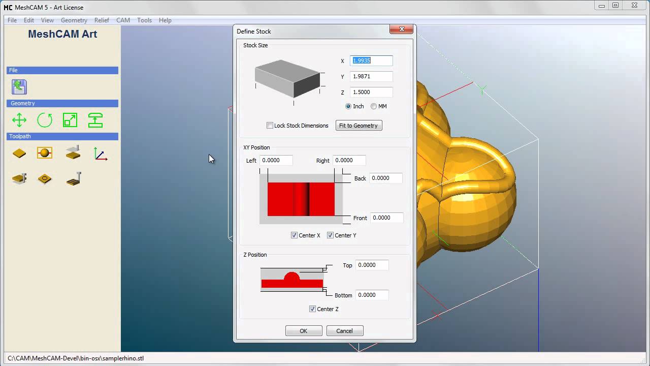

You are aware of Meshcam? If not: http://www.grzsoftware.com/ Best thing since sliced bread or perhaps cheese. It’s great value, and once you own a license - there is no risk of some nasty corporation changing the rules on you later on!
