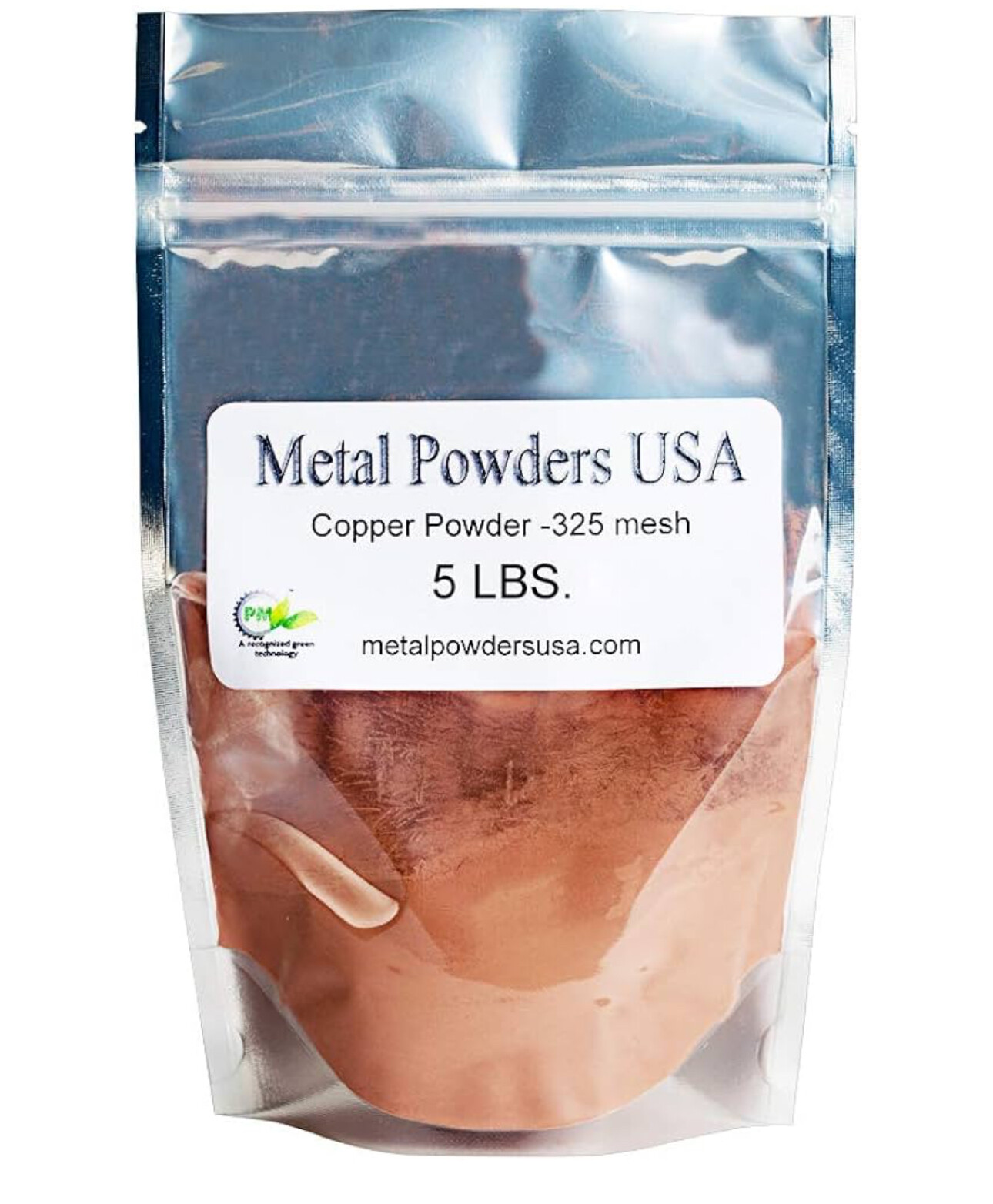

I’ve had some great results with different metal powders and inlaying them with a shallow depth pocket design.
They sell different kinds of fine powder, like copper, stainless steal, aluminum, and bronze. Each have a distinct color and when you use a thin CA glue and sanded flat, it turns out to be a very durable and clean inlay in whatever design you choose.
There are a ton of company’s that make them for pen makers. I’m cheap so I get bags off off amazon from here:
https://www.amazon.com/s?k=Metalpowdersusa&ref=bl_dp_s_mw_0
