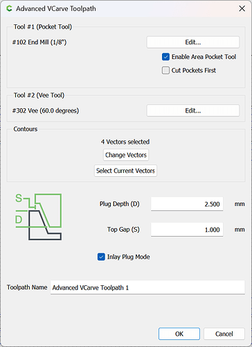

I would recommend making your inlay plug depth about 0.5mm less than the depth of your Advanced V-Carved pocket. That difference in depth is going to be your glue gap. You can probably go smaller with testing, but that’s a safe place to start.
I would also recommend a Top Gap of about 1mm. This is going to be your margin if your pocket is a tad oversized (which it will be if your V-bit doesn’t come to a perfect point), and your plug needs to drop into the pocket a smidgen more.
So “Top Gap” is the same as the old “Bottom Gap”, and “Plug Depth” is the same as the old (Max Depth - Bottom Gap)??
A typical Inlay will consist of a Female (No Inlay Mode) and a Male using the new parameters.
The vector for the male will be traced at the Plug Depth, and will still honor depth of cut from the tool.
Are there any other changes to the toolpath?
Correct
The toolpath is different than what we did in prior versions. The inlay will fit and it more closely follows the method that people have been using for V-carve inlays for years.

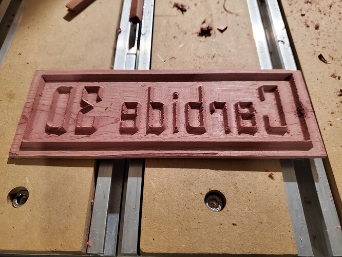

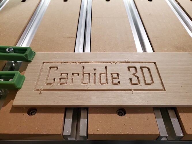

It’s pretty straight-forward — I’m re-creating a slightly modified version of my first inlay:
only with the added inset to make things clearer:
inlay example_v777.c2d (72 KB)
which uses the geometry:
and toolpath settings:
and for the inlay it is:
inlay example — mirrored inlay_v777_6_35_center.c2d (96 KB)
Cutting is going well:
(note that I switched off “Cut Pockets First” above)
Next up is cleaning up the two parts and then the glueup — hopefully it will go as well as the first version.
