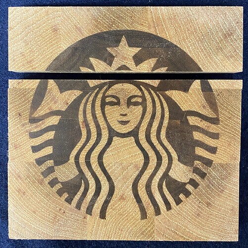

I finally got around to testing the new inlay update discussed in this thread:
Long story short - It worked absolutely great the first time.
I shamelessly used the same familiar barista for my test, inlaying end-grain walnut into end-grain hickory:
I used a new 30° Vee Bit (with a .005" tip) and the “Plug Depth” and “Top Gap” recommendations from @wmoy.
My pocket depth was .25". The recommendation is to make the plug depth .5mm (.02") less than the pocket depth, so my plug depth is .25" - .02" = .23".
For the Top Gap, the recommendation is to use 1mm (.04")
The pocket in Hickory:
The plug in Walnut:
Before gluing, the top gap is ~1.5mm:
After gluing under significant clamping pressure, the final top gap is ~1mm:
Then I cut the poor girl in half to get a cross section:
The “glue gap” is ~.008".
I think the keys to success are:
  1. Use the recommended settings for Plug Depth and Top Gap
  2. Use perfectly flat stock
  3. Use a Vee bit with a sharp (not broken) tip
  4. Use a BitZero and BitSetter to “nail” your Z and eliminate job setup errors
  5. Clean up the fuzzies so they don’t interfere
  6. Clamp the heck out of it
  7. Don’t forget to mirror your plug!
Now on to some inlayed endgrain cutting boards…

That’s a great writeup, Steve; thanks for the pics.
My favorite part of the Starbuck test is to see how even the tiny nose element comes out. On our test, it was very small and it was perfect.
Looking forward to the cutting boards photos.

Here’s another test. Same Top Gap as before (1mm; .04"), but this time with a plug depth .03" less than the pocket depth. So in this case the plug depth is .25" - .03" = .22". Inlay came out perfect again. Here’s some cross sections:
The resulting bottom/glue gap is ~.022". Because I’m dialing this in for a cutting board, I think this bottom gap is too big. I think these gaps would result in a hollow sound in the finished product when tapping on a bigger inlay. I want it to sound and feel solid.
I’ll stick with my original settings: Top Gap = 1mm (.04") and Plug Depth .5mm (.02") less than the pocket depth. [Exactly what @wmoy has previously suggested :wink:].
