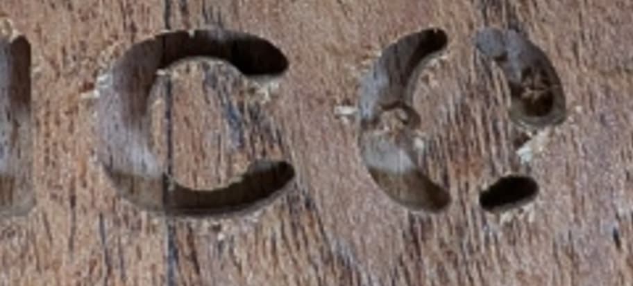

So my inlay with the CC v777 did not turn out too good. Could the community take a good look at my files and advise on how I might improve. I need this plaque by August 10, 2024 so I have plenty of time to redo it. The female pocket was walnut and some of the letters like “e” had parts tear out and that is some of the problem. However around some of the letters there is space so help me improve this or change to get a better result. The inlay was maple.

Here is the female pocket close up.
Here is the inlay close up.

the corners look pretty rounded, is the end of the v bit damaged?
Did you use inlay plug mode? This is what I see when I open your male plug file.
I find that increasing the font spacing a bit looks a little better. Maybe try somewhere around 110%.
I agree with the print spacing. On the female side a lot of the internal structures chipped away like any of the “e” and “i”. So maybe a different font and more kerning (Spacing).

Maybe the walnut for the base is too soft to hold the font well. I may change to another material for the base. I just want to make contrasting base and lettering.
The male inlay was maple, likely hard maple, and that came out well. The walnut half not as good. I might try some mesquite and maple???

So I redesigned the project with a bigger material, bigger letters and cut the female pocket. The lettering came out very good in the mesquite. I had put two coats of Zinsser Universal Sealer (dewaxed shellac) on to harden up the wood. The pocket was cut first in the advanced vcarve and then the vee bit cut second. The letters came out great. In the previous version I used walnut and the lettering was smaller and a lot of the letters chipped out like the inside of the e. So I thought I was making progress.
So after 3.5 hours the cutting was done but unfortunately the bottom of all the letters have a ledge at the bottom. Not sure what happened. I have been using this machine for a long time and know how to use it. Somewhere along the way between the pocket and vee cut something changed.
This picture is blown up and shows the little ledge at the bottom.
Here is the project after the pocket was cut and before the vee bit started.
So the ledge was formed during the vee part of the advanced vcarving.

Does the ledge really matter? Is it within the gap such that the plug would never hit it? It’s hard to tell from the pictures.

So I don’t see anything wrong in the toolpath settings themselves. However, since I don’t have your 15 degree tool in my library I can’t check to see if maybe the included angle or something was wrong or if there’s a ball nose or other geometry quirk. My suggestion for a small scale test would be to try it with a 302, or other 60 degree V-bit first.
If your 15 degree bit has a ball nose larger than say 0.1-0.2mm, that’s going to throw things off. Create would expect the bottom of the cutter to produce a sharp line, whereas in reality the cutter following an imaginary toolpath would produce a significantly wider cut than expected. That would make your pocket bigger. Not sure if that would also cause the lip you see. And because of the steeper angle, there needs to be more “axial margin” if a plug is going to drop deeper into the pocket to fill the gaps around the perimeter.
Anyhow, TLDR, try it with the 60 degree V-bit first. So far that has seemed to produce universal success. You don’t need the skinniest cutter possible to produce crisp, accurate results. That’s the beauty of V-carving, and a fatter V-bit can be pushed harder, saving you time. Later you can try to see where/how the process for your 15 degree cutter differs. Maybe to make the 15 degree work, your female pocket would need to be much deeper. And your Top Gap would need to be as well, to allow the plug to drop in more if need be.
