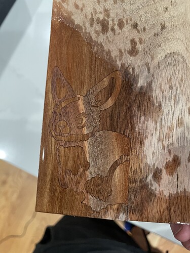

Whelp, I tired a different tool path strategy had another almost identical failure/result. This time on the smallest animal (the wallaby)…
What I’m experiencing is the halves go together reasonably well with just the weight of me pressing down. But once I’m toward the bottom of the pocket the force of god standing his big toe couldnt force it down…
I think this failure is down to using two very different materials. Walnut (face grain) and MDF. I’m going to try trying exact same tool path strategy using walnut and walnut for female and male sides and see if I have the same issue.
If that fails whelp… I’m not sure maybe time to do some diamond circle square tests and hunt for accuracy that way.
I had better results using the same material for both sides, but it still took quite a bit of hammering to get the male side to seat down… and it actually split the wood in the process (face grain-face grain)
I’m going to simplify the wallaby and try again.
I also think end-grain to end-grain will eliminate some of these issues but there’s no way for me to test that without… “doing it live”
Success… I think. I really don’t want to cut this little guy in half and find out how far off I am…
