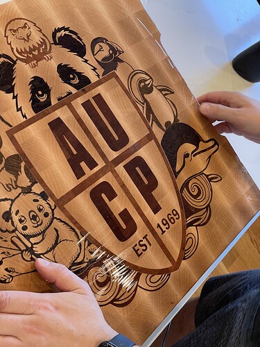

Ambitious V Inlay Attempt
Sigh. About .0625" from the bottom when it should be ~.01-.02. Not sure what to blame at this point. Gonna turn in for the night.

I finally had a better result… the difference for me was decreasing my start and flat depth from .27 and .01 to .22 and .01 on .20 deep negative pocket.
Conclusion there is just TOO much bit deflection on a very tiny and detailed inlay using a very tiny tapered ball nose to make a plunge of .28" work. If the features were less detailed you could probably make it work. But not in something the size of this wallaby/rabbit.
Things should only get better from here going into end grain. So I’m ready to do it live.
Holy moly the resolution difference of doing this in endgrain (vs face-grain for all of my test pieces) is like watching HD tv for the first time.

And if you’ve made it this far here’s the money shot!
Lots of lesson were learned, but overall not the most difficult thing to do if your machine is tuned up well.
re: my previous conclusions on deeper inlays and tool deflection. While I think that’s a part of the difficulty; I now think the larger issue is vectors which terminate in points rather than arcs. Aka you need to spend ALOT of time redrawing a complicated vector so that it only arcs vice points. And further the termination of that arch needs to be comfortably larger than your bit diameter (.5mm in my case).

Auction was last night… let’s just say you can’t put a price on the learning experience.
The leaves looked great until final surfacing, at that point I lost about 5 thousands between high and low spots on the board and the leaves were just inlayed too shallow in their narrowest parts.
